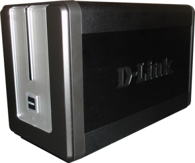

IIRC, on most of these NAS devices, the USB port is for a printer only, they cannot be plugged directly into a computer by USB. I couldn't find any info at DLink to indicate that it could be.
