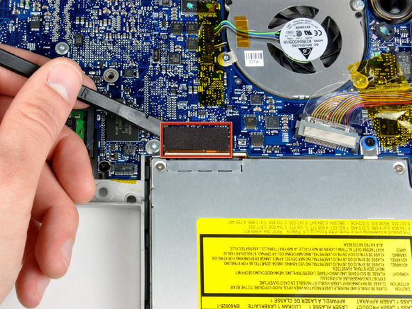

Have you taken you MBP apart to look at the connecting cable that goes from the DVD drive to the logic board?
I've never worked on one like your model so I'm not sure it is a cable or direct plug in.
I've taken my MBP apart a few times but never checked the cable. According to IFixit its a ribbon:
"Use the flat end of a spudger to disconnect the orange SuperDrive ribbon cable from the logic board, removing tape as necessary."
rsdI116WAljDKWAf.medium
You shouldn't have any problem then. As far as the PATA bus not allowing the 7200RPM drive to work at TOP speed I don't think you have anything to worry about.
