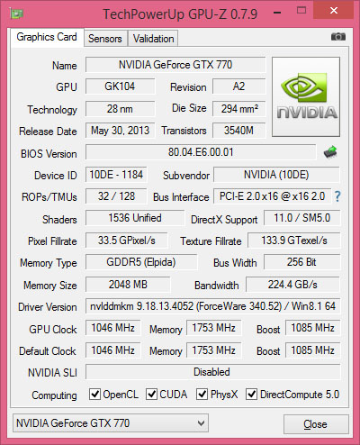

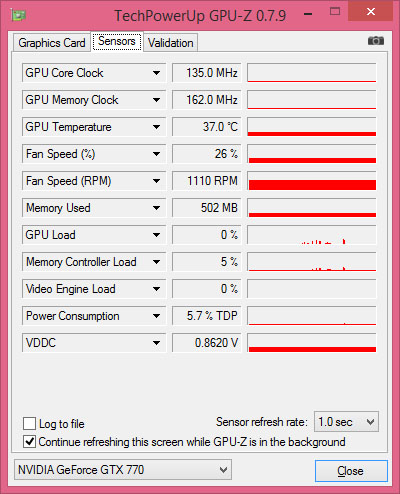

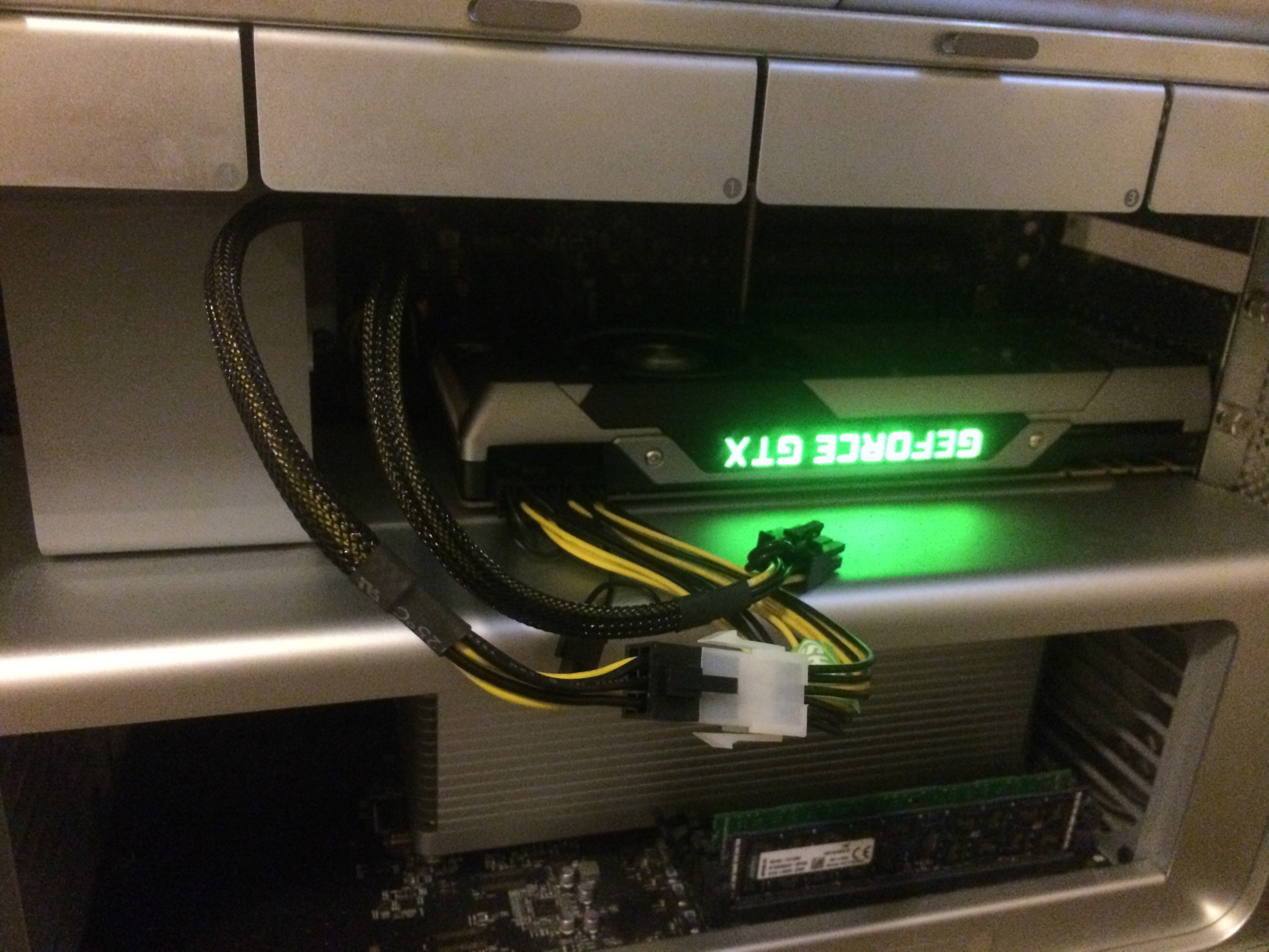

I just did a quick test, and everything seems to be fine. I purchased a Y Cable PIC 6 PIN(M) to 2x PICE 8(6+2) PIN (F) and then pluged it into the 6 PIN connector. It booted up fine without any problem. I'm a newbie, so please tell me if i'm missing something. Thanks

Yes, it will boot. However, when you stress your machine, your cards will demand the current that double (or may be more) of each 6 pin cable's design limit. That may eventually burn your motherboard if you use this config for a prolong period of time.

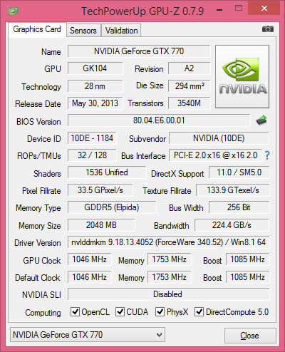

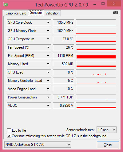

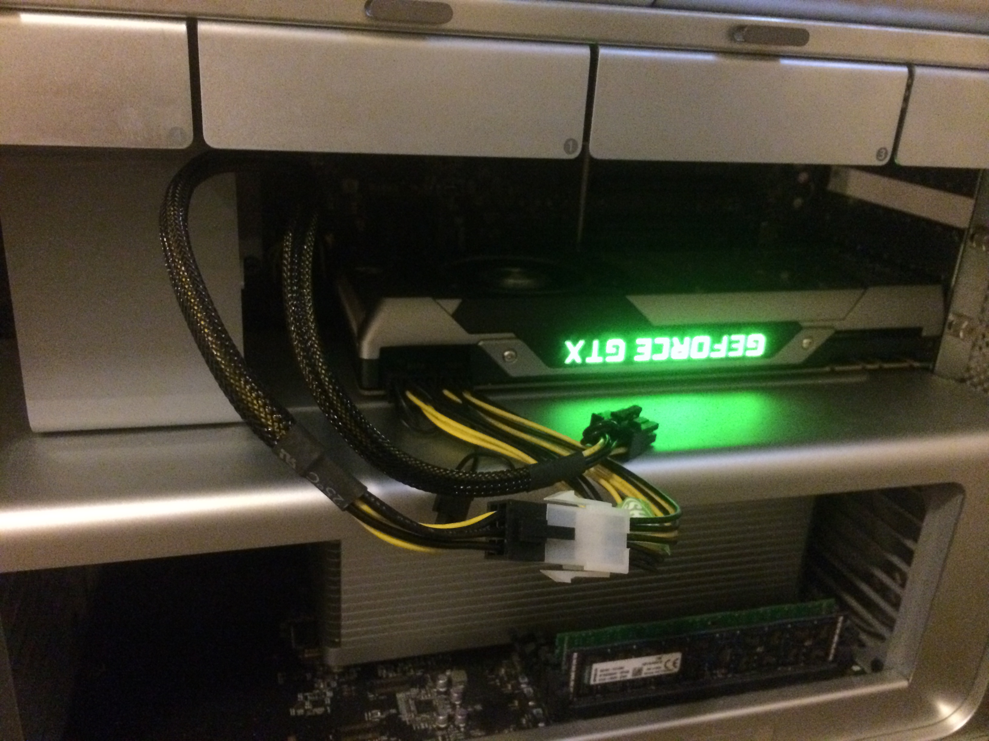

did you try FurMark Stress?
Running 1 single card should be perfectly safe. A Gtx 570 uses more power then a 770 and you can safly run a 570 off of stock power. Least that's been the general rule with 570s for as long as i can remember (I have run one for years in multiple mac pros, 1,1/3,1 and now my new 5,1.)
770 vs 570: http://gpuboss.com/gpus/GeForce-GTX-770-vs-GeForce-GTX-570
"Significantly more energy-efficient load power consumption 246W vs 360W" 246watt max load being the 770.
Dual cards you will have no way around needing an aux power supply.
