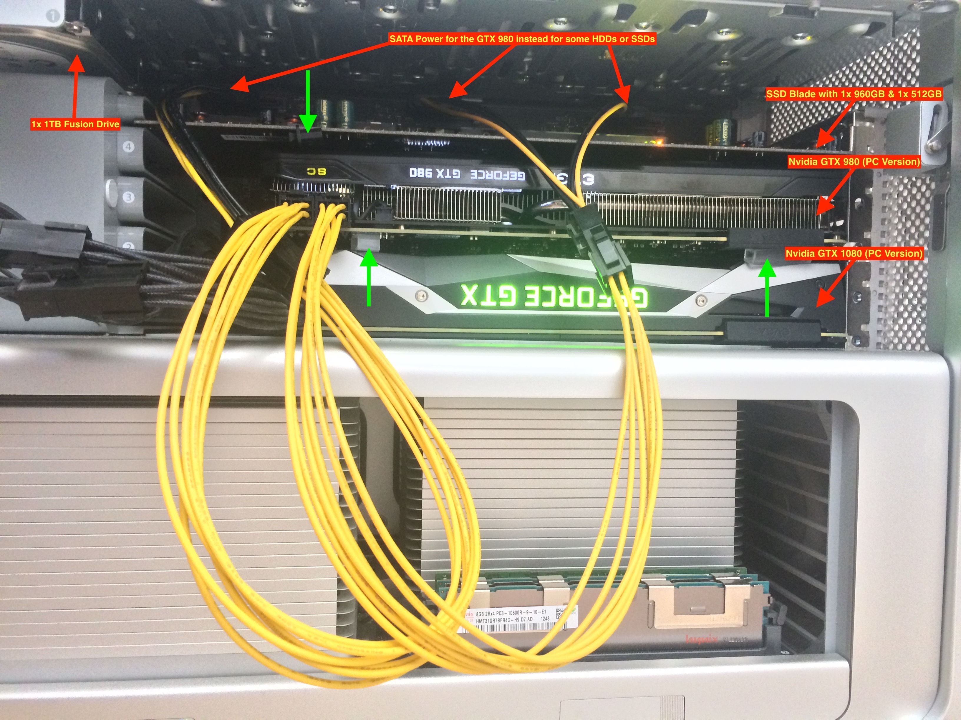

I decided to go with the SATA Power version, that "h9826790" suggested: to use 3 SATA bays to pull power from. And it worked quite well so far 🙂 !
I actually don't need the bays, because I run a SSD Blade with 1x 960GB and 1x 512GB as my working drives and am quite satisfied.
I also did this, because it was the easiest way for me to run this card without sorting and rearranging some power cables (like the Pixels mod). Cost me also only my old card (GTX 980) and around €18 for the cables.

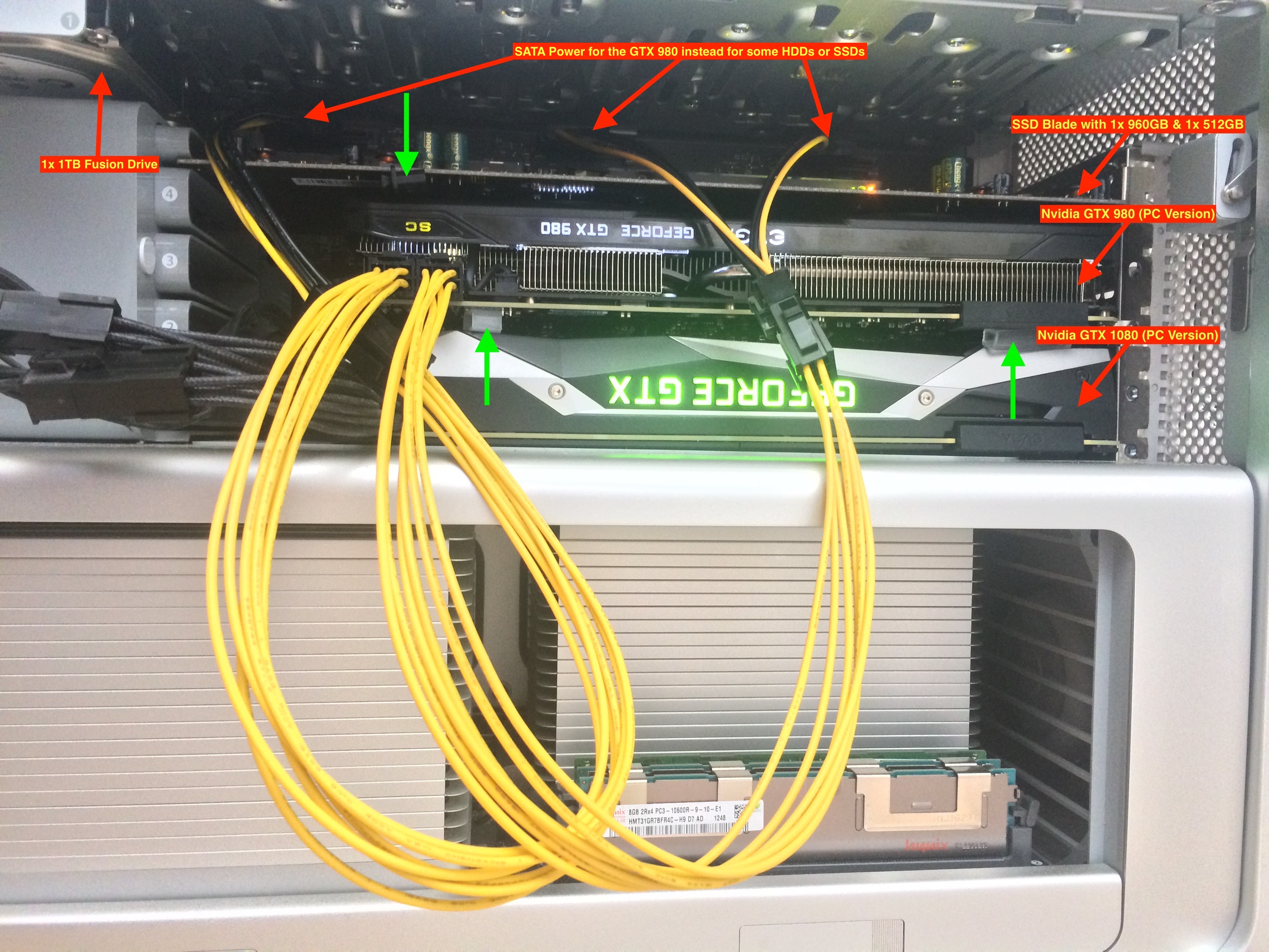

I upload some pics, so that you can see how it looks like.
As you can see, the two graphic cards are pretty close to each other and also to the SSD Blade.
I put some little plastic things between them (green arrows) to keep some distance for air supply:

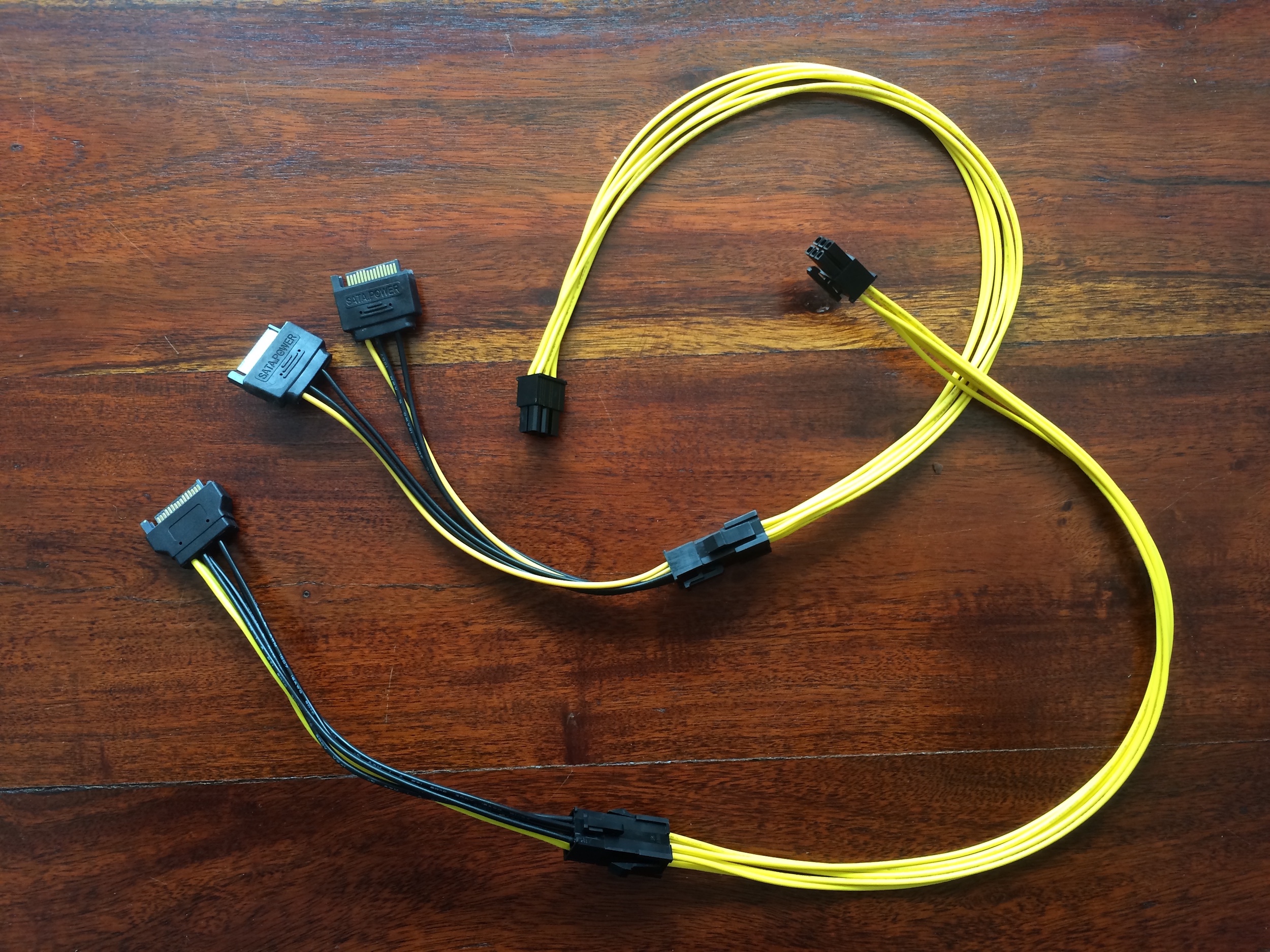

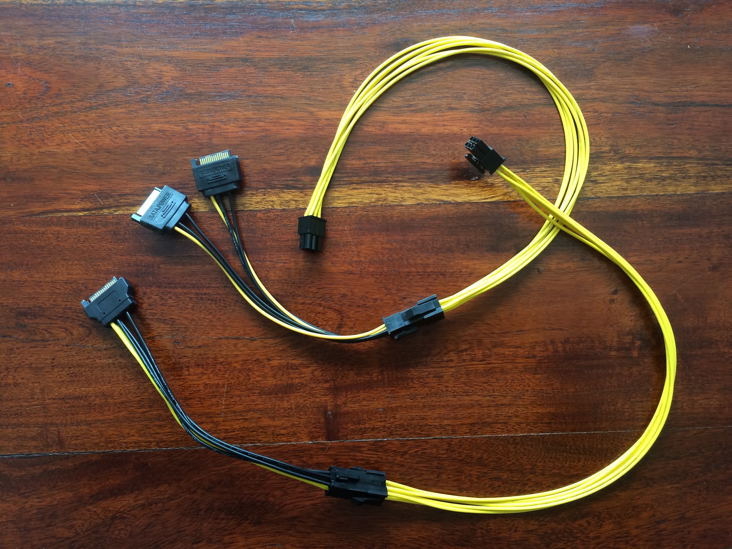

Here are the cables:
1x PCIe Power Cabel SATA 15pin to PCI Express 6pin with extension (6pin mal to 6pin female)
1x PCIe Power Cabel SATA 2x 15pin to PCI Express 6pin with extension (6pin mal to 6pin female)

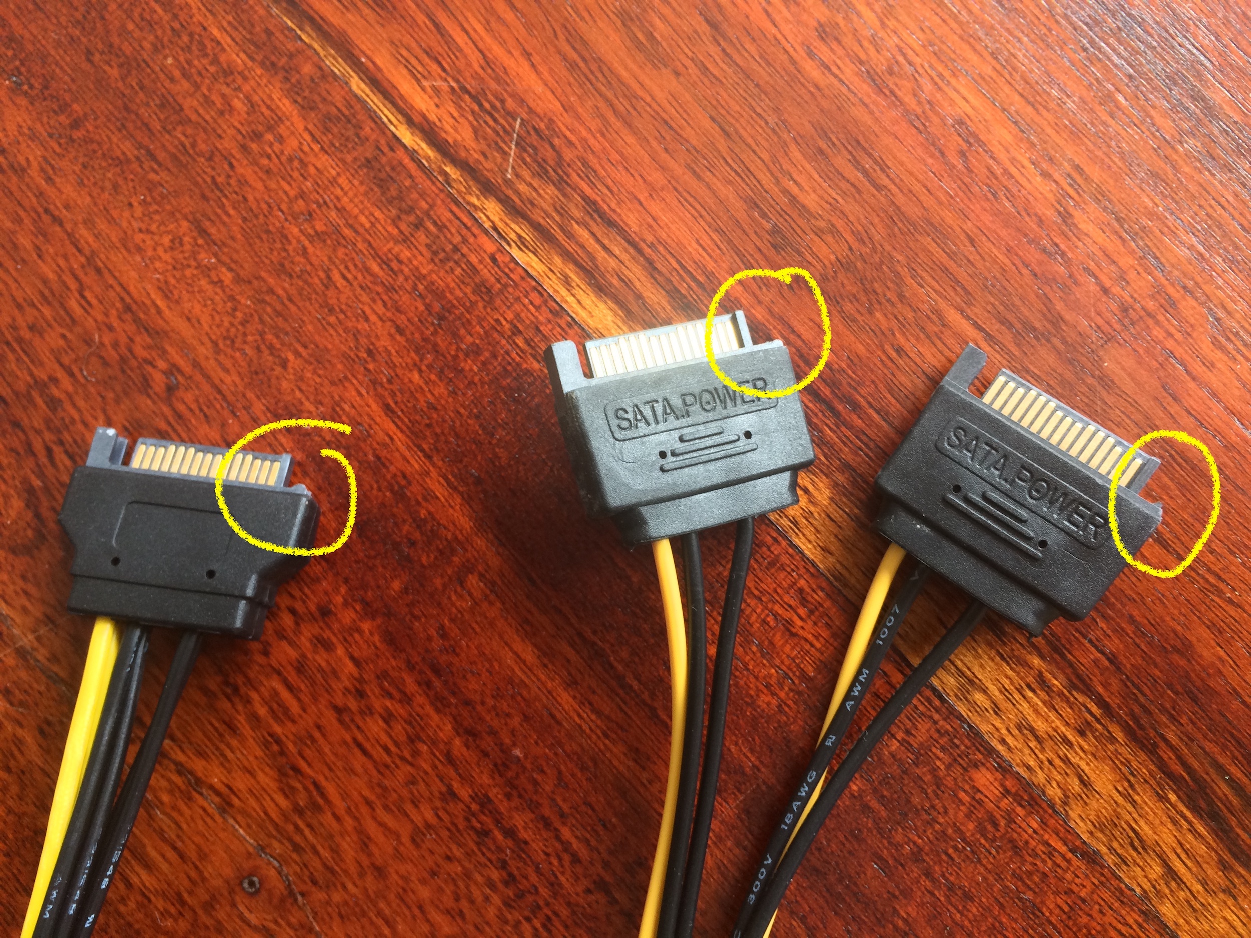

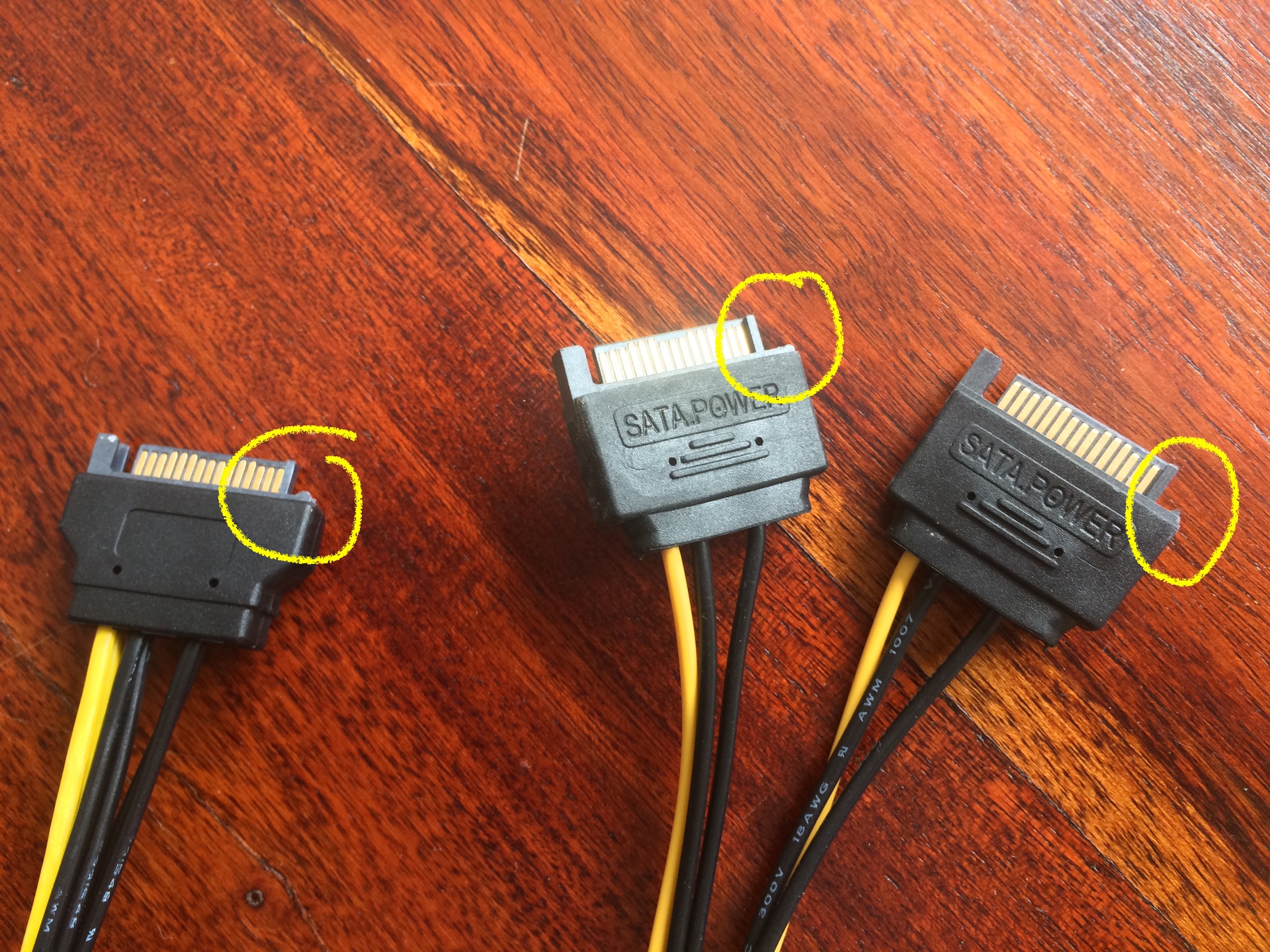

I had to adjust the holding to get them fit into my Mac Pro:

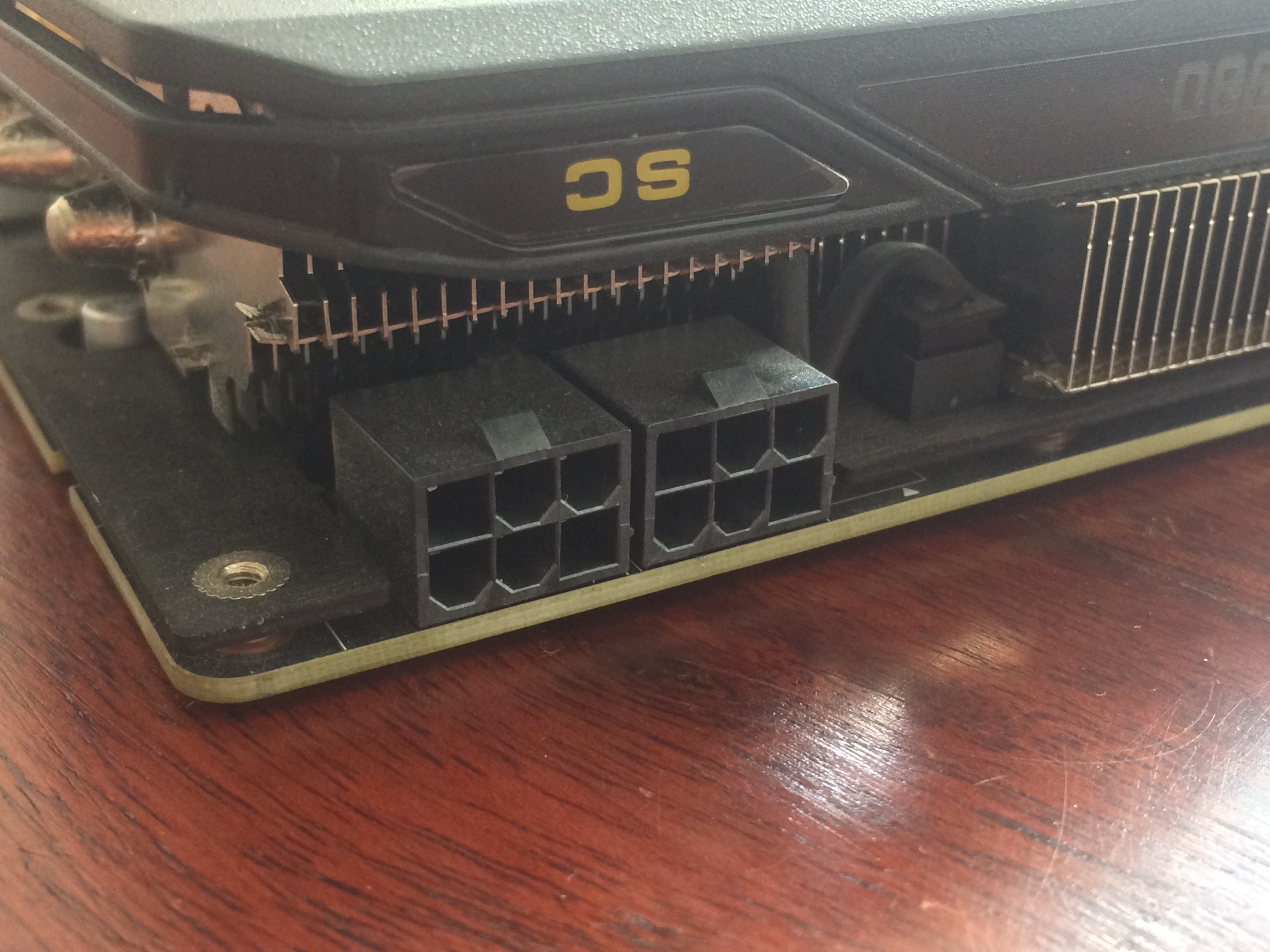

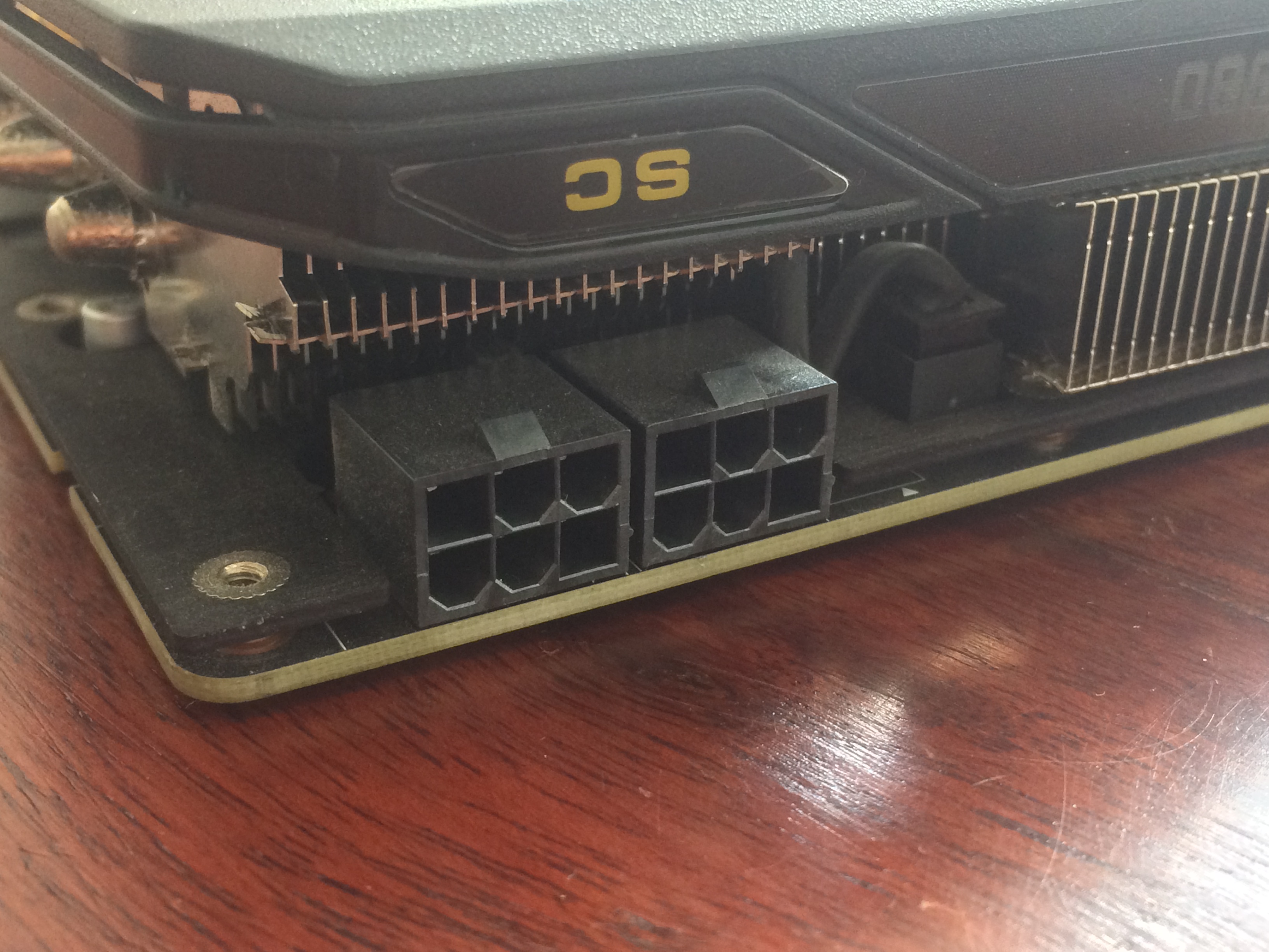

This is the GTX 980 (PC version) with is 2x 6 pin connectors:

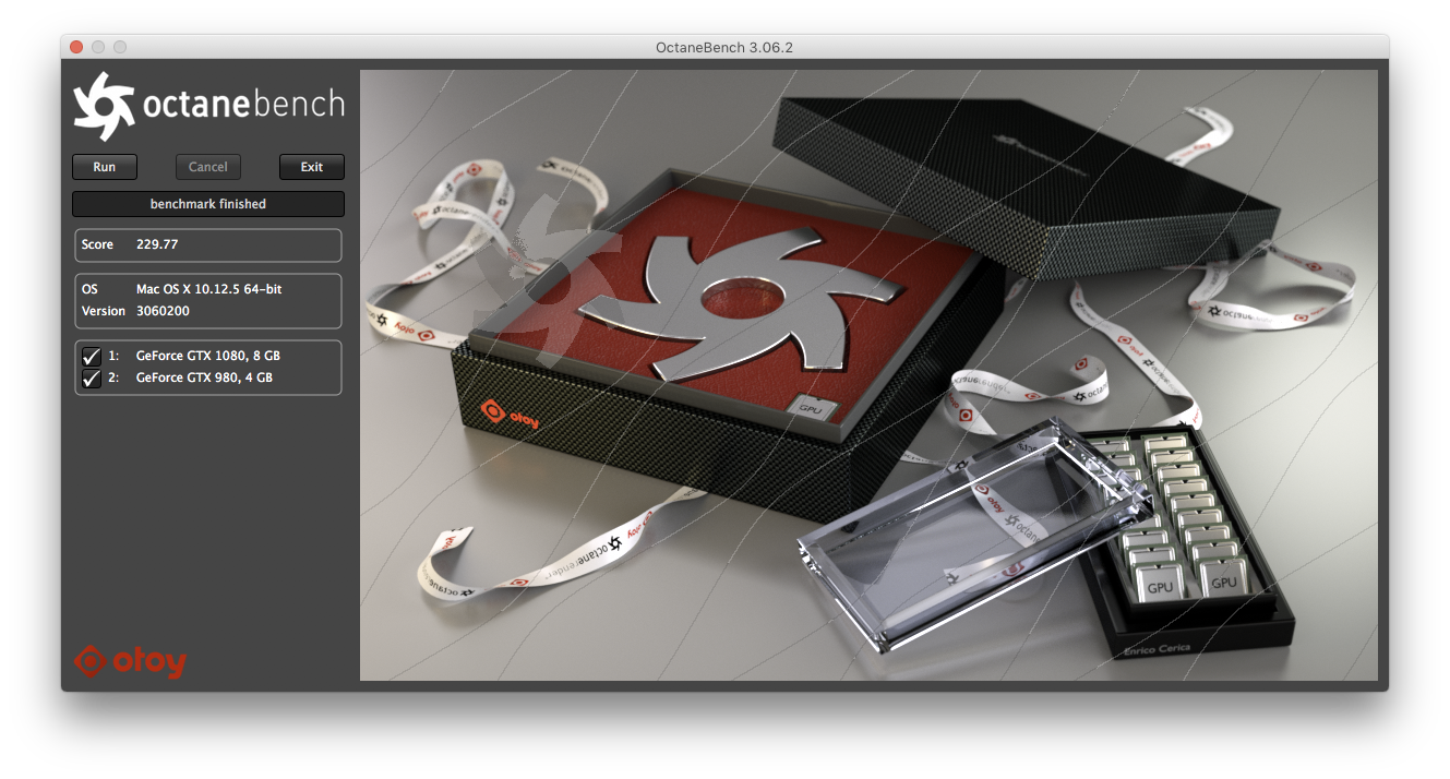

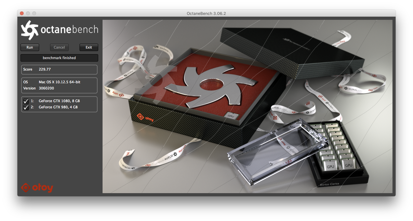

And here's the first Octane Benchmark:
I have to say, that under full throttle the cards get "quite" warm/hot...
Is that ok ? Do I not get into trouble with overheating or maybe damaging the SSD Blade ?

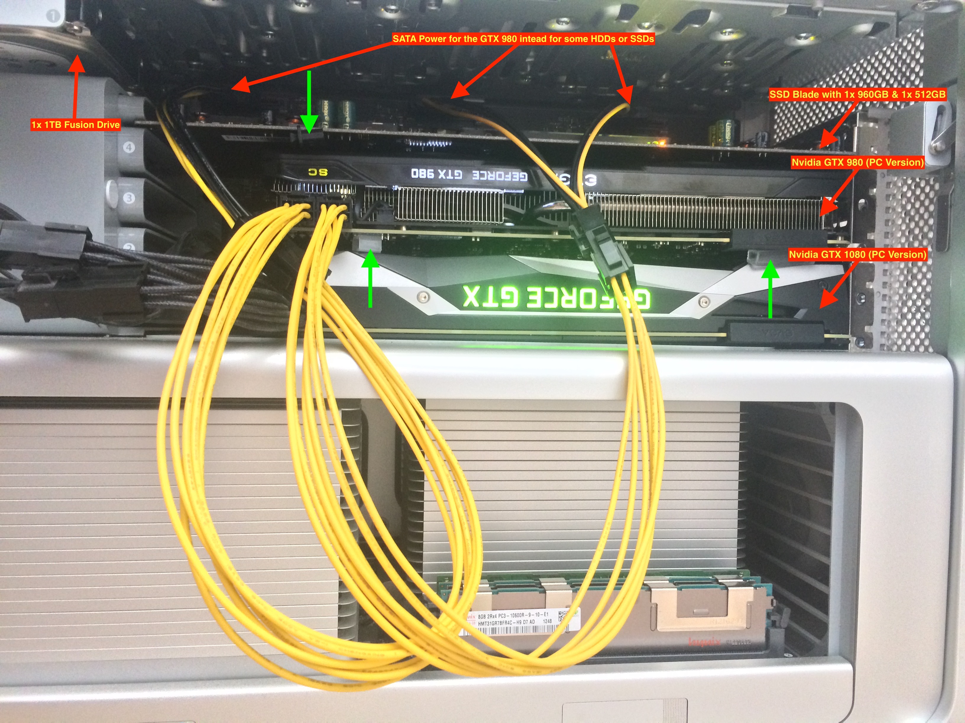

Ok, so here I am again 🙂

Thanks for your sharing. I won't worry too much about overheating. Both GPUs and PCIe SSD has very reliable thermal throttling. If getting too hot, performance will be degraded, but should not damage anything.

So, you sure ?
I was touching the 980 during the bench test and it got quite hot on my fingertip.
Also, it smells "warm electronic" out of my Mac, that I guess should be normal, if there are two cards full running...?
They will throttle safely if needed. I've been beating mine up with hash cat. Depending on the algorithm they can be made to throttle, but on NTLM, MD5 they just run and run full tilt for weeks (nMP and cMP).
You're welcome.
So, you sure ?
Yes, they can safely run at >80 degree C (still run at full speed). And it's normal.
If your GPU running exceptionally hot (overheating), the GPU's fan (and PCIe fan) should spin up a lot, which easily catch your attention because of its noise.
