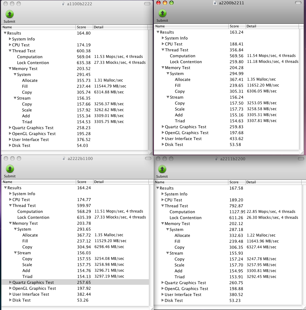

My first instinct was to do A: 2,2,1 B: 2,2,1 but I ready somewhere (can't find it now) that it would be faster as I've set it up...I'd like to see the results of A: 2,2,1,1 B: 2,2 as a comparison...can't find on barefeats...
I tried it with 4 different configurations and it really looked the same.... It is probably randomness in xbench that accounts for the slight differences. I left the config a2211b2200. These results mean anything to anyone?
No, definitely slower the way you set it up.
Two reasons:
1) You have defeated Quad channel access which requires the first 2 slots on each riser to be equally populated
2) The higher (3rd and 4th) slots have a higher latency because all accesses to them are mediated first through the first and second slot RAM, which has to evaluate the request and forward it.
You want to have the majority of your RAM in the first 2 slots so you spend as little time as possible accessing the 3rd and 4th slots.
Your configuration puts 40% of your RAM in the slow slots.... sorry 😱
