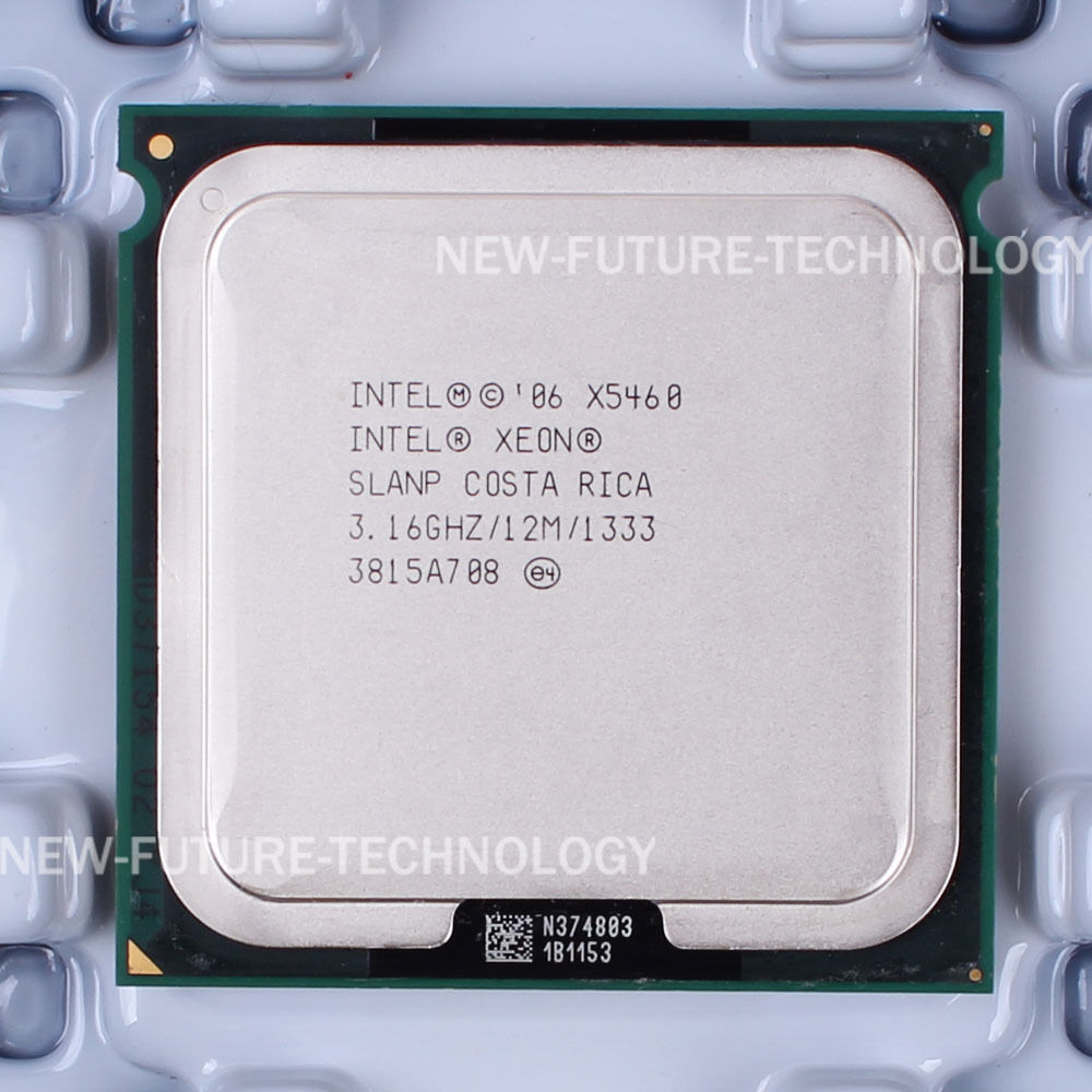

Interesting choice of processor , the X5460 .
It is limited to 667 MHz memory (can't do 800 ) .
It is a known good processor for the 3,1 .
I would advise obtaining a C0 stepping / SLANP S-Spec version , if you go this route . It should work, but I can't find anyone to verify that and I have not done it myself .
Any processor you choose for the 3,1 can use 667 MHz memory .

My thought process behind going with the X5460 is cheap RAM. It seems the 667 RAM is running at about half the cost of 800 RAM for just a 4% decrease in performance in this application.
My thoughts were that if going with a larger amount of memory, like 16/32MB, I would likely be purchasing the 667 ram anyways since it is such a small difference.
With the X5460 you get an extra .16GHZ processor and since they are both hypothetically running on 667 ram, the X5460 would theoretically be a better performing package I'm assuming(albeit negligible)
What's this "C0 stepping / SLANP S-Spec version" you mention? If that is added cost then it would make more sense to use the 3.0ghz instead, even with the 667 RAM.
Either way when you compare my current E5462 with even the 3.2Ghz X5482 on CPUboss.com, the site declares "no clear winner. Too close to call" With only a .2 higher single core score, and a .1 higher score on the X5482 running all cores.
It would seem by far the most cost effective upgrade would be to simply add a second 2.8ghz as some have already pointed out.(although some also pointed out that I probably won't notice a difference even adding a second processor, so I'll probably hold off on that for now)
It's called compatibility 🙂
Not all stepping versions of chips are compatible with our Mac Pro workstations .
The information is printed on the Xeon chips as a S-Spec .

Ah, okay. Sounds overly complicated/risky considering how close it is in performance to the E5472 3.0Ghz...especially since they are identical in price.
I got the compatability info from here:
https://forums.macrumors.com/threads/mac-pro-cpu-compatibility-list.1954766/
But it could be inaccurate.

This series of Xeon chips have model designations with a letter preface (e.g. L , E , X) . These are TDP ratings , which is a rating of how much power (and heat) a chip is rated for in terms of Watts .
"L" chips are like those tiny underpowered French cars ; they get the job done but are too slow to escape the riots .
"E" chips are like normal powered cars ; ordinary .
"X" chips are the supercharged 12 cylinder racing trucks with big pick up beds . These I like ...
Now, you will always remember 😀

Aha, so even though the E5472 is slightly better performing than the X5472 according to this: http://cpuboss.com/cpus/Intel-Xeon-X5472-vs-Intel-Xeon-E5472
The X is actually "better" because it's rated for heavier use/higher heat?
I've added a stepping compatibility column for the 3,1. It should be good now.
However, the stepping is identified by the sSpec number on the top of the processor. If the CPU seller just uses a stock photo, or someone else's photo, or the same photo over and over again for different processors, it's possible that the photo he's using is not showing the sSpec number of the actual processor for sale. So it would be good to verify with the seller before you purchase.
