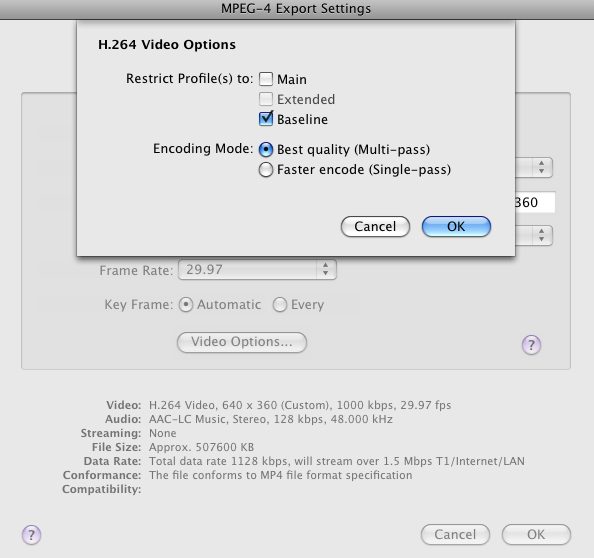

NOTE: Using Popcorn for multiple show encodes only allows for ONE setting so you need to gang all the HD recordings into one Popcorn 3 encode AppleTV Custom set @ 1000kbps, 2 pass Baseline 640x360 and do any SD encodes separately although I don't recommend you use Popcorn for SD.
NOTE: Popcorn won't let you access the Advanced Video settings if you use the iPod Custom path. So you have to use AppleTV and then change it for the iPod according to the above settings. These encodes are also completely AppleTV compatible.

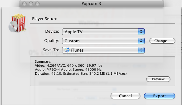

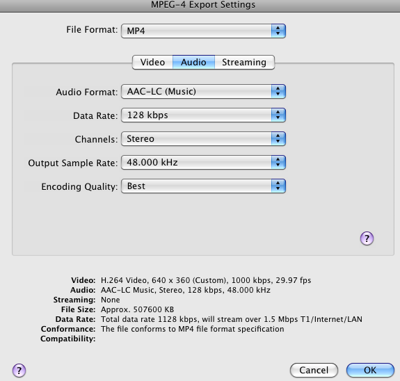

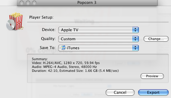

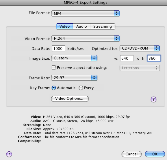

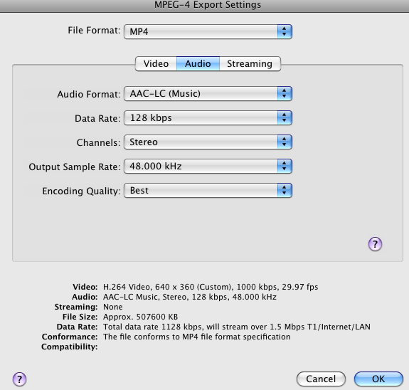

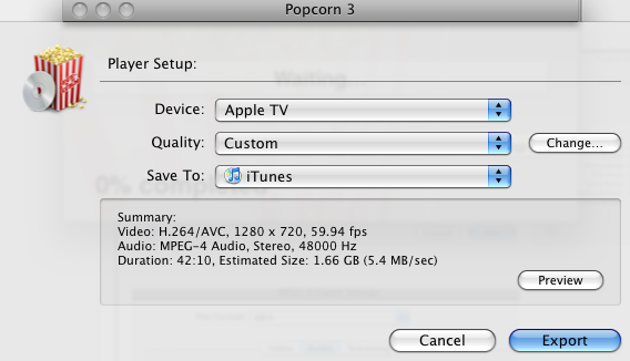

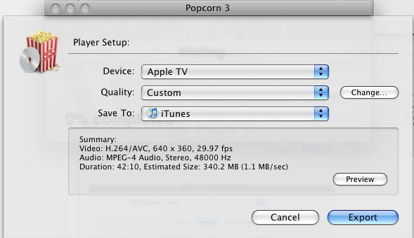

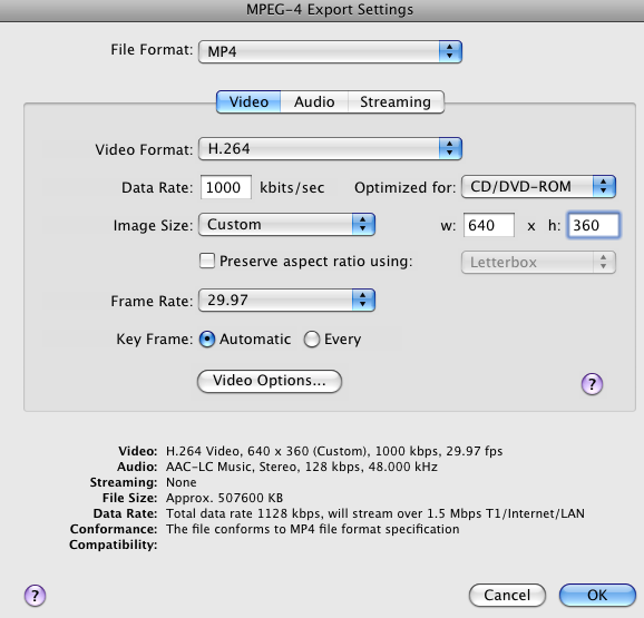

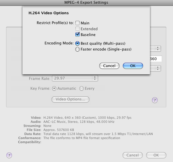

Screen Shots Of Popcorn 3 Settings
Here is the set of screen shots showing how to set your EyeTV Native HD recordings to mp4 encodes with Popcorn 3 that will play on all iPods as well as AppleTV. I am able to run 3 instances of Popcorn 3 simultaneously on the 3.2 GHz 8 core MP. Overnight I can encode about 10-15 shows at once this way up to about 6-8 hours in each copy of Popcorn 3. Each instance uses about 2 cores. The Multi-Pass encoder does 5 passes.
The last two shots are the before and after you customize the AppleTV presets to add iPod conformity and bit rate reduction for file size efficiency.
The results are spectacular @ 1000kbps. On the big HDTV screen the encodes look almost indistinguishable from the originals. At the same time they all fit economically on any video iPod and the iPhone.

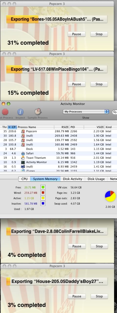

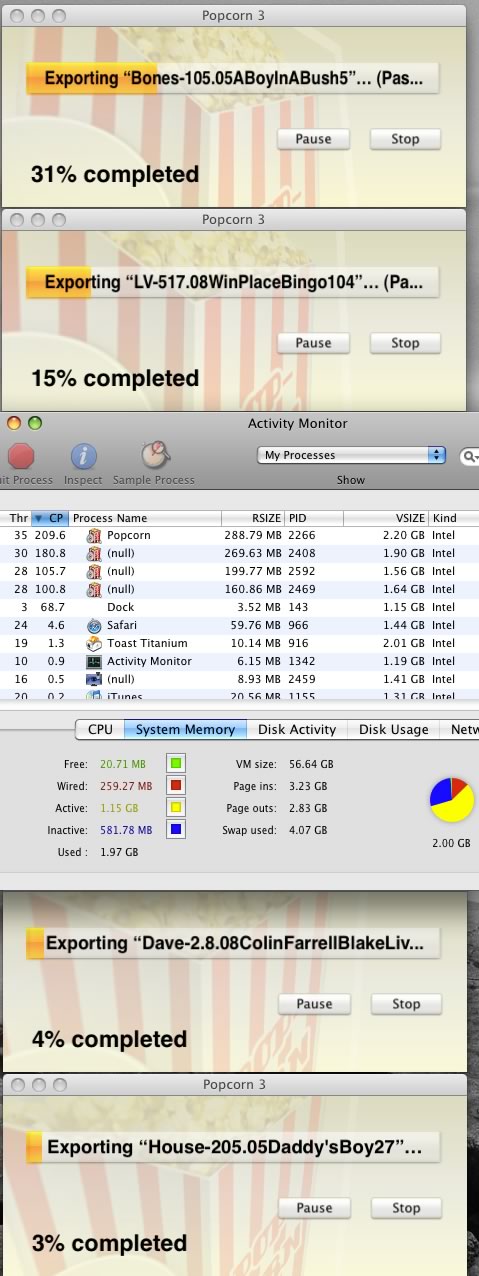

Image Of Four Instances Of Popcorn 3 Encoding Native HD EyeTV Recordings To mp4
Here's what the set of four copies of Popcorn 3 look like as they are crushing about 20 shows at once - including several movies - overnight. I put the Activity Monitor in the middle so you can see how many cores they are using each. Sometimes an instance will shoot up to as high as 2.5 cores but usually they are all under 2 cores and one is often under one core. But considering that all 4 are fighting for access to only 8 cores it's easy to see why we'll all be looking forward to 16 cores next year. 😀
NOTE: All these encodes are for HD only. I still find Toast+Handbrake the best way to encode SD 4x3 recordings due to the need for both cropping and deinterlacing among SD recordings. When not deinterlacing, Handbrake can do 2-pass encodes at over 250 fps on the 3.2 GHz 8 core MP using up to over 6 cores at once.
