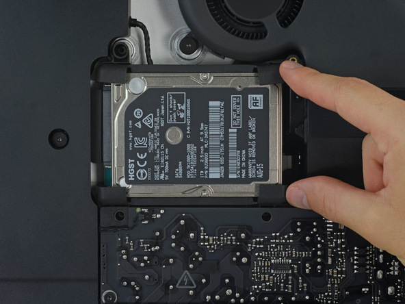

https://www.ifixit.com/Guide/iMac+Intel+21.5-Inch+Retina+4K+Display+(2017)+Hard+Drive+Replacement/92700

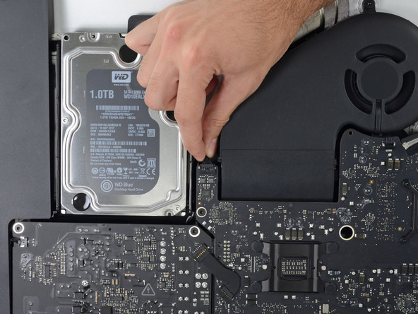

https://www.ifixit.com/Guide/iMac+Intel+27-Inch+Retina+5K+Display+Hard+Drive+Replacement/30522
1BHDNUCqqNJOMFJJ.medium
it does look like the two imacs use different hard disk sizes-- though, admittedly it's a been a long time since I've mucked about building a PC.
No, not on the same desktop 😀
21.5-inch iMac uses 2.5, unless you go back 4 or 5 years.
27-inch uses 3.5-inch.
Unless there is an SSD, which are blade-type SSDs - so neither 2.5 nor 3.5 if SSD only.
