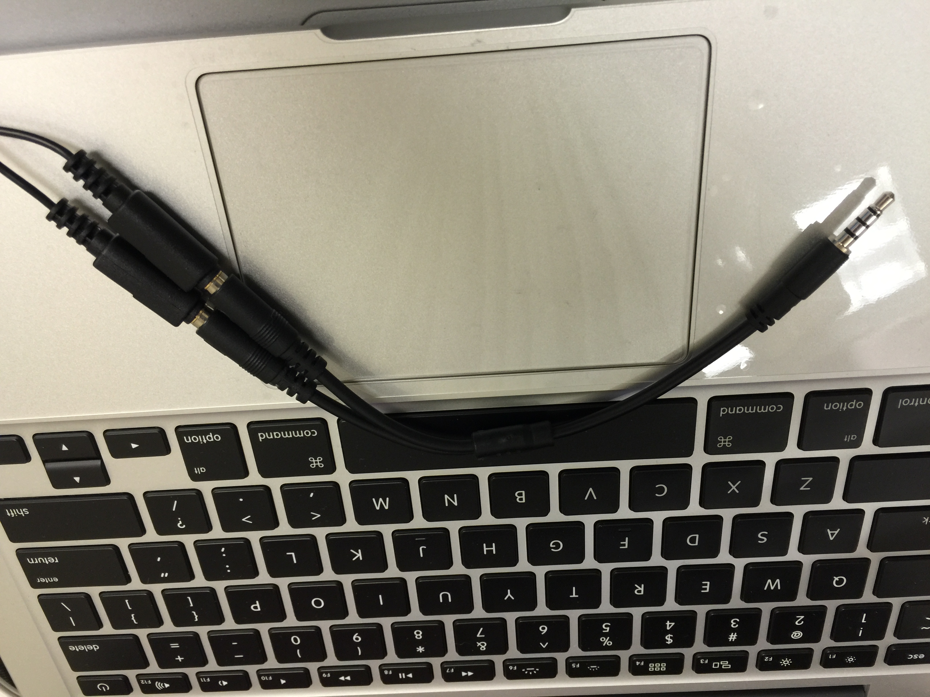

So I bought this Startech cable thinking if it worked I would just return the iLuv adapter.
It's not working but I'm guessing it's because the plug that's going into the Startech is a 3 pin 3.5mm plug and not the 4 pin.
Is that a safe assumption?

Headphone with mic, 4 pin. The cable I linked IS a 4-pin to 3-pin splitter. Maybe you were sent the wrong one by mistake?
