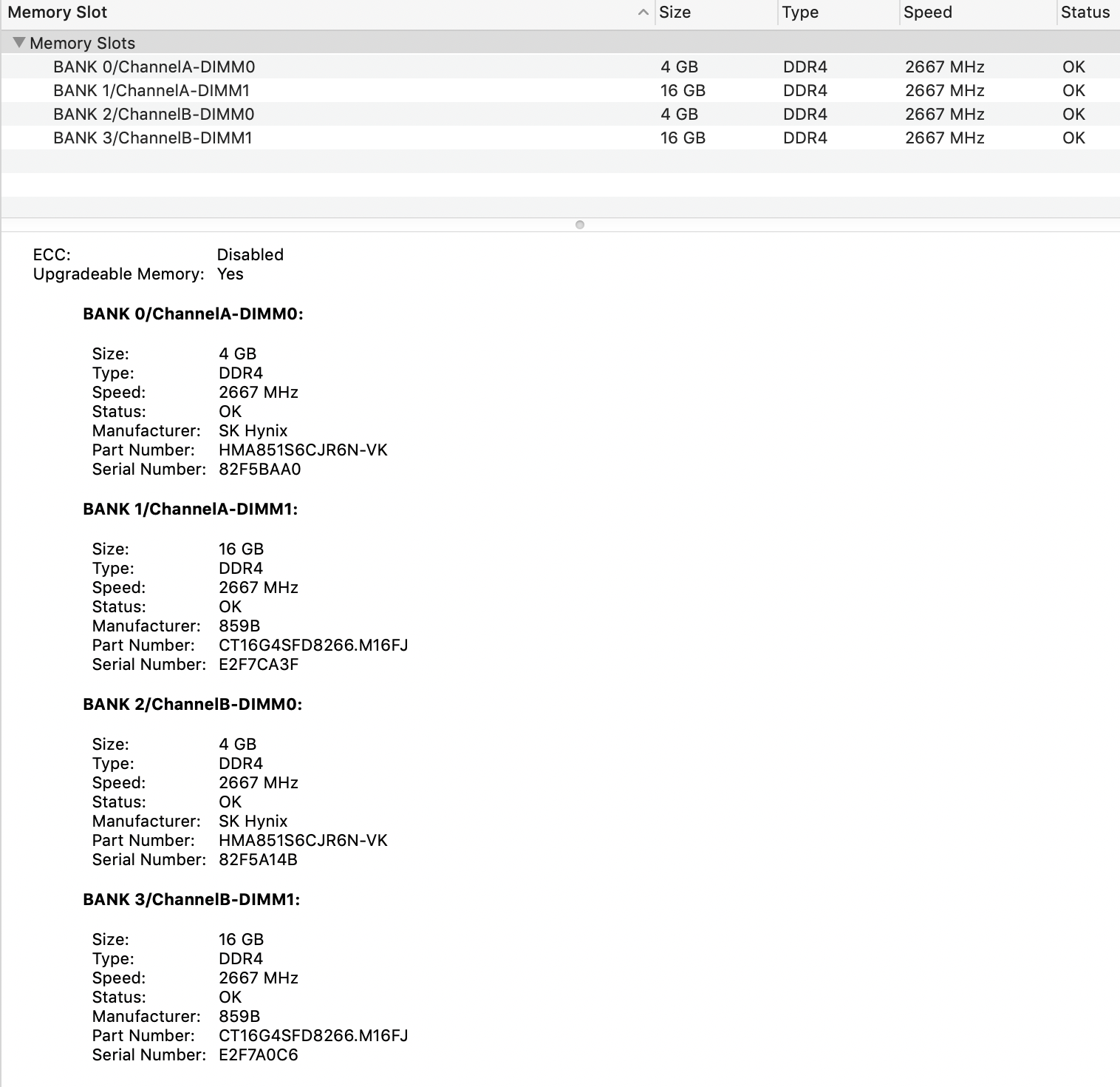

I recently purchased an Apple store refurb 2019 27" iMac, all seemed well so I added 32GB of Crucial RAM for a total of 40GB. A couple of weeks after the memory upgrade I am getting 3 beeps when I wake the iMac from sleep, no other indications of a problem, just the 3 loud quick beeps on wake but not on boot. I think this has something to do with a RAM problem but system report and activity monitor both show 40GB and no problems.
I also restarted into Apple Diagnostics which ran for a couple of minutes and reported "no issues".
Three beeps "at boot" is a RAM problem. He's not getting that. He's reporting three beeps when he wakes the machine. I think it's something different. I bet a running app is doing the beeping and is nothing to worry about. OP, if you don't mind, record a short audio or video of the beeps and post it.

I also have a refurb 2019 27" with the same setup (2 additional 16GB Crucial modules). I haven't had that issue. I did do a clean install of the Catalina though. You might want to try some "swaptronics" and see what you get. ie does it happen with just the 2 4s installed? Does it happen with JUST the 2 16 installed? How about just one installed? What if you swap slots (putting the 16s in 0/2 and the 4s in 1/3? etc.
1. Take the memory you added OUT of the iMac.
2. Run that way for 5-7 days
3. Are you still getting "the beeps"...?
