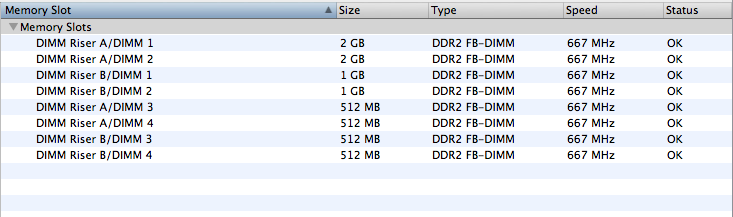

This is current positions of the modules.

I would think that its bad RAM or one of your DIMM slots has died.
From Apple.
Anyways, try taking out everything but a pair and try booting. start adding pairs until you nail the one that's causing you problem. If the 2006 MacPro had daughterboards for the RAM, one of those could have died as well.
EDIT-Speedy internet! Sorry for redundancy.
I would continue to swap them out until I have eliminated any possibility of one bad module before attempting to look any further.
Ok, i’ll take them all now, i just hope it is not dead DIMM slot as Dr.Pants said it might be.
Never tried that.
I'm in the process of swapping the modules BTW.
