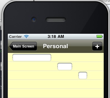

I made good progress tonight on TableViews. I did have one problem that I can not seem to solve. I would like to have 3 UITextFields on 1 TableView Cell. In the photo attached you can see the 3 but each one is on a different cell. That was the result earlier, I have changed the code now to try to store the 2 text fields in an array index and then add that to a new array.
Each UITextField is it's own Method so I have 3. I thought I could create a new method that returns an NSArray and that method looked like this.
Code:
-(NSArray *)allThreeRows{
    NSArray *tempArray = [[[NSArray alloc] initWithObjects:[self newFieldItem],[self newFieldMonthly],[self newFieldTotal], nil]autorelease];
    return tempArray;
This is one of the UITextFields so you can see the code
Code:
-(UITextField *)newFieldItem{
    UITextField *firstOne = [[[UITextField alloc] initWithFrame:CGRectMake(15, 3, 130, 25.)] autorelease];
    firstOne.borderStyle = UITextBorderStyleRoundedRect;
    firstOne.font = [UIFont boldSystemFontOfSize:17.0];
    firstOne.delegate = self;
    firstOne.returnKeyType = UIReturnKeyDefault;
    return firstOne;
In my viewDidLoad I had this code. I know my problem is the line in red since it crashes. I think I am on the right path trying to add the 3 separate textFields to an NSArray and then adding that array as an object to a new array. So I would end up with 1 Array and at each index would be an Array that contained 3 UITextFields. I think I am close to solving it.
Code:
- (void)viewDidLoad
   [COLOR="Red"]addTextFieldsArray = [[NSMutableArray alloc] initWithObjects:[self allThreeRows], nil];[/COLOR]
    self.navigationController.navigationBarHidden = NO;
    UIBarButtonItem  *newBarItem = [[UIBarButtonItem alloc] initWithBarButtonSystemItem:UIBarButtonSystemItemAdd target:self action:@selector(addTextFieldsToArray)];
    self.navigationItem.rightBarButtonItem = newBarItem;
    [newBarItem release];
    [super viewDidLoad];
    self.view.backgroundColor = [UIColor colorWithRed:1 green:1 blue:0.75 alpha:1];
