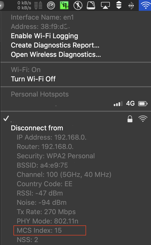

To get 450Mbps, you need 3 antennas, on both ends (computer and access point/router):
JXER1eFhqc2Pg2Jp.huge
Check the MCS index in your wifi status, it must be at least 16.
Mine is on 15, because it connects to airport express and that one has only 2 MIMO antennas (i.e. max 2 spatial streams).
As MBP gets full 450, the problem must be in iMac.
Just checked the MacBook Pro has MCS index of:23, the iMac has MCS index of 15. So my question would be it looks as if my wifi card is only operation 2 MIMO antennas should I have 3 on a 2011 iMac ? is there a possiblitltiy one is not working or simply not there. Is any way of telling with out taking the iMac apart
