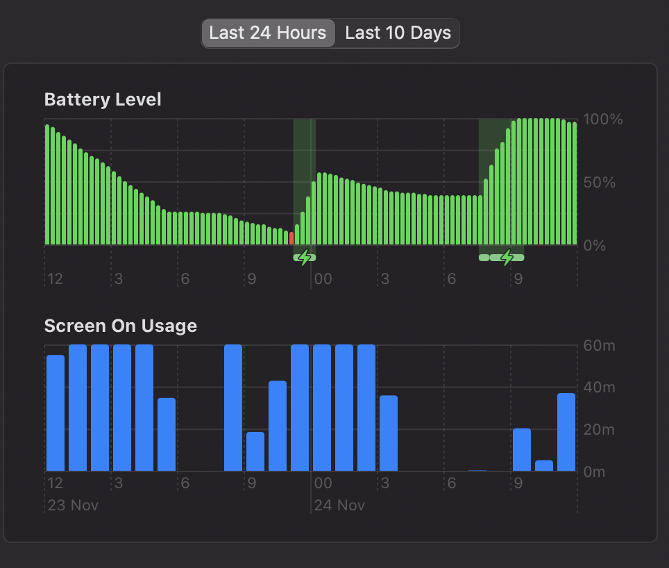

I agree that is indeed what it says. Has anyone actually done a charging test?
I charged mine machine recently with the 30W charger and have these results if anyone wants to compare with the 61W charger.
Each green bar in the battery prefs represents 15min or 0.25h and looking at those two slopes ... it seems that I'm getting around 12.5% per 0.25h or around 50% of the battery charged per hour. I understand that the charging will slow after 80%.
When I run it down to almost 0% and charge it until full it's less than 2.5h to charge (2h28m IIRC), which is consistent with 12.5%/0.25h or 50%/h for 0% to 80% (or 80% in 1.6h) then slowing the rate down to 5%/0.25h after that for the final hour.
I can't really see the huge benefit of the large charger and would prefer NOT to pay an extra £20-30 for it, when the machine is only £900 to begin with (3% extra on the machine) but maybe that's just me.
