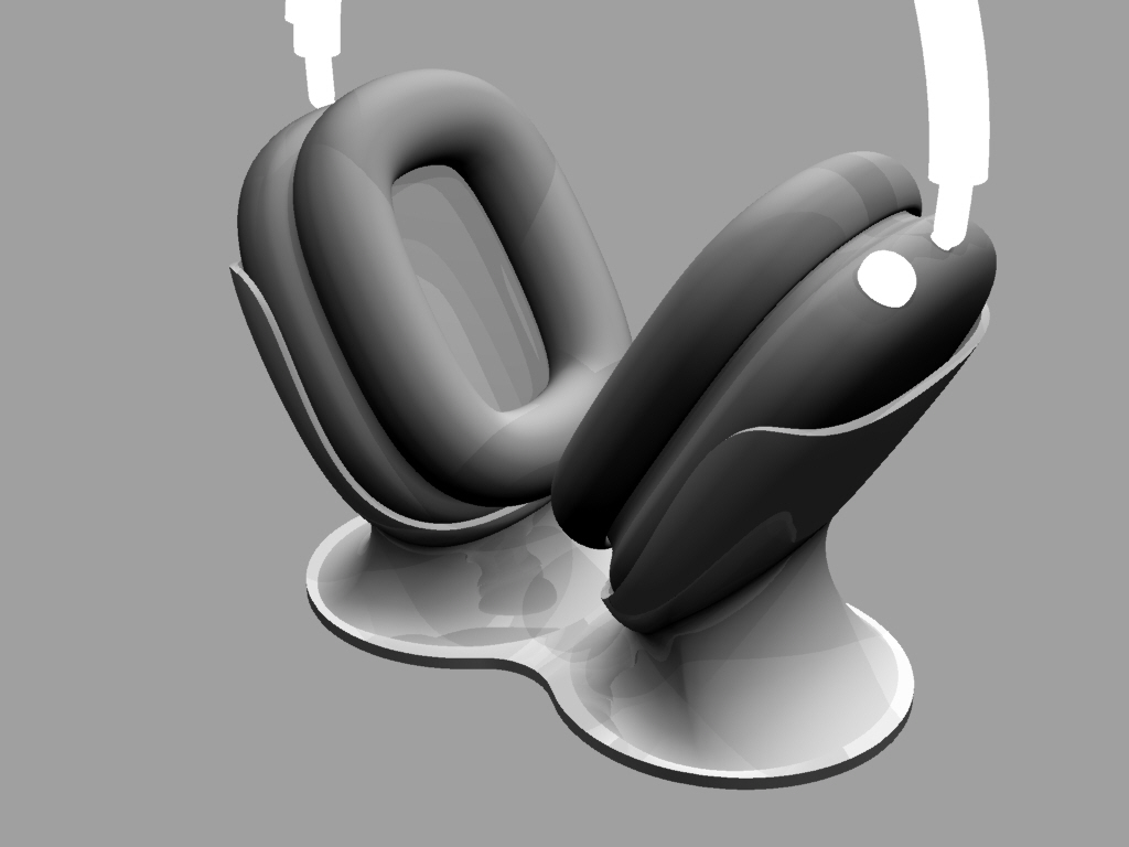

I created this retro look Max stand, this can be 3D printed, and is free for anyone.
If you go to a forum for 3D printers, there is always somebody to help you get this printed.
I also created this because I don't want it to hang on a stand, and maybe deform the mesh after a few months 🙂

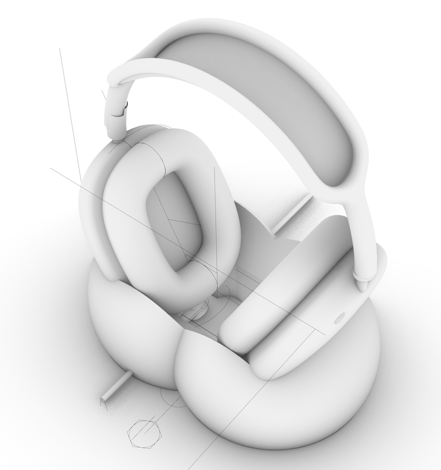

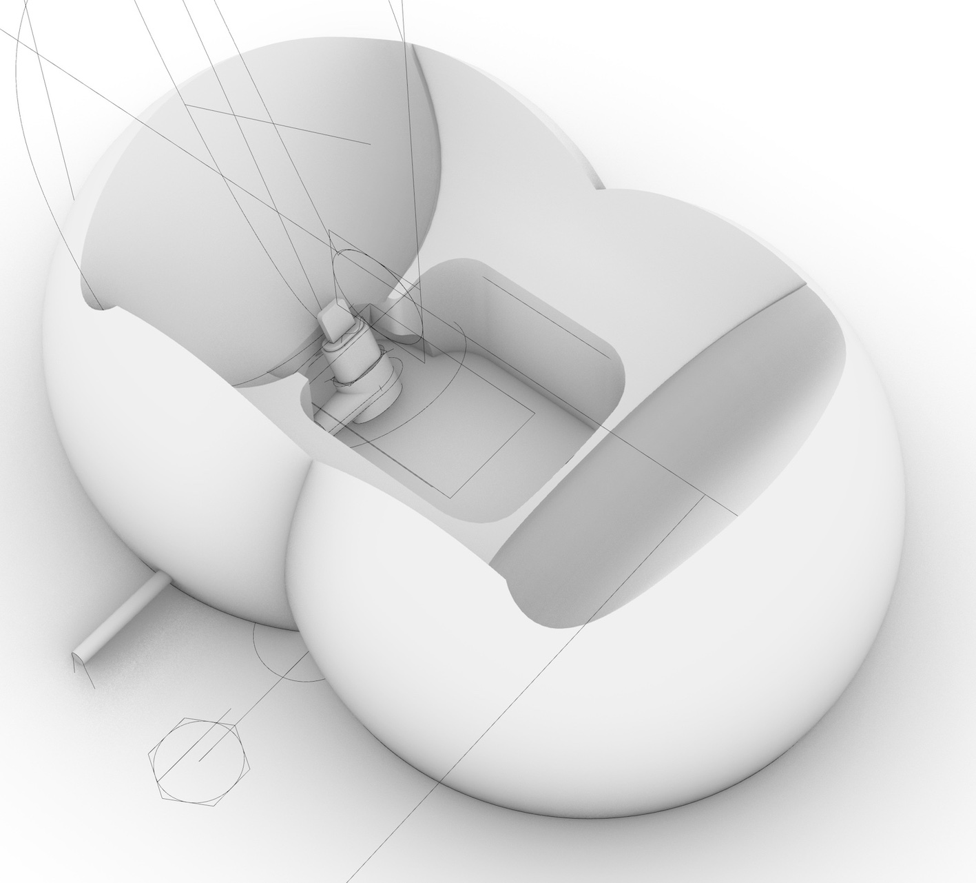

There is a 3D model of the headphones, but they are slightly offsize.
I 3D scanned my headphones to get the correct measurments, and created the stand with Rhino3D.

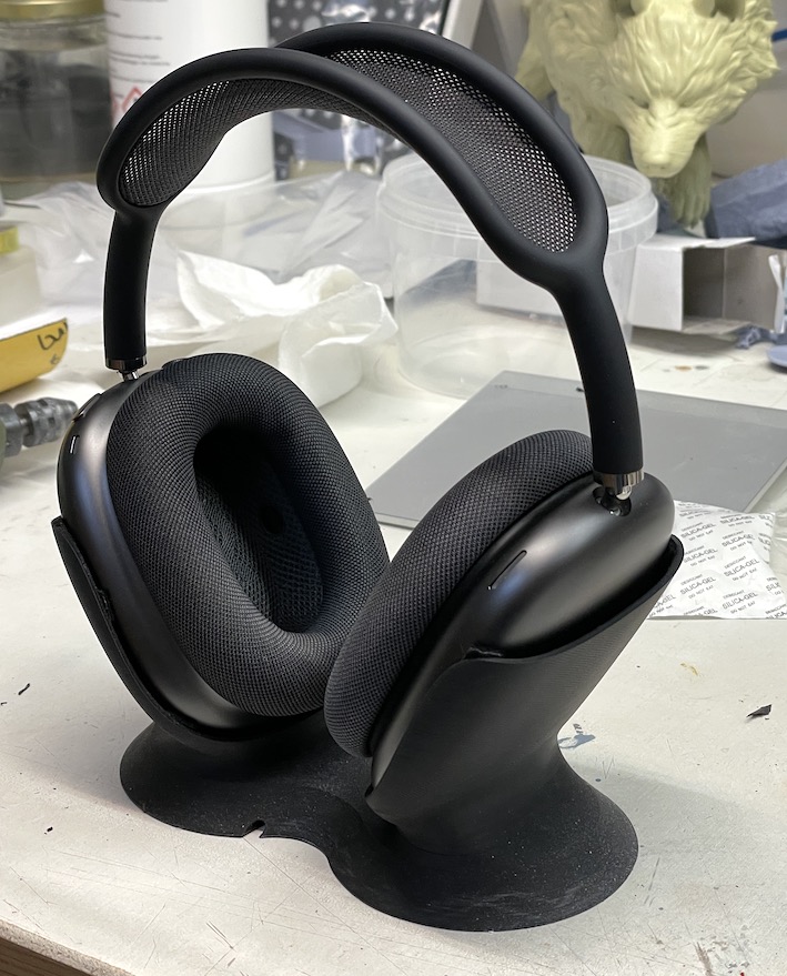

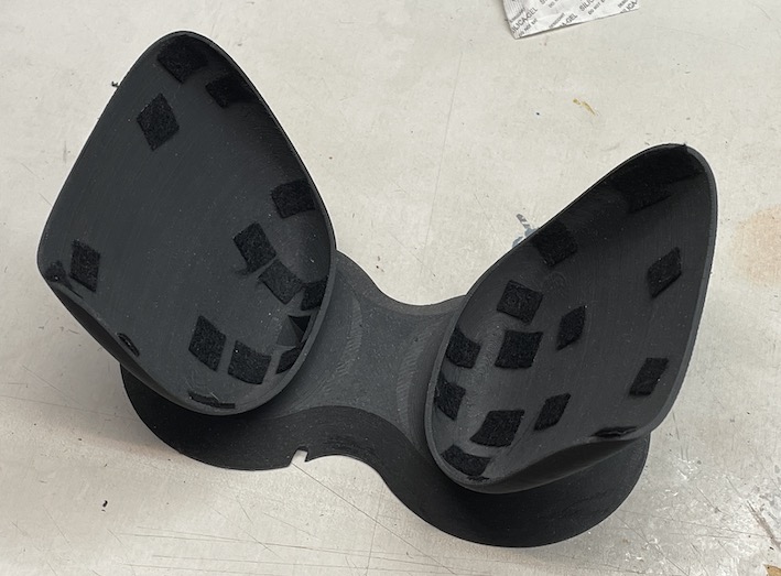

This is the test print (older design) to test if the cups shapes were good, I jus added some small bits of 1mm felt to check the fit.

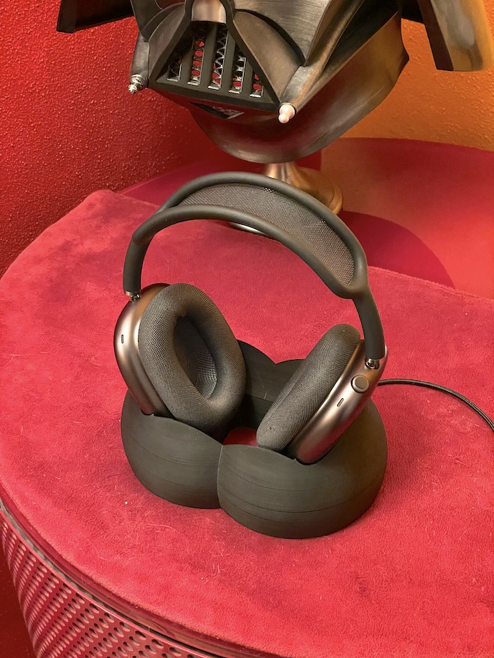

I use an Einscan pro 2X for 3D scanning, and printed the stand on my Ultimaker 2+
but any 3D printer with enough bed size will print this, only if you want to print ABS, you need an enclosed printer.
If you just print the object, and use it as is, then PLA is the best option to print,
if you want to paint the stand you might want to choose a better sandable material like ABS ( can be vapour smoothed), or PETG.
I printed these in ABS, as I want to paint it like the Max space grey colour 🙂

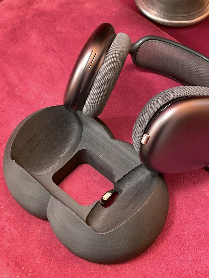

Test printed the second design test version, this has a generic angled magsafe lightning cable, with a tiny dongle in the max charge port.
This work good, but I had to add some weight to the stand, so not lift the whole thing up 🙂

From which app you rendering this white version (Ambient Occlusion)?

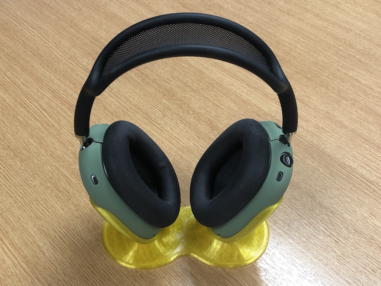

It seems that my stand also works with the silicone covers.
this is printed by iDoogs on Thingiverse 🙂
