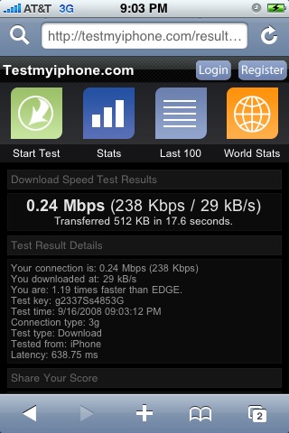

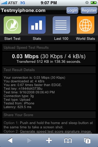

today i tested the speed of my iphone 3g. Before the upgrade 2.1 my phone was very slow at my house it would always switch to edge right when i walked inside, ever since 2.1 i have experienced full bars of 3G reception in the same spot of my room as it would switch to edge. But i personally think after these test that the bars are there to make people feel good about there reception. Because i always have full bars everywhere now. Is that not strange?!
The first test is the Download Speed: took 17 seconds to download 512 kb
The Second test is the Upload Speed: took 138 seconds to upload 512 kb
Who else is having this same slow download/upload experience?

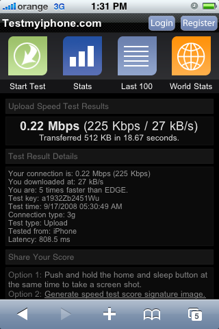

here is my test
i did this in my house where field test (dial *3001#12345#*) averages -80 db
in field test you see a number instead of the bars , in my home ranges from -60 at window to -90 in basement , and around -50 outside
be aware that the bars represent a average over time , the actual reception number changes wildly even when rotating the phone without moving
also important is where you keep your hand on it as antenna is in the lower part of the phone's back
