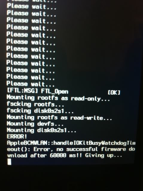

I am having the same issue with my friends 3GS. He was running 3.1.3 with firmware 5.12.02. It was too late for me to save his SHSH file using the Tiny Umbrella obviously.
So I went and used the latest Pwnage Tool and made a custom firmware for his 3GS using this IPSW----> (iPhone3,1_4.1_8B117_Restore.ipsw). Pwnage says it successfuly went into the DFU mode.
I went to iTunes and click option+ restore, selected the Custom Firmware and it went through the normal process of restoring... The only problem is the phone is stucked on recovery mode (Black screen) and I couldn't kick it out of recovery using the Tiny umbrella coz its all grayed out. I tried the process sevral times and its the same outcome... Stuck in recovery mode with a Black screen!
What am I doing wrong?

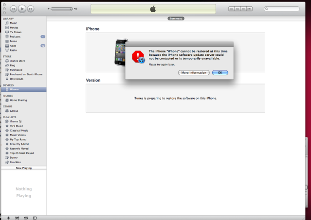

Are you serious? No one can actually help me on this? I tried using Redsn0w using 8C148a_Restore.ipsw for my friends 3GS. I selected download Cydia and it goes through the process then it gets an error on the phone with this:
And when I try to restore with the official firmware through iTunes which is the 4.2, this is what its telling me:
