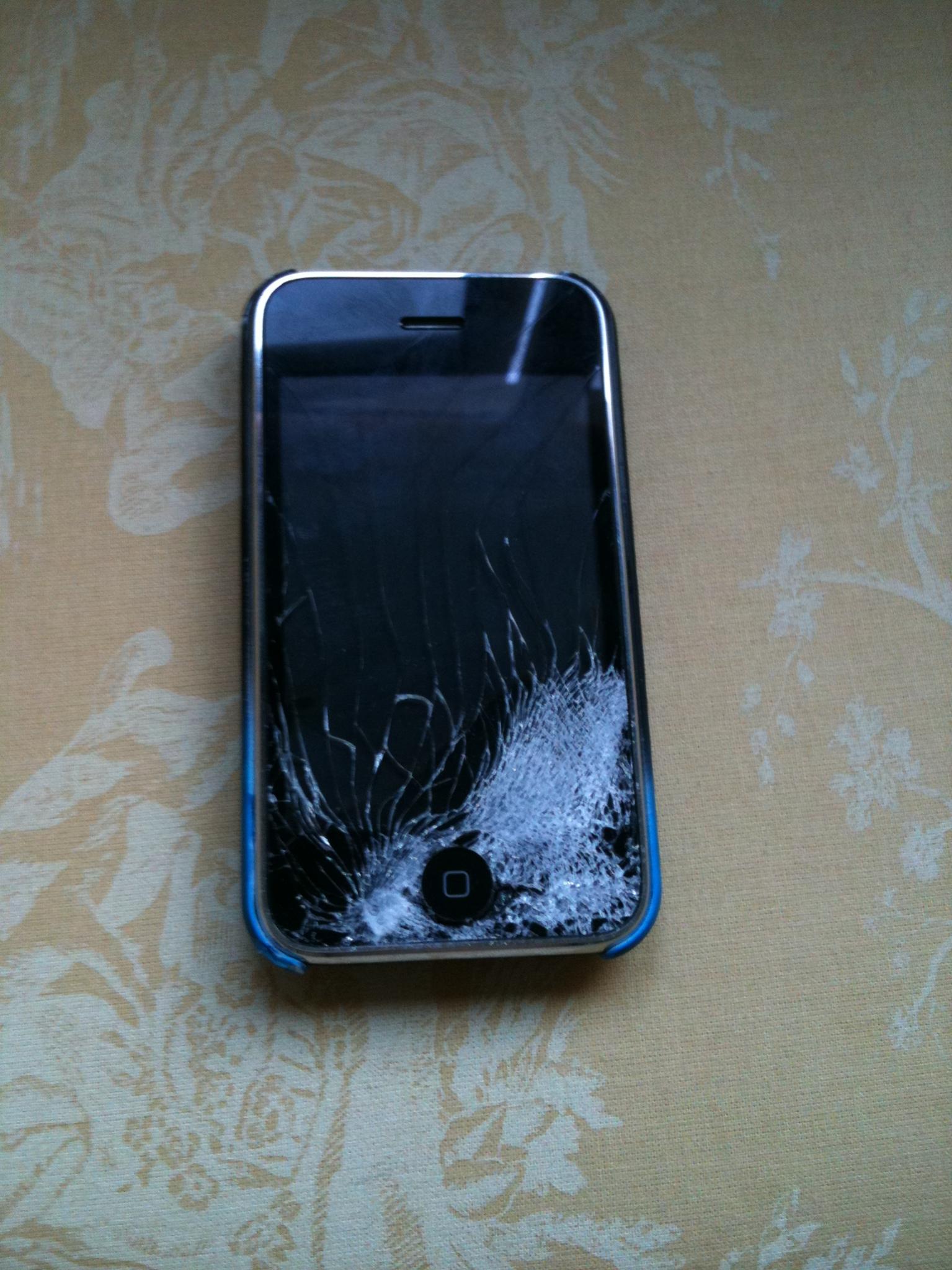

I took my 3G to an Apple store in UK.The screen was totally shot with just a white light behind and wouldn,t switch off.They replaced the screen and charged me £79 total with a 3 month warranty.All is back to normal and working fine now🙂
