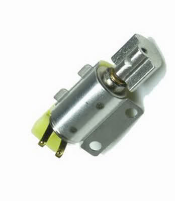

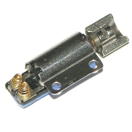

Here are some photos. The former shows my vibrator part, the latter being the one I see everywhere else (including ifixit)
The one with coils I think is original equipment, the bent tabs is what you typically see as a replacement part.
Make sure it is matching up with the contact patches on the main board? Otherwise I would say replace it.
I think it's matching up. But I can't really tell because it's not facing me..
The new housing might be displacing the whole thing a little because there are slight structural differences with my old housing (particularly the volume buttons, those were a bitch to fit right because they're less deep on the new housing)
Perhaps tugging on the coils with tweezers (increasing their range of motion) will work?
