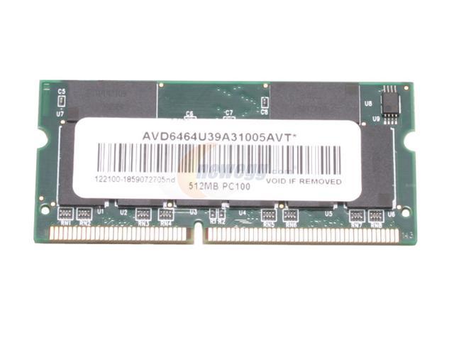

So how can I tell from the specs page at datamem that the module contains 16 chips?
Here's an image of the AllComponents Module from newegg. So is this one a 16 chip module?
