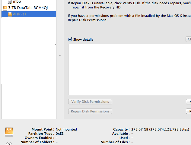

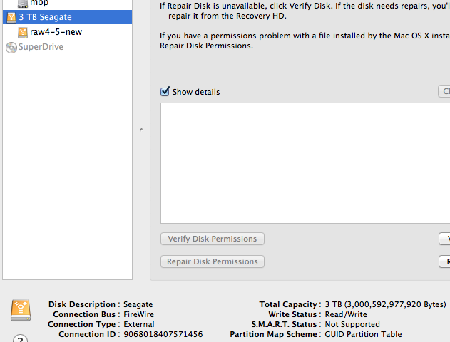

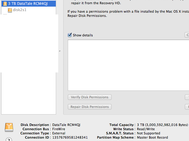

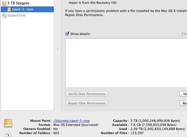

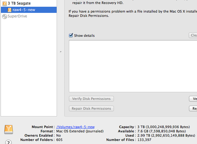

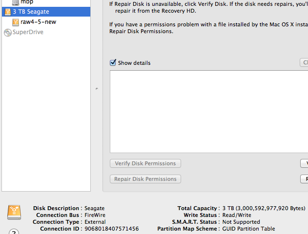

Update: Here's a 3TB drive that always mounts fine in my Goflex dock, but no longer works in my Datatale enclosure (though it did before). Here are screenshots showing how the drive looks in DiskUtility; first working in the GoFlex, then not working in the other enclosure. The partition is showing as 0XEE when disk is in the Datatale enclosure; GUID when in the GoFlex dock.
