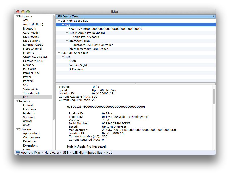

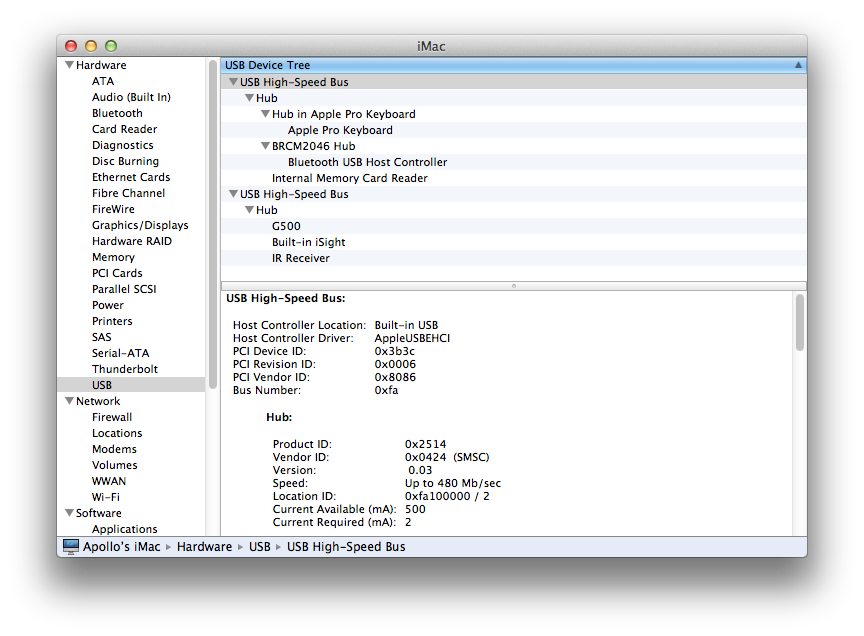

So I noticed while trying the above that my iMac is, somewhere, recognizing that something is attached to the USB port. In the attached image "after" you can see some device 6789012..... from ASMedia Technology Inc. This must be my drive, as this item is only present when the drive is attached and powered on.
Still nothing in Disk Utility, however.
