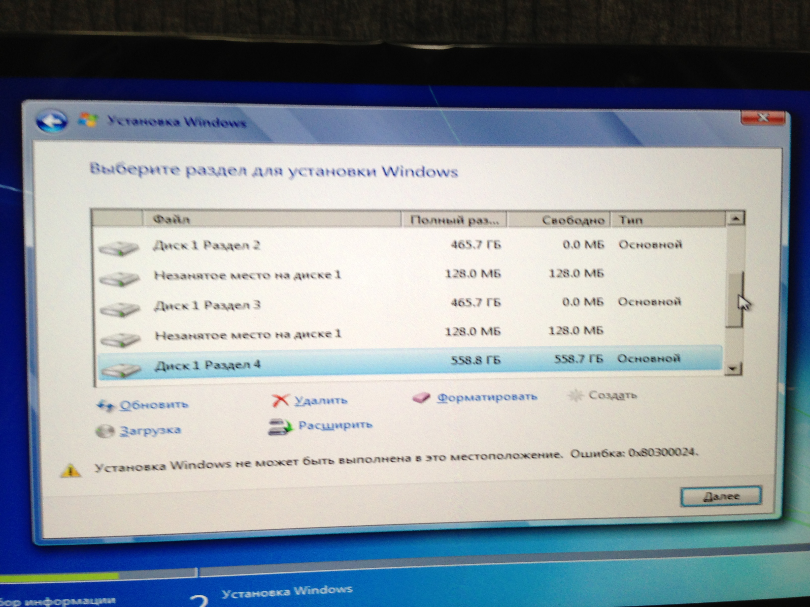

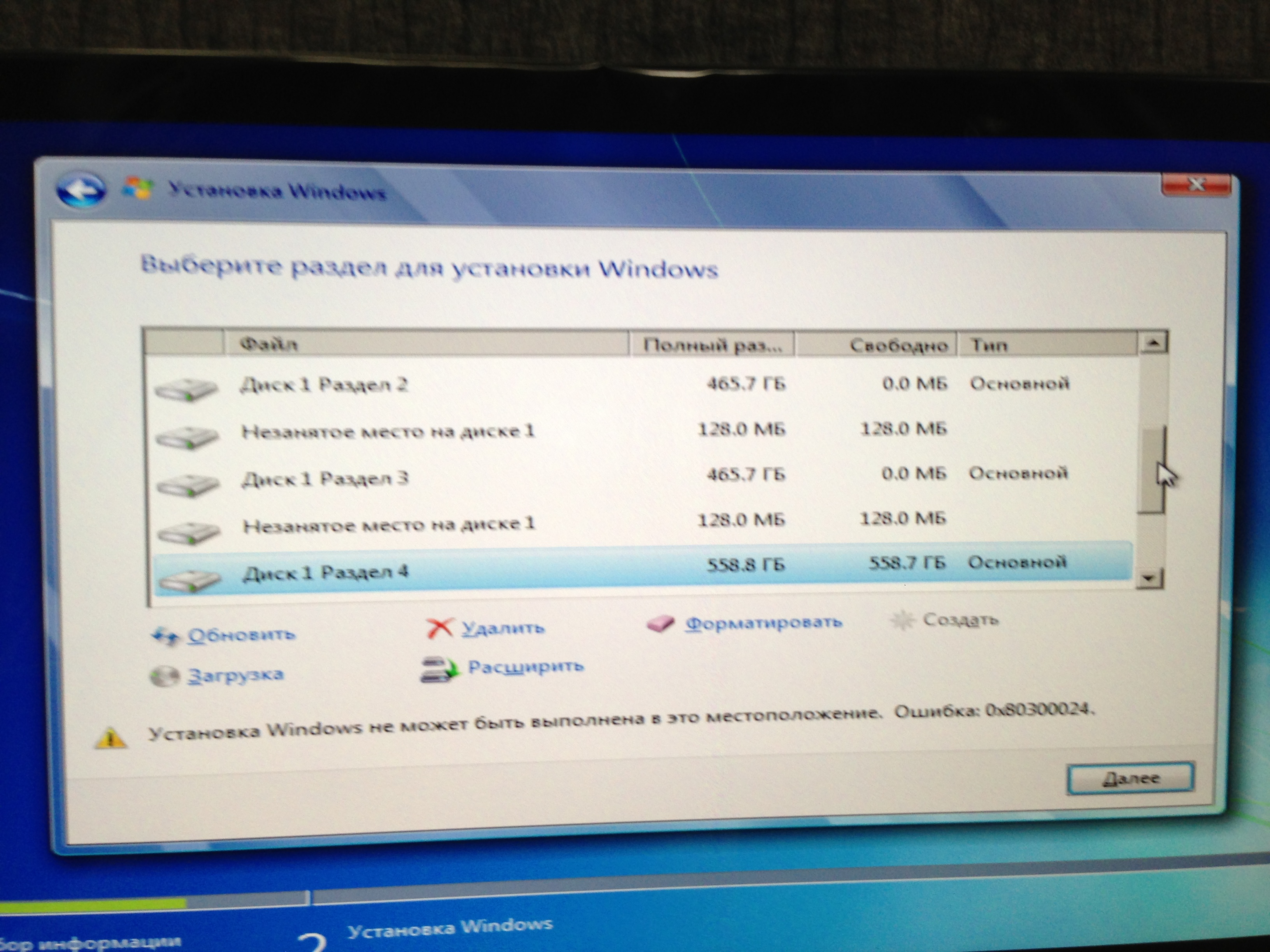

So what i've done:
1) Unfusion, partiton 3 drives (800+800+1400), refusion (ssd+800)
2) Unfusion, partiton 3 drives (800+800+1400), refusion (ssd+800+1400)
3) Unfusion, partiton 4 drives (800+800+1400), withoud refusion
4) Unfusion, partiton 4 drives (500+500+800+1400), withoud refusion
none of this methods doesn't work
maybe i've got faulty win7 iso image - it's russian
also i do no understand why i hsould install mac os or refusion drives before install windows......

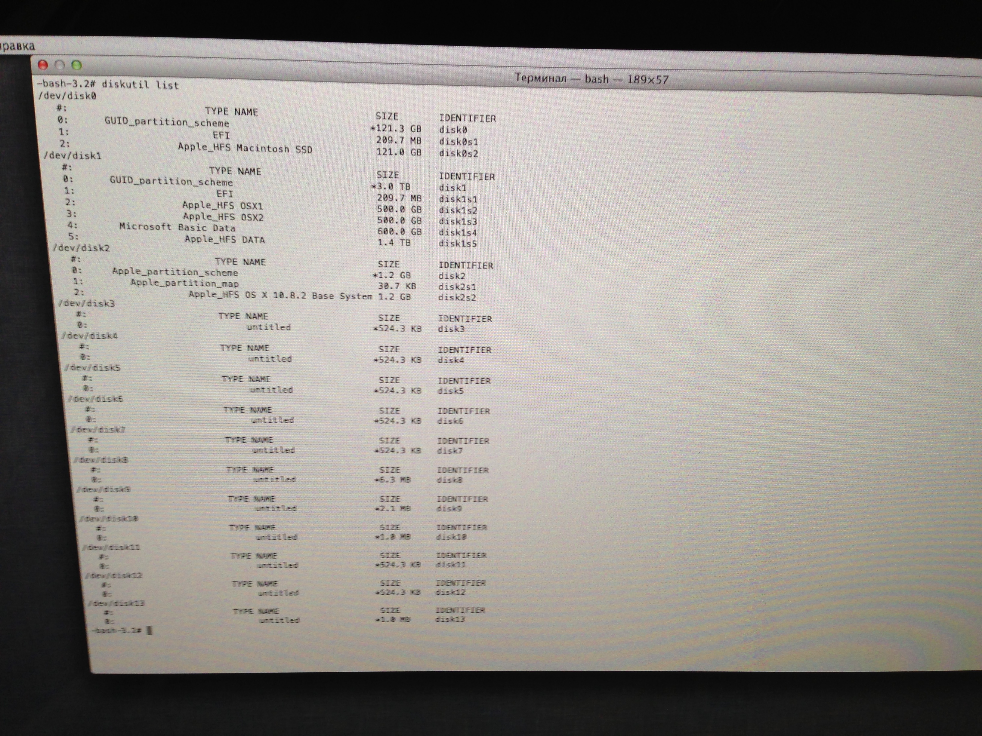

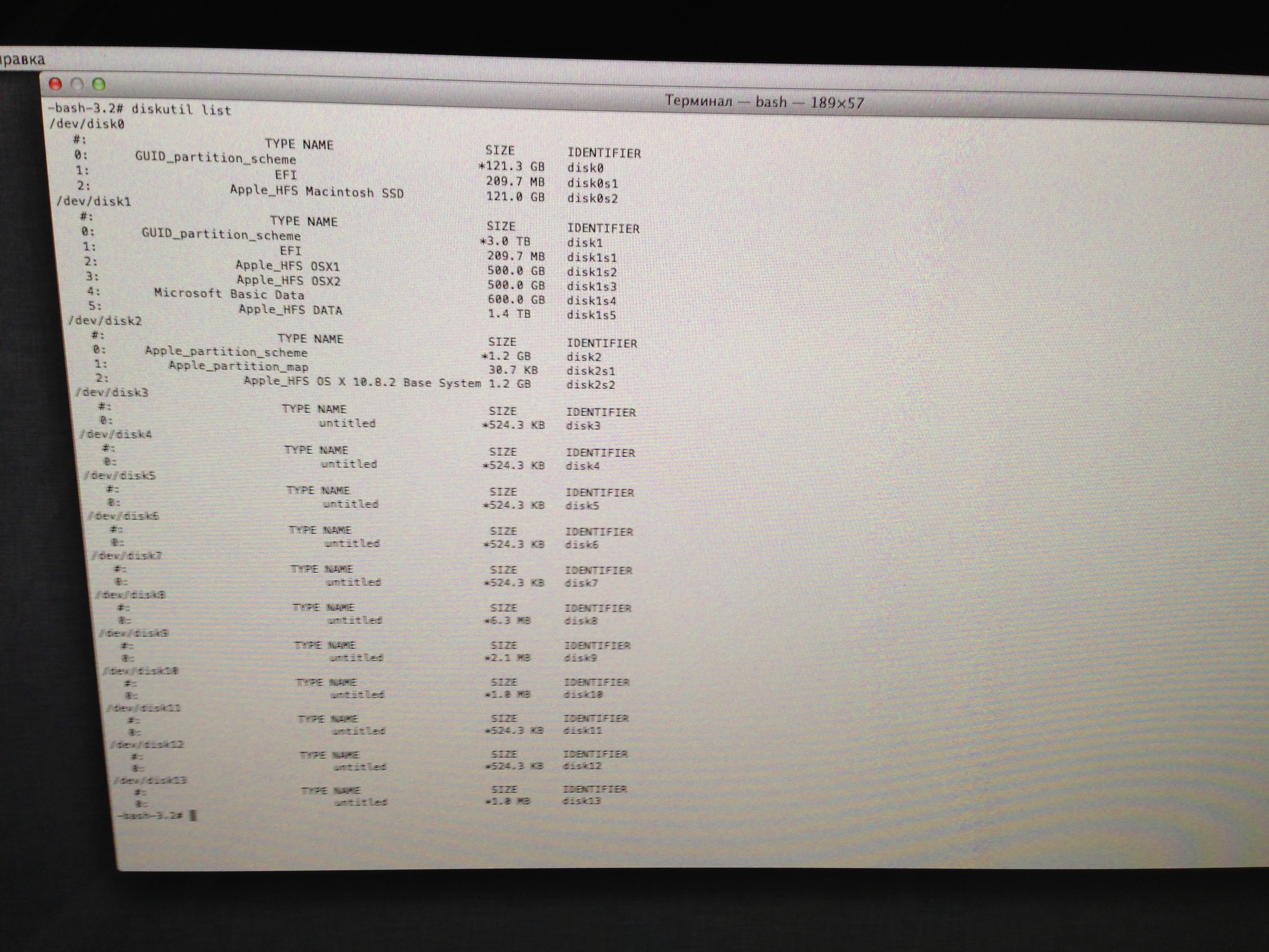

and last thing gets me confising: terminal command "diskutil list" shows me very long list, but there is no drives connected (check out attachment)
guys help me please )

No, still same error:
after i select correct partition to install i'got message that windows could create addition partitions for it's need and then error 0x80300024 could't install to this location

If you google that error it seems to be a common issue, you have to remove all other drives except the one you are installing windows too so windows does not see any drives with GPT (GUID) which could be a big pain with the iMac..A good way to trick it is to format the SSD as MBR (master boot record) Then install windows on the HDD, then go back and reformat the ssd back to GUID and fuse it back with the HDD partition and reinstall OSX.
