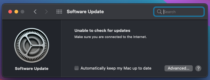

Hi,
I upgraded to Big Sur 11.1 (from Catalina) few weeks ago and MP5.1 is working great - surprisingly it's snappier than Catalina...
One problem I noticed is that Software Update is not working and complains that it is "Unable to check for updates. make sure you are connected to the Internet" (attached).
Of course I am connected and can access any web site (including this one here), so there's something else going on. Could it be related to platform id, logic board id, etc.? I tried deleting all preferences and caches, reset NVRAM / SMC but with similar issue. Any ideas what could be wrong?
Thanks.

Hi,
Thanks.
That's with the latest OpenCore 0.6.5?

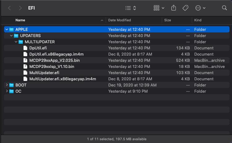

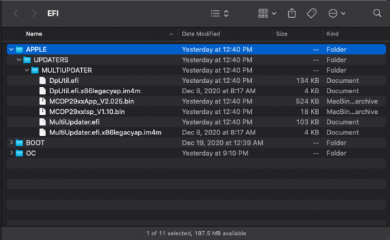

I was just looking in my EFI folder (to update to 0.6.5), and noticed there is an "APPLE" folder which was not there when I was still on Catalina - it was added after upgrading the Big Sur (see attached).
Does that look ok? should I leave it or do I remove it?
Thanks!
Thanks!
Leave it, that's irrelevant, no need to touch it.

That's looks more like network issue.
