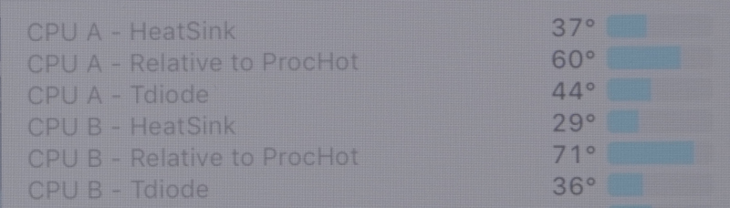

When the system is idle it looks like this:
I read that this is a normal temperature distribution: CPU A is warmer than CPU B because the air flow has to go through the heat sink of CPU B first.
Until now I was under the impression that CPU(Tdiode) temp + Relative to ProHot = max operating temp for the CPU:
- CPU A: 44 + 60 = 104
- CPU B: 36 + 71 = 107
For what ever reason CPU B does have a higher limit.

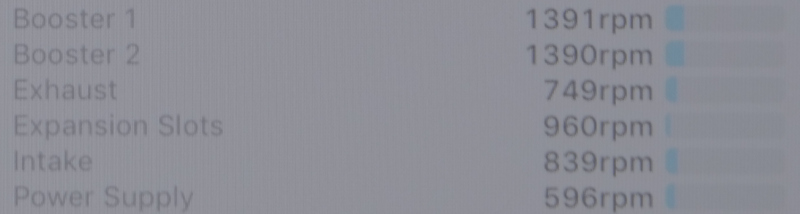

Fan speeds look normal too:
Until here I'm not concerned, but ...

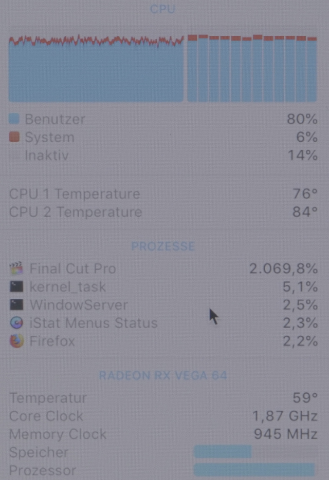

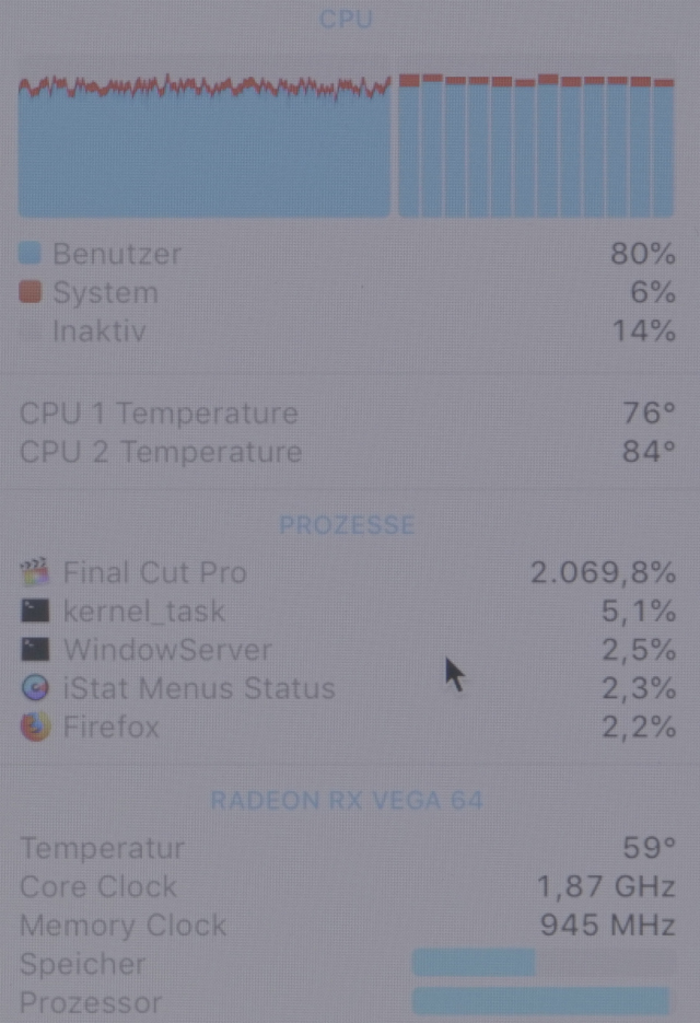

...when Final Cut does some coding and rendering:
the CPU temps look like this:

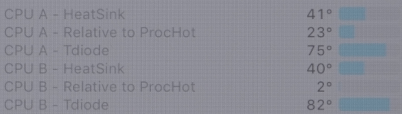

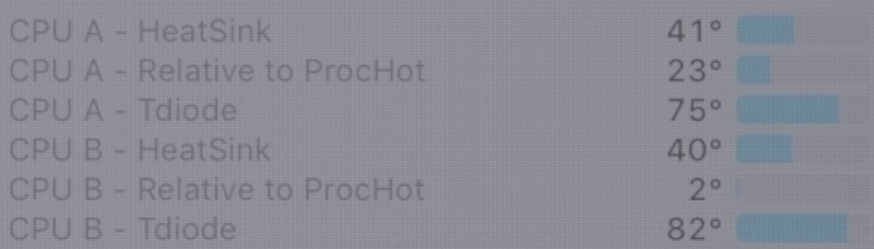

Now CPU B is warmer than CPU A ... and the max operating temp seems to be significantly lower:
- CPU A: 75 + 23 = 98
- CPU B: 82 + 2 = 84
The Relative to ProcHot value for CPU B even fluctuates quite a bit:

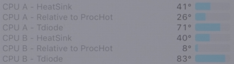

Here it shows: 83 + 8 = 91
Whereas CPU A is still: 71 + 26 = 97

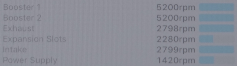

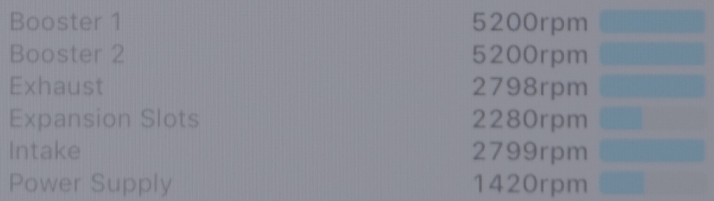

The fans go full speed during this condition:
When the coding/rendering is done the temps go down in a second ... and the fans spin down as well.
Is there something wrong with CPU B? Why does it seem like the max temp is so much lower under load?
Is CPU B and here the very little tolerance to max temp the reason for the fans to go full speed?
You need to re-paste the cpus as the difference between diode and heatsink is high, especially under load.. typical values are 1C to 4C degrees when idling and 4C to 6C under load.

I would not have thought that applying new termal paste does have such an effect:
I did re-paste the CPUs (and the northbridge as the coolers were disassembled already) -> everything is back to normal!
