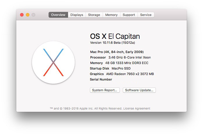

I disabled SIP and proceeded with the same steps, I held the power button down until I heard the beep and the Mac showed a bar similar to the startup bar but bigger and closer to the bottom as well as having a color thats more grey than black. I waited for the bar to fill up and it opened up the DVD drive, then near the end of the bar (around 90%) the computer restarted by itself. I booted up normally and the Mac is still a 2009.
EDIT:
After a closer look, the firmware did update to MP51.007F.B03, I just thought it would also say Mac Pro (2010).
I wonder how this affects a macOS install, does it go by 5,1 or by Mac Pro (2009)?
That 2009 is cosmetic, you can write down whatever you want.
As long as the firmware is 5,1. Sierra will install without any issue. (At least it's true up to this moment).
