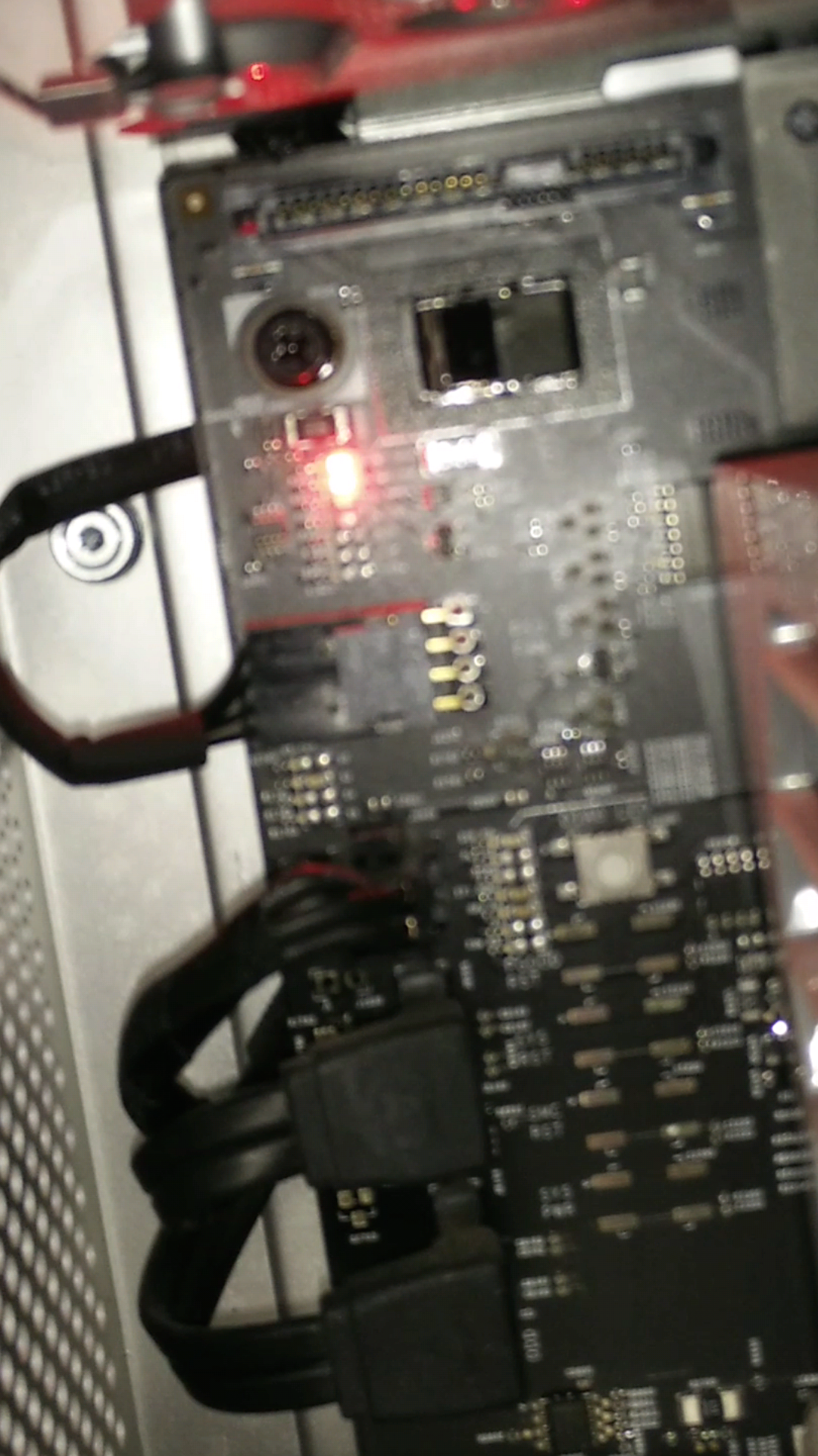

4.1 Mac pro Shuts Down when put to sleep
the flash is blinding..i cannot see which led goes off
Can you get hold of some kind of foil to reduce the blinding led light into your eyes? Important is to check the number and/or position of the led.
Do you have the Apple Tech Guide for the MP 4.1 for trouble shooting the led when you are able to see wich one(s) fire up?
so i checked the led that go off, its the top 2 led's rite under the sata connector number 1 they light up for 1 second then they turn off....any clue what that is?
We need an absloutely clearer picture. Take a sharp picture and edit it by redusing the luminance of the leds by downgrading it with a simple photo editor!
Glad to help, but can't see anything on your posted picture so can't compare with the ATG for MP 4.1 (early 2009)
