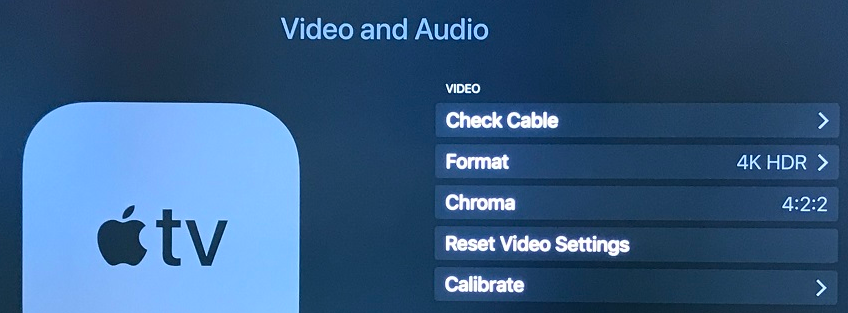

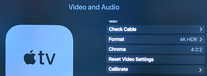

[doublepost=1523457716][/doublepost]Hi,
I am missing something I know, but I just moved the the Belkin Cables Apple Recommends & finally can switch to Dolby Vision without any sparkling & Flickering. When trying to get everything to work (I was using Audioquest Pearl Cables, which should have been up to the job), I remember being able to switch between Chroma 4:2:2 & 4:4:4 but now I cannot find how to do that, or check what Chroma I am on.
Help Please!!
Was there before & just there - what is the route as I went into all the headings and do not find it
It's right there in the Video & Audio settings, top level. It's not any deeper than that, so I can't really give a "route".
It sounds like your Chroma setting went missing, so the Chroma setting visibility might be dependent upon some other setting being enabled or disabled, probably related to HDR but I don't know.
Ok, thanks - yes this Chroma line simply does not show! The only things I have done is connect the Belkin Cables, (Everything was powered down during this) and while I was travelling the unit updated to the latest software. This line simply does not show - I am going to try turning off the matching, reset to 4K HDR & do a restart
UPDATE: I tried this process twice before Today, but strangely this time, unticking matching did produce the Chroma line, which was already set to 4:2:2 (That & 4:2:0 were the only two options). Do you have only the same two choices?)
