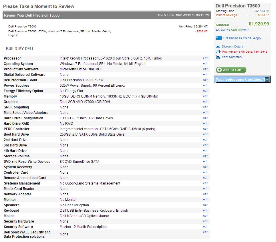

No its not, I did exactly that on dells site and it came out over 1000 dollars cheaper than apple.
Wrong CPU, that's the old model. Those V7900s you chose are in no way comparable to the default cards on the nMP. No thunderbolt. No ethernet. Actually no wifi as far as I can tell. Slower SSD. Probably loud, large, and ugly. But you do get a DVD drive... enjoy!
This is the closest I could get on Dell

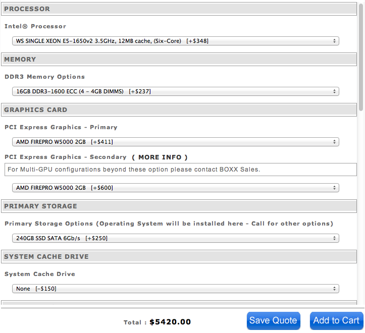

Here's BOXX
The v7900s have 1250 stream processors each. That's actually more than the Mac pro.
You really think dell would ship a workstation without ethernet.
