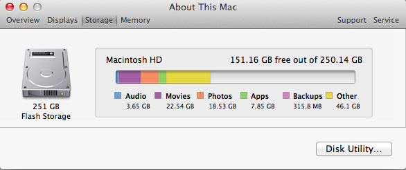

Hey Everybody,
Recently I transferred all my files onto my new external Hard drive and did a Time Machine backup to my Harddrive. I thought that I would have freed a lot of storage but I have 50gb of other (well 48gb) Could anyone tell me how I could get rid of some of that? (Apologies if this has been answered and yes simsaladimbamba I tried advanced search 😛 )

You need to determine what the 48GB of 'other' is, if the files don't fall under any of the other categories, they should be easy to locate.

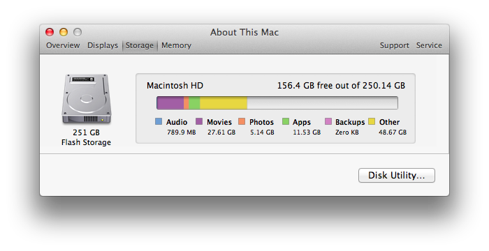

This is the drive on my MBA and my time machine is disabled. Just to double check I also disabled the local backups separately.

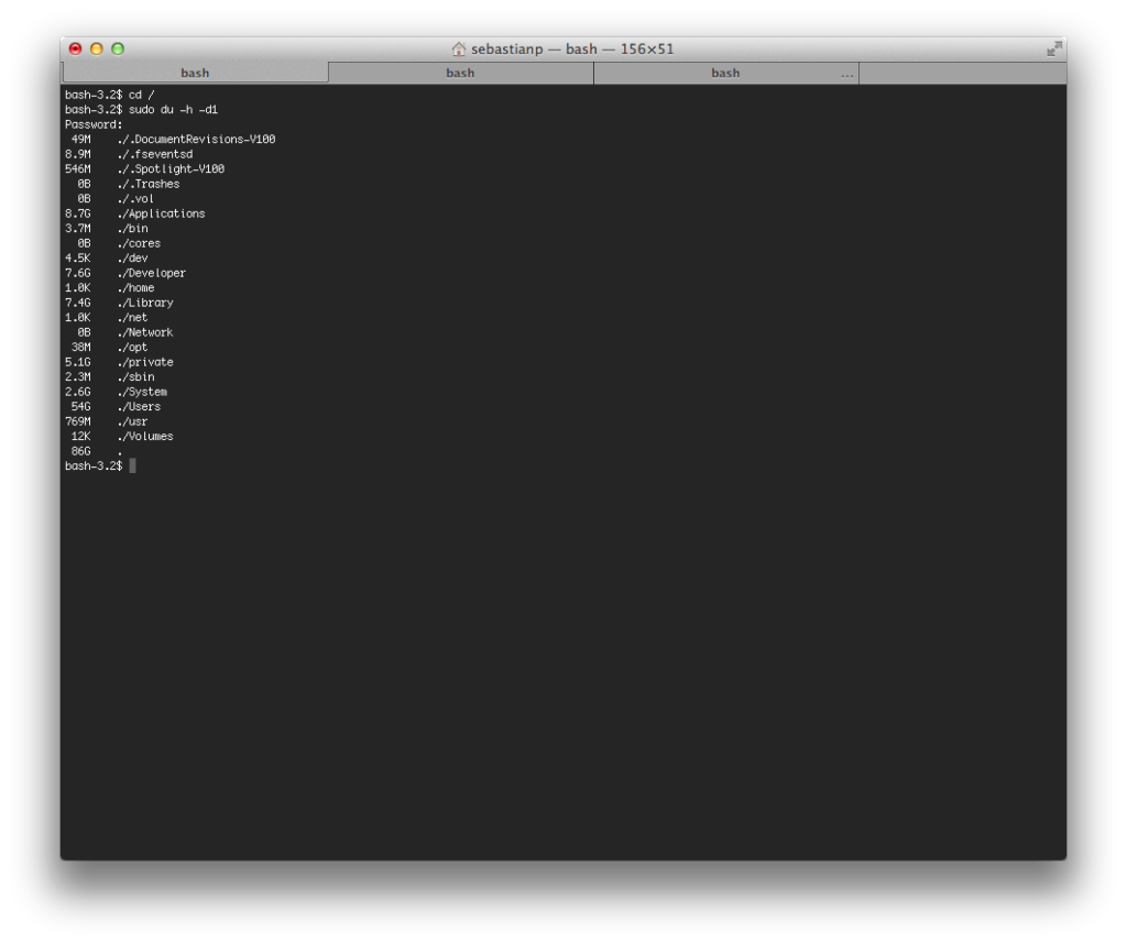

Open up your Terminal (Applications --> Utilities) or type Terminal into the spotlight window in the top right (or cmd + space if you don't feel like clicking all the way over there on the search icon)
Type in the commands as shown in the screenshot below
This is the contents of your home folder, including the hidden directories. You'll see that I have quite a lot of stuff in the Music folder but I have no music on this computer. Yet the graphic shows that I have 789 MB of Audio.
Why is that? It's because somewhere on my hard drive I do have audio files and the program that displays the graphic found them. They are not music files. They are audio files from applications and the system audio files that make the beeps and gongs when I do things like empty the trash. The Music folder is where your iTunes media folder is by default. I have a couple of movies and series in there, hence why it's that size.
You'll note that there is another big folder called Library. This is where various things get stored that pertain to the user logged in. For example, if you use iMail, this is where your mail is. It's also where your application settings are and many other things that are beyond the scope of this discussion (because I am lazy tonight 😀 )
Now follow the steps in the next screenshot.
This is the root of your volume and you see folders like System, Private and Library. I am simplifying a lot, but you can think of those folders as where your operating system is. The Library folder has a similar job to the Library folder in your user folder discussed above, except this is now more generic stuff for ALL users, not just for you. There are things like system fonts in there and even sounds for Garageband. All of this stuff takes space. To follow this example back onto the topic: system fonts will be in the "Other" category.
So what's that big Users folder? That's where all of the home directories for the users on this computer are. That's where my home directory is, which has MY movies, documents and so forth are.

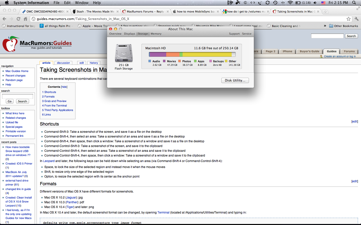

I was just about to post the same issue - but mine is even worse
Ive tried daisy disk and some other disk utils and even scanning as admin can't reveal what files are taking up all this space.

[url=http://img9.imageshack.us/img9/1135/screenshot20120104at123.png]Image[/URL]
