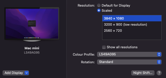

I am currently on an hdmi - hdmi connection and it's maxed at 3840 x 1080
Also tried a usb c - hdmi and I was getting an even less resolution.
Do I need a usb c - display port cable? (The monitor only has hdmi & display port inputs)
or is a usb c - display port adapter enough? (That's what's currently being shipped to me)

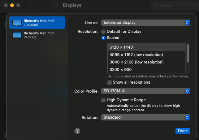

I did buy the monitor and currently have it on my Intel 2018 Mini with a standard HDMI cable. I am goi g to set up my eGPU next weekend and try it with a DP cable for G&Gs.
It seems to work fine at the 5120x1440 on the HDMI port. I will likely try it on a USB to HDMI or DP cable direct as well as on the M1 later on.
Do you have a different HDMI cable? I am using an HDMI-HDMI cable and getting the full resolution from my Intel 2018 Mini but have not yet tried it on the M1.

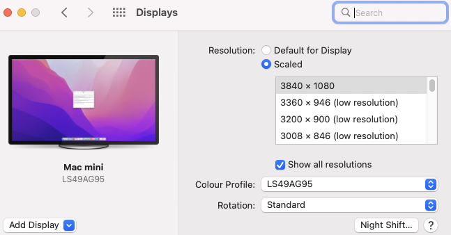

Does it give more on "show all resolutions"?

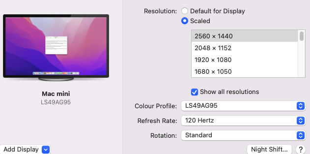

If I put it in PBP, it shows correctly 2560x1440. I just don't get the double of that. which is 5120 in wide

I wonder if you are in split mode? The monitor supports the ability to display two different inputs at the same time, it might be that the Mac is seeing one and not both sides.
yeah the last screenshot is in split mode (PBP = picture by picture)
Not sure if I made myself miss-understood, but I am having issues with it when PBP or PIP is off. so only one display.
so only one input is connected - i get max 3840
Mac minis are limited to HDMI 2.0 and won’t do widths greater than 4096. You need a USB-C to DisplayPort Adapter or cable to get the full resolution.
