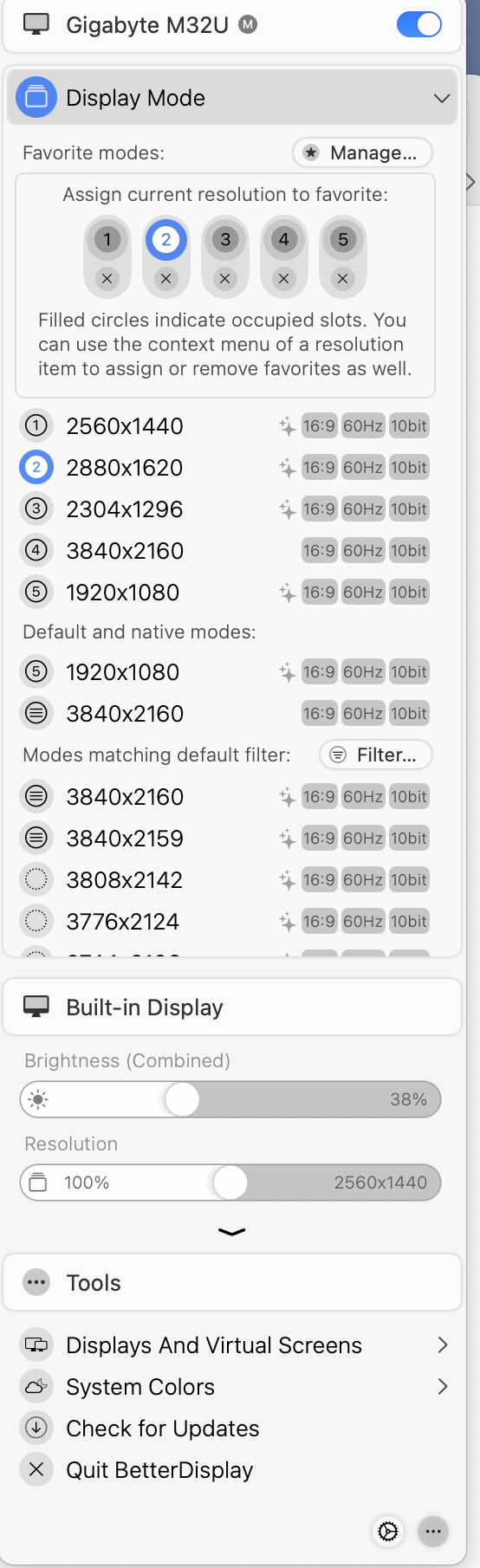

Is it my understanding that using Thunderbolt - Displayport is best for higher refresh rate?
I have a Gigabyte M32U currently used as a 2nd display on an iMac(2015 27"). Thunderbolt 2/Mini Displayport - Displayport capping @ 60Hz that has worked well using "Better Display" software.
HDMI is an option on the M32U though. Currently the 2 HDMI inputs are for an XBox X and Apple TV.
I have preordered a new M4 Pro Mini. That I plan on using Thunderbolt-Displayport or HDMI
