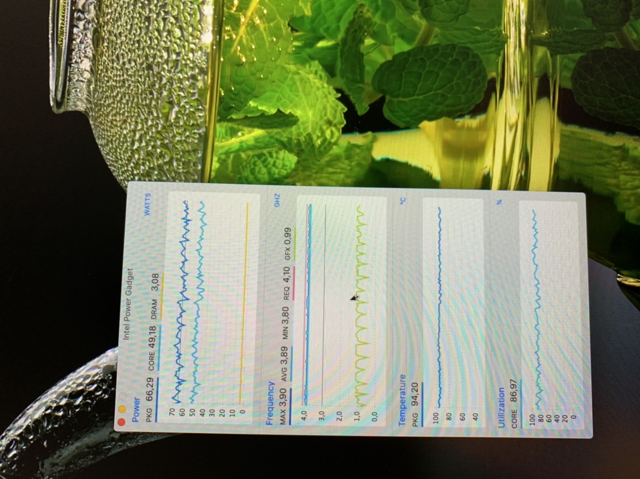

Hello! My work Windows laptop has Intels UHD620 (i5 8th gen) and it can’t play Youtube 4k/60fps or same with hdr. It stutters every other second.
Can the Mac Mini with its HD630 play 4k/60fps Youtube videos and same with hdr without stutters?
Okay, no answers? My i5 8gb ram Mini arrived today. GPU is at 80% when playing 4K HDR 60FPS video form Youtube with Chrome. So it is within its limits. But the i5 is not capable for it. RAM is ok for this one video, pressure is green.
Am I really needing to buy the i7 to be able to watch videos from Youtube?
(Dont know why the pic is side wqys, its straight in my phone)
EDIT: It seems that MacOS doesn't support Youtubes VP9 codec at the moment which means that basically all Macs stutter with their videos. So it is not because of bad performance.

I will try Firefox tomorrow. My tests were done with Chrome. So it is ”any other than Safari”. Why isn’t it in your list?
To be honest with you even on my 2020 10th Gen. MBP has a hard time playing back 4K60 videos. The fans will ramp up and the CPU will climb into the 90s. iOS 14 is getting VP9 support so I'm hoping the Big Sur will be next in line to natively support the codec.
It's not an ideal solution but you may want to look into setting up a Windows bootcamp partition for the time being.
I have Mac mini 2018 with i5 and 8gm ram. I use chrome for 4k videos. it plays everything fine without HDR. which is 4k @ 60 fps.
it plays HDR videos fine upto 1440p without stuttering but if its HDR @ 60 fps then only 1080p is smooth.
hope this clarifies some bit.
Eh? I am not sure I am following you.
Doesn't make a dent in performance playing at 4K in Chrome. Because most Youtube videos are using the recommended video codec H.264, for which Mac Mini has hardware acceleration.
Now, if you watch 4K and your resolution is NOT native 3840x2160 but scaled to some weird non-integer, then you may see the CPU kick in to recalculate.
If you are low on RAM, it may also affect performance. Because VRAM uses 1.5 GB of whatever you have installed.
