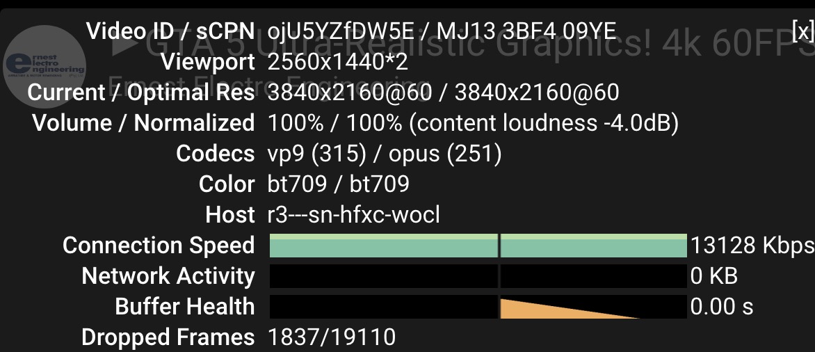

Click on this video, while running Chrome on macOS, put the resolution at 4K and fullscreen
right click "Statics" on YT to see if you drop frames. Then post here how many dropped frames you had, and your Mac specs.
Thanks!

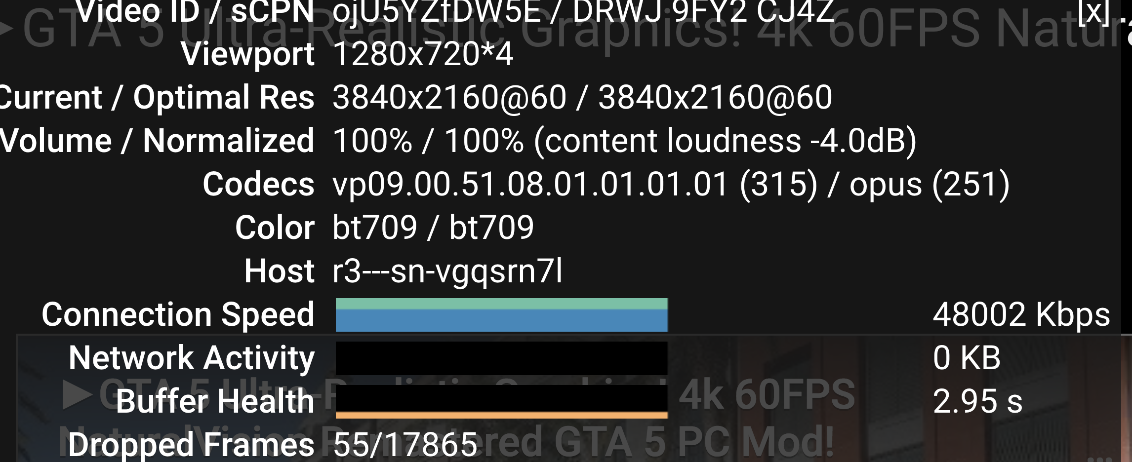

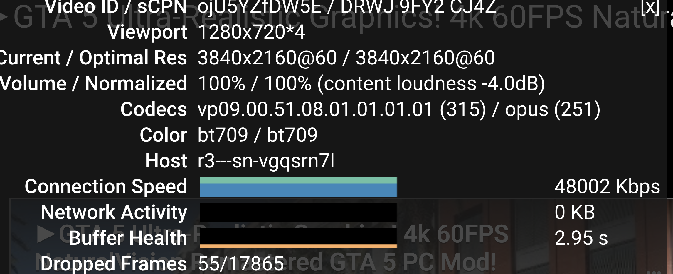

Late 2015 iMac 5K, M395, 24GB RAM
That's a very good question. Would love an answer from somewhere.
The reason is that VP9 (The codec that YT uses) is not supported by macOS, so Safari ignores the videos with that codec and if you try to use Chrome or even Bootcamp you will get bad performance as it needs to use Software decoder, instead of the Hardware decoder that intel includes in its 6th and above gen chipsets.

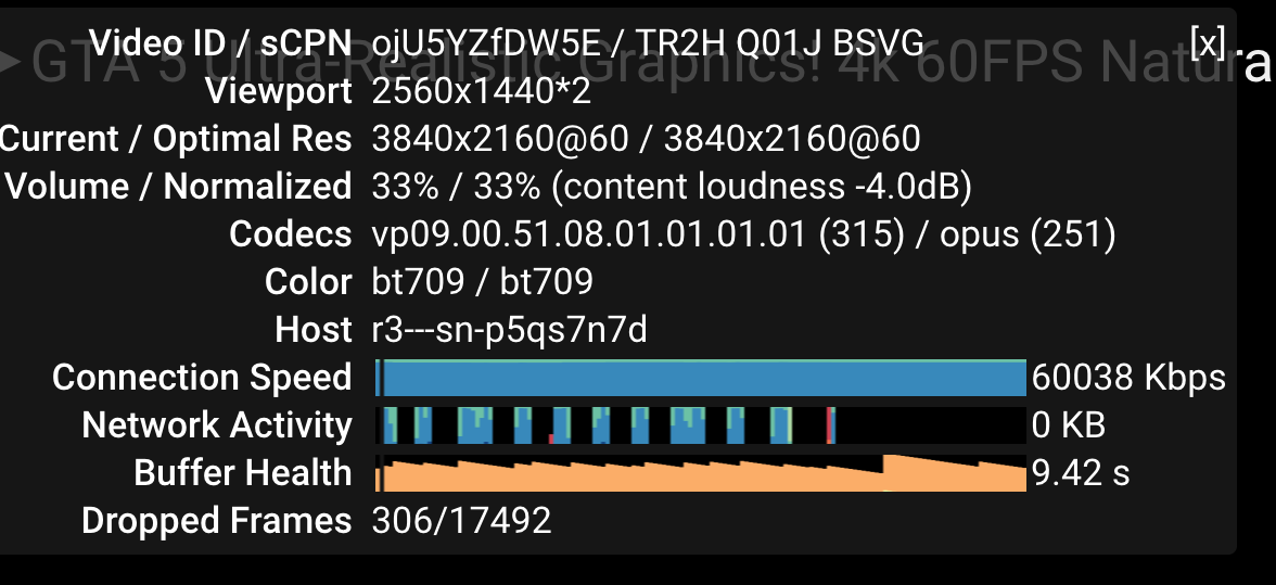

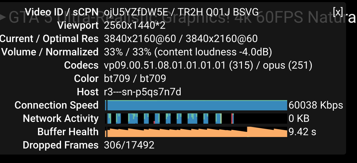

sigh, my mac sucks.
3.5 Ghz i5-4690K, m290x, 2014 imac 5k
no other programs running....
[doublepost=1528256631][/doublepost]I seem to remember, before high sierra came out, that it was possible to play 4k h.265 videos on a haswell with VLC, but an i7 was recommended, as playback would drop frames on an i5.
But then high sierra came out, and quicktime player has no problem playing such a file. Apple's good at optimizing stuff.

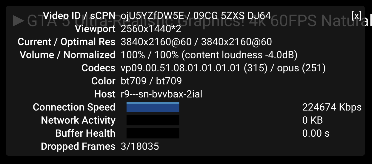

3 / 18035 - the 3 dropped frames happened in the first few seconds of the video.
3.8 i5 / RX580 / 24GB RAM
