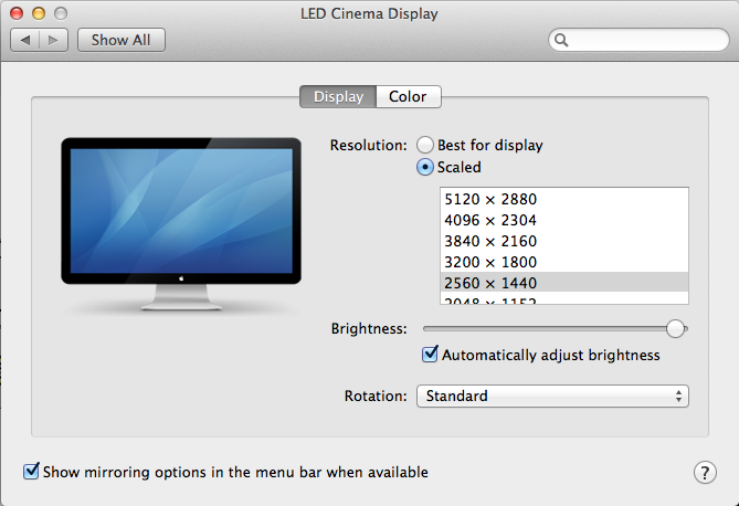

That may be true for Macbook, but not entirely true for desktop, my 2009 Mac Pro not even have thunderbolt 1, but can run 4k or even higher (up to 5160x2880).
And it support 4k 60Hz via the mini display port.

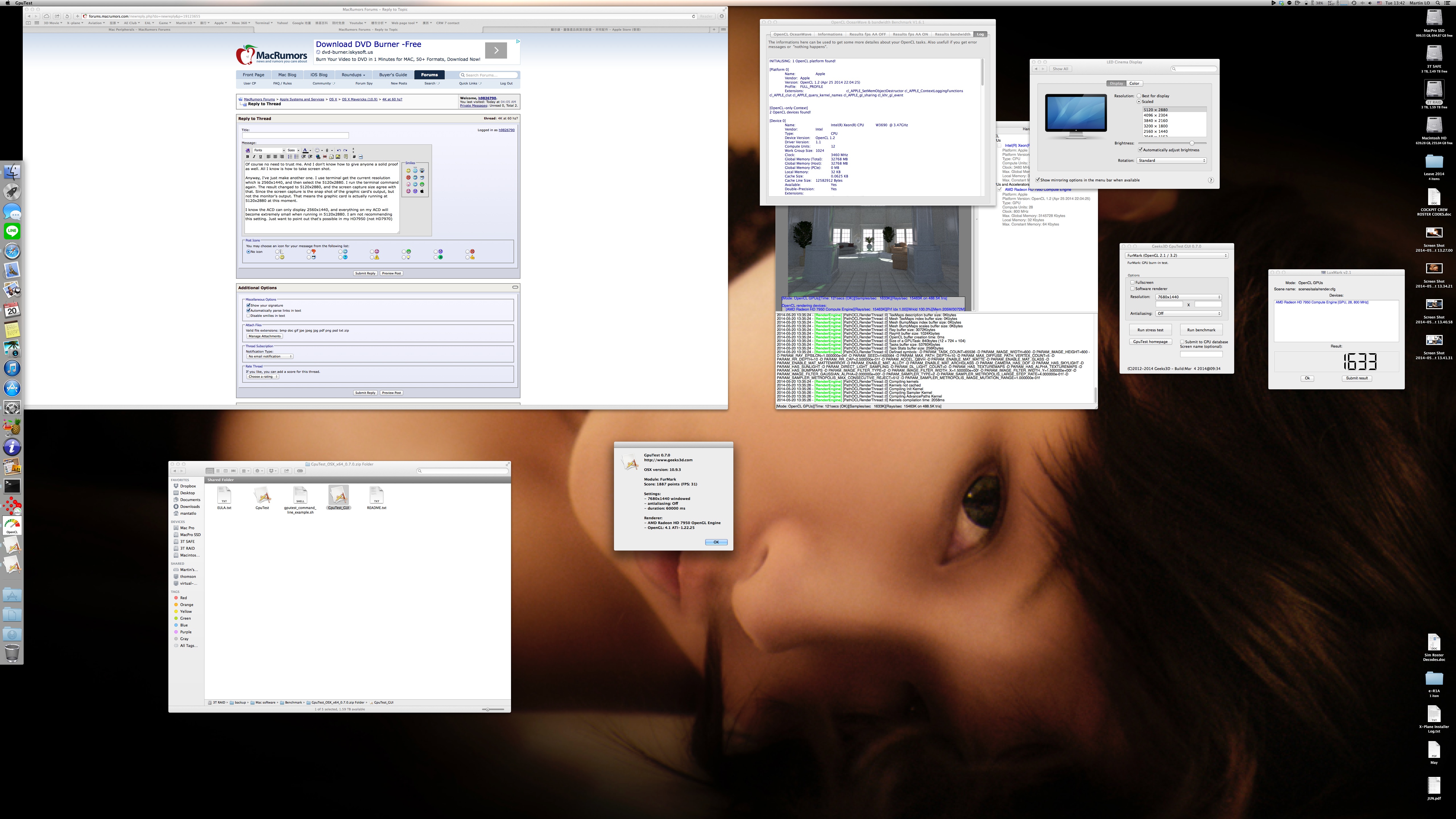

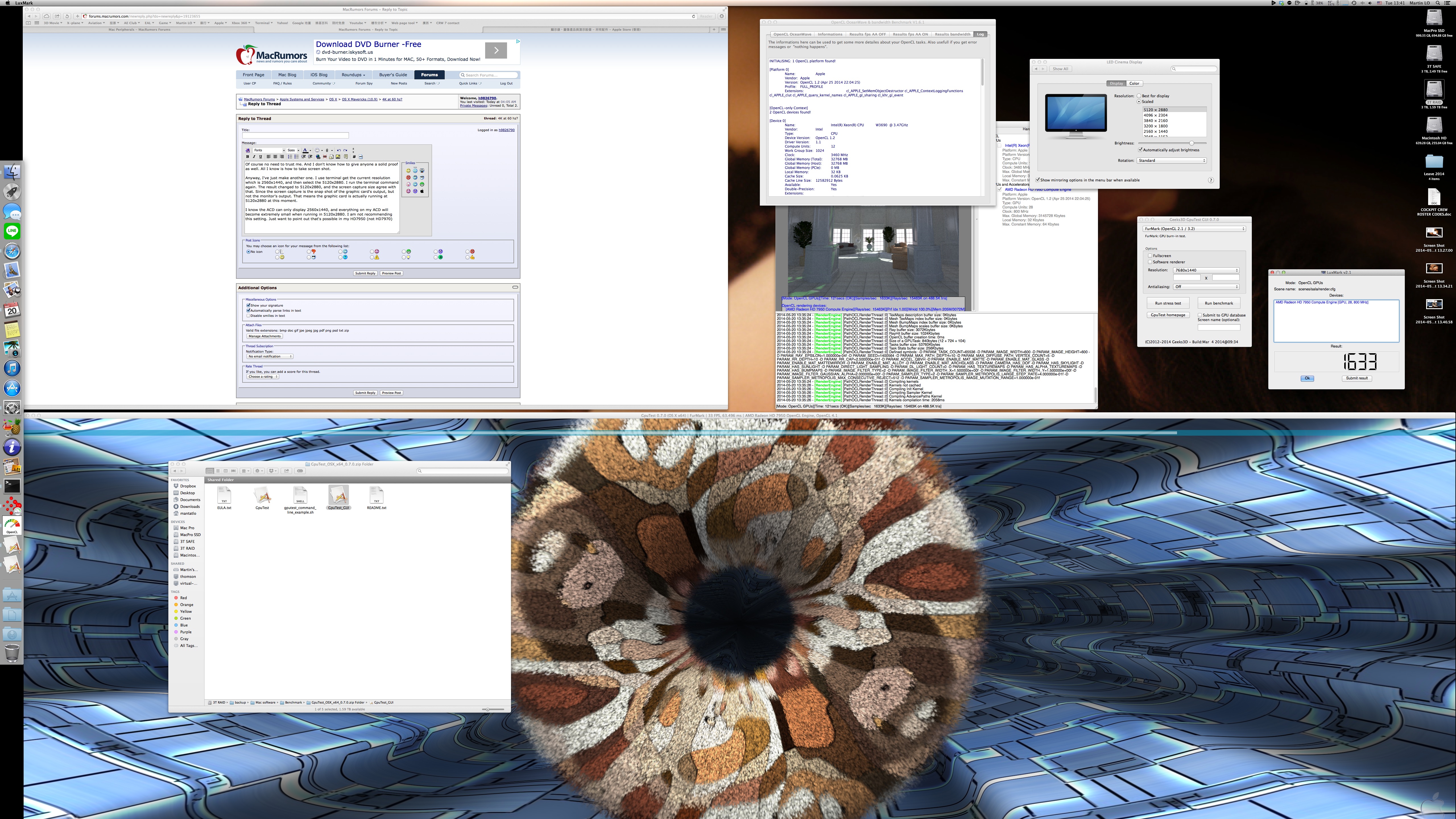

In fact, it is render at 5120x2880 and scale down to 2560x1440.
This is the screen capture, which is actually at 5120x1440.
And I can plug it into my 4K TV to enjoy the real 4K output. However, since I only use HDMI when connecting the TV. Therefore, I can only get 4K 30Hz. But there is no doubt that there is no absolute relationship between 4K and thunderbolt 2 in Mac.

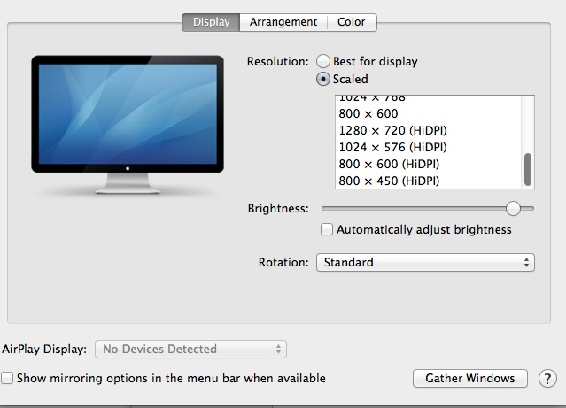

I installed Quartz debug to play around with the 720 HiDPI, most likely that unlock all these resolution to me.
This link may be helpful

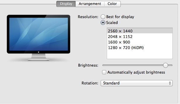

Yup, have had that enabled for a long time (I'm an OS X and iOS Developer, formerly Apple, Inc marketing/sales). I'm getting 60 FPS, but for both my 2012 27" LED LCD's, nothing above native resolution (2560x1440) is displayed. I have both Mini-Display Port monitors connected directly to my new 8-Core Mac Pro. Very odd. (thanks for the help!)

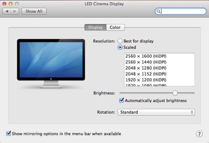

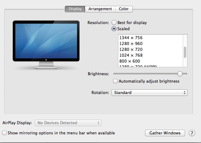

OK, Let's try another simple trick.
Hold down the "option" key, and then click "scaled".
This should unlock all the resolutions like this.

Ha, nice trick, never knew it. Unfortunately, nothing beyond my native resolution. There has to be something I'm missing. Been searching online, installed "SwitchResX", created a few custom resolutions, system wouldn't take 'em.

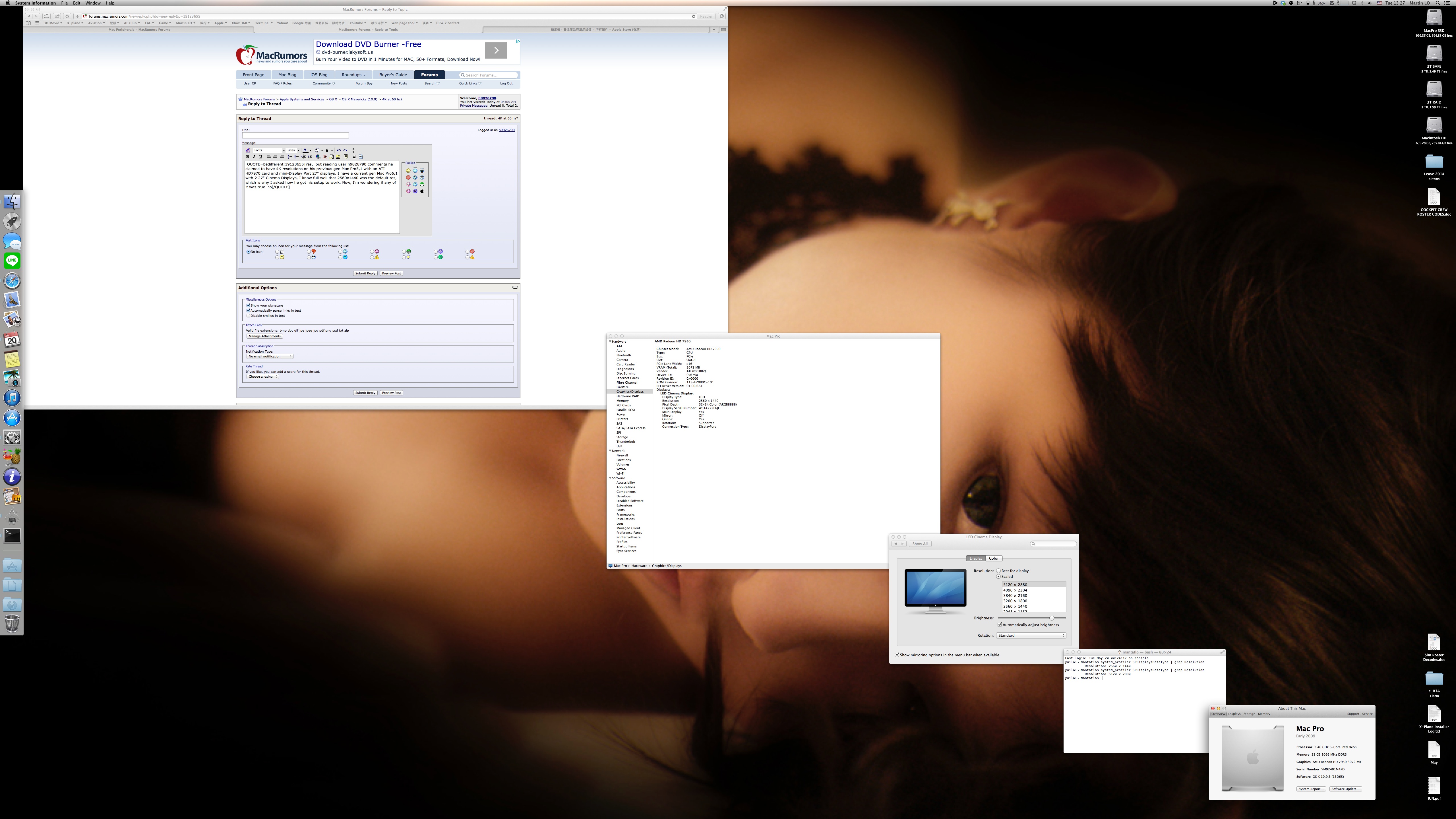

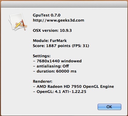

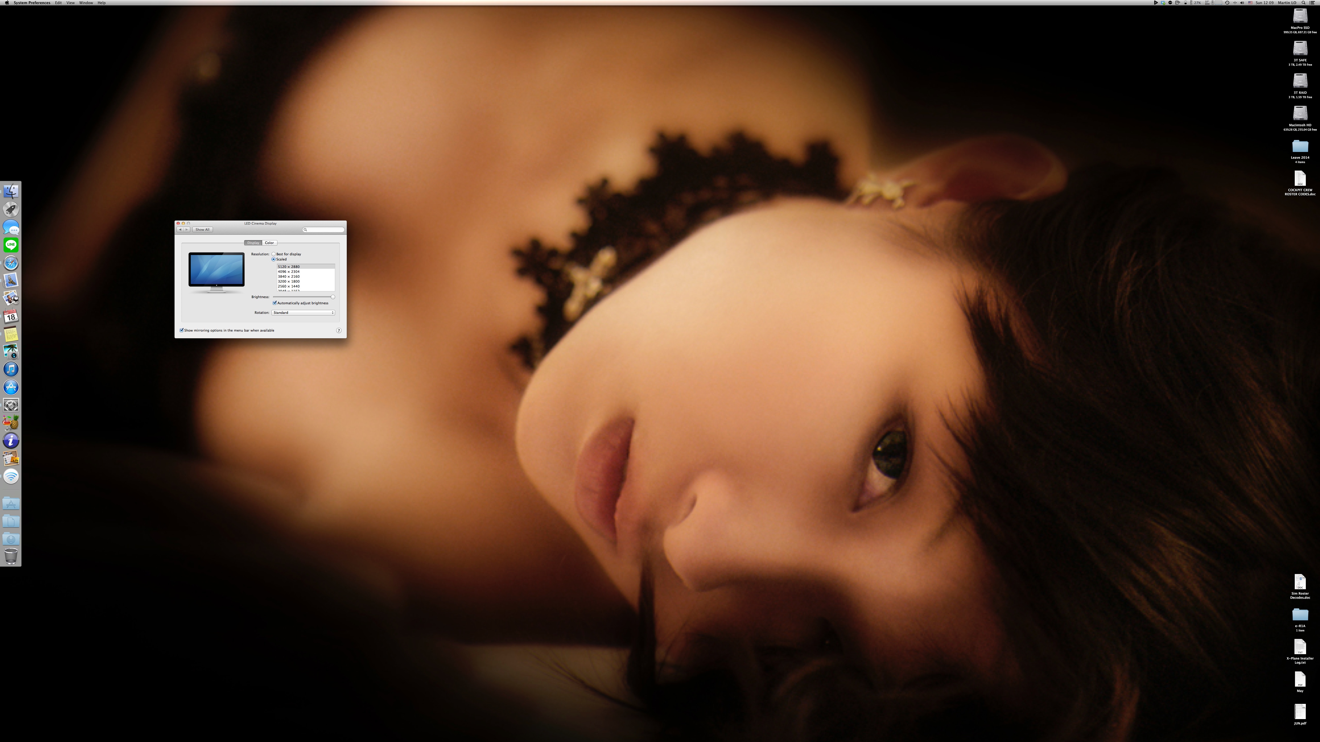

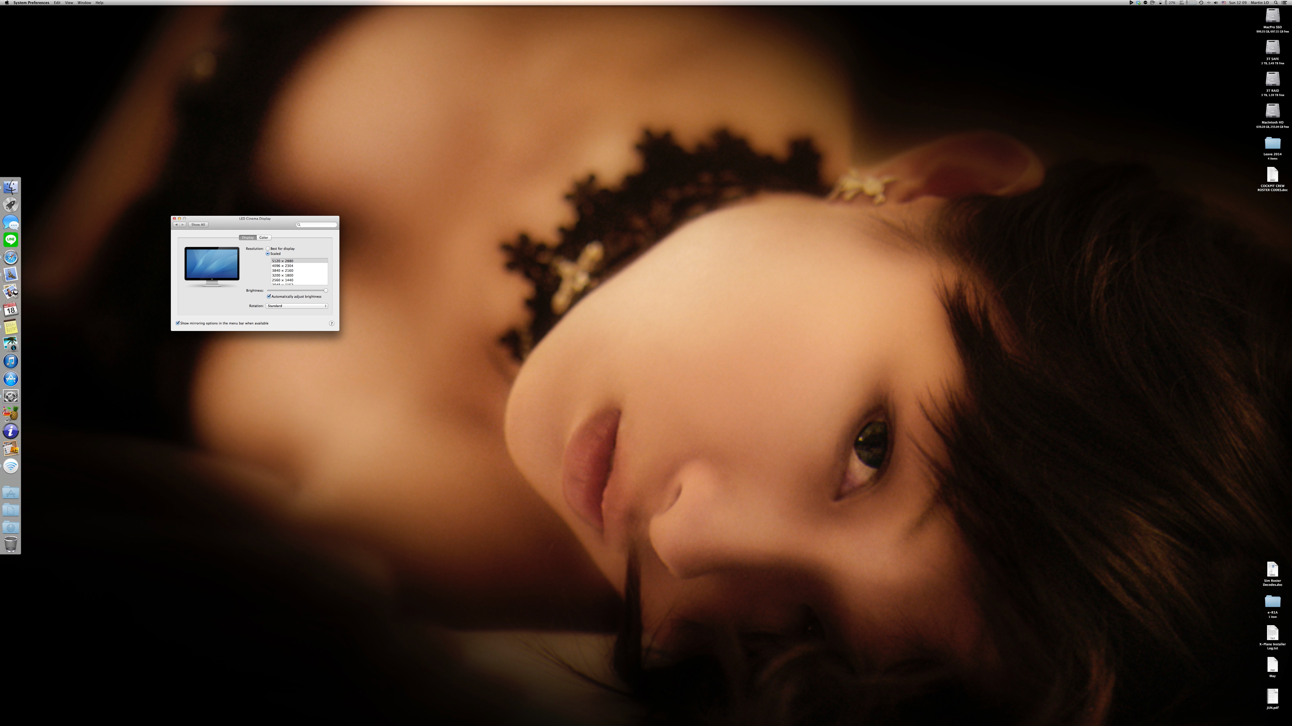

Anyway, I've just make few more screen shots. I use terminal get the current resolution which is 2560x1440, and then select the 5120x2880. I run the terminal command again. The result changed to 5120x2880, and the screen capture size agree with that. Since the screen capture is the snap shot of the graphic card's output, but not the monitor's output. That means the graphic card is actually running at 5120x2880 at this moment. Also, I can run the Geek3D GPU test 7680x1440.
I know the ACD can only display 2560x1440, and everything on my ACD will become extremely small when running in 5120x2880. I am not recommending this setting. Just want to point out that's possible in my HD7950 (not HD7970).
Anyway, here are the screen shots.
Screen Shot 2014-05-20 at 13.27.00.jpg Terminal shows that the graphic card running at 5120x2880
Screen Shot 2014-05-20 at 13.34.21.jpg Launchpad under 4K resolution.
Screen Shot 2014-05-20 at 13.41.31.jpg Running Geek3D GPU test with a 7680x1440 window.
Screen Shot 2014-05-20 at 13.42.03.jpg I do all these on my 27" Apple cinema display (not thunderbolt)
Screen Shot 2014-05-20 at 13.42.06.jpg The result shows the test ran at 7680x1440 windowed.
I wish you understand that I am not trying to fake anybody. This is purely for sharing. And I have no idea why the nMP 6,1 which should be more capable than my oMP 4,1 (Flashed 5,1) but do not have these option.😕
