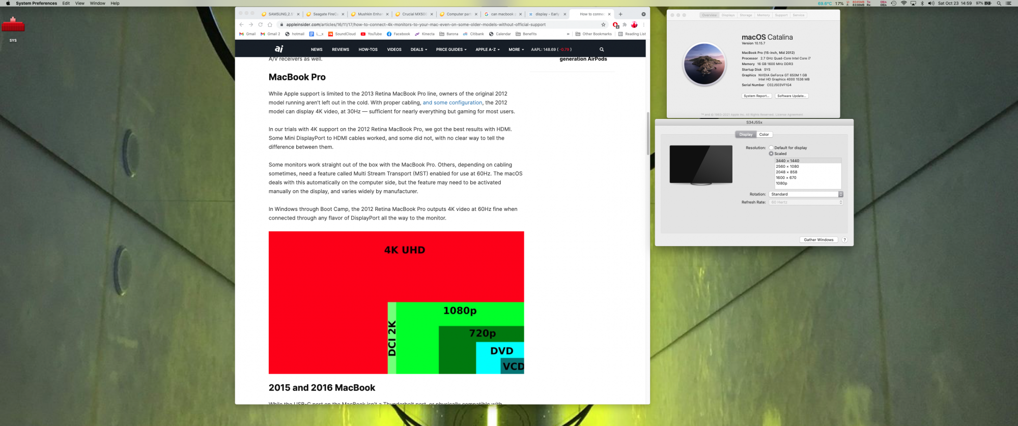

I have a new Samsung display WQHD 34" (3440x1440) @ 60hz working natively with my mid 2012 non-retina 15" macbook pro. It's not quite 4K but I'm going to assume full 4K would work. I had to use a mini display port to full display port cable to get the full resolution, HDMI wasn't having it. I'm running the latest Catalina update. Link to the cable I'm using. Some webpages can be a little laggy to load all the elements, i.e. Newegg, and I wouldn't streaming 4K content from Netflix doesn't look as crisp/sharp as I'd hoped, but is looking as crisp as I hoped, but no crashes or strange artifacts. I'd say performance is fine for general usage with apps and productivity, but since I don't game I can't speak to that use case. I'm just glad I can still get some life out of this 9.5 year old clunker.
