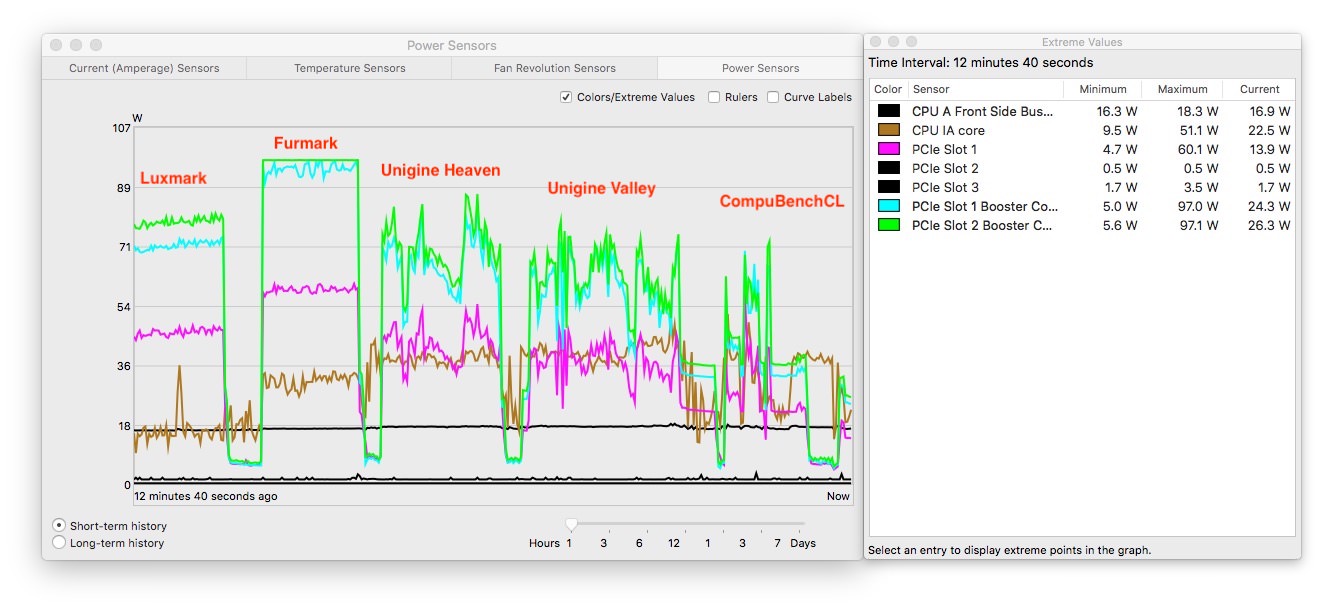

I am now running a 1080Ti with just the mini 6pins, no problem at all. Especially if your usage is video editing. It's demand is quite bit lower than 3D work.
This is the power draw test from my 1080Ti, TitanX should be more or less the same.
The video editing power draw should be similar to CompuBenchCL.
N.B. As you can see in the graph, the power draw strangely max at 97W, this is the display limit. The actual draw of the 1080Ti should be max at about 110W. But this should only happen in Furmark. Other "normal" high demand stuff Luke Unigine Heaven or Luxmark, can't even hit the 90W mark. However, I must emphasis that I do balance the load between the two mini 6pin. If you connect one mini 6pin to the 6pin, the other one to the 8pin, but not mixing them together. The 8pin will draw way above 100W and most like sufficient enough to shut down the Mac Pro under stress.
