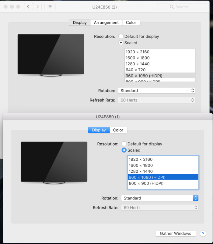

After an update 960 x1080 HiDPl mode showed up. So Times 2 this is same number of pixels as 4K my question is why is this locked out with a single cable. Does using two cables put less strain on the graphics card ?
On OSX there is contrast between the left and right screens
I don't know if this is because I am running HDMI and Display port vs 2 Display port cables I have to run 60 / 100 Contrast for web browsing on OSX for the white backgrounds. Playing video I needed to set the Contract to 52 / 100 but I could still see the line between the two desktops.
