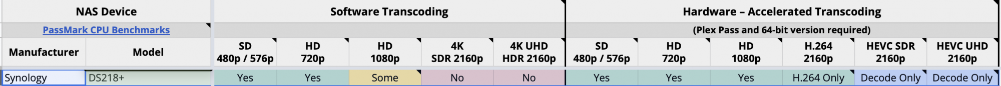

Your NAS (4k30fps max with no HDR 10-bit)

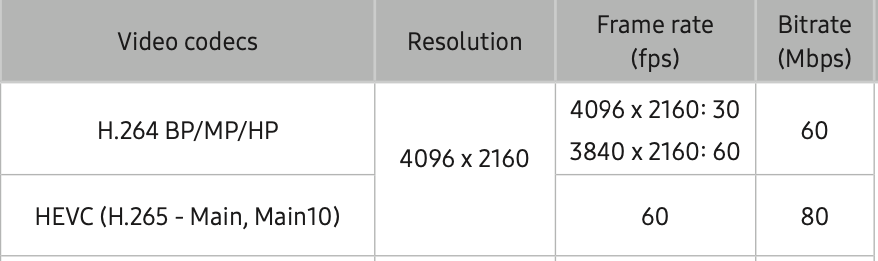

Your Samsung TV on the other hand has the hardware for 4kHDR decoding.
Your TV (4k@60fps max Main10 - HDR 10bit)

I wonder if hardware transcoding isn't being used on the DS218+.
Not precisely sure what you mean. If you mean in context of this thread then I think yes, which is the problem. HDR's 10bit spec (OP video) exceeds the hardware decoding capability of the DS218+ thus causing poor performance.
The Plex matrix I posted above lists the DS218+ as being able to do hardware decoding of 2160 UHD. Isn't that 10 bit HDR?
Not necessarily. UHD can also be in AVC or HEVC 8-bit Rec.709 (ie SDR).
UHD and HDR just tend to be marketed together lately.
HDR itself is also frame-size-agnostic. Just needs to be HEVC-encoded.
PS incidentally aTV 4 (the fullHD model), is cabable of decoding 8-bit HEVC 1080p (SDR) without problem since tvOS 12.
Technically yes, but technically anything can play 4k 10bit HDR if we leave out a variable or two.
If you hoover the mouse over HEVC UHD 2160p on your chart it defines the variables a bit.

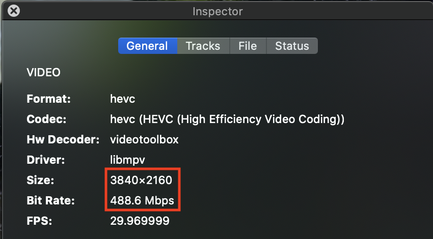

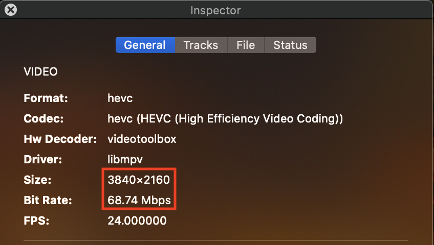

Main 10 is the HEVC/h265 profile used which is a 10 bit color depth (rec2020 colorspace) w/ 4.2.0 chroma sampling profile. UHD resolution 3840 x 2160 with average bit rate of 60 Mbps. As long as those specs aren't exceeded the video will decode in real time.
So using bit rate for example, these are both HEVC UHD 2160p 10-bit videos.
A video like this might play perfectly fine since scenes below 60 Mbps will let the decoder get ahead to not effect playback when its goes above 60 Mbps.

While videos like this will freeze and stutter since the decoder won't be able to maintain a buffer.
Main 10 will also have a "level" that accompanies it. The profile and level would define the capability of the decoder to playback video. This allows content creators, devs, content streaming services, etc to know the capabilities of the decoding device without actually testing each one for compatibility.
