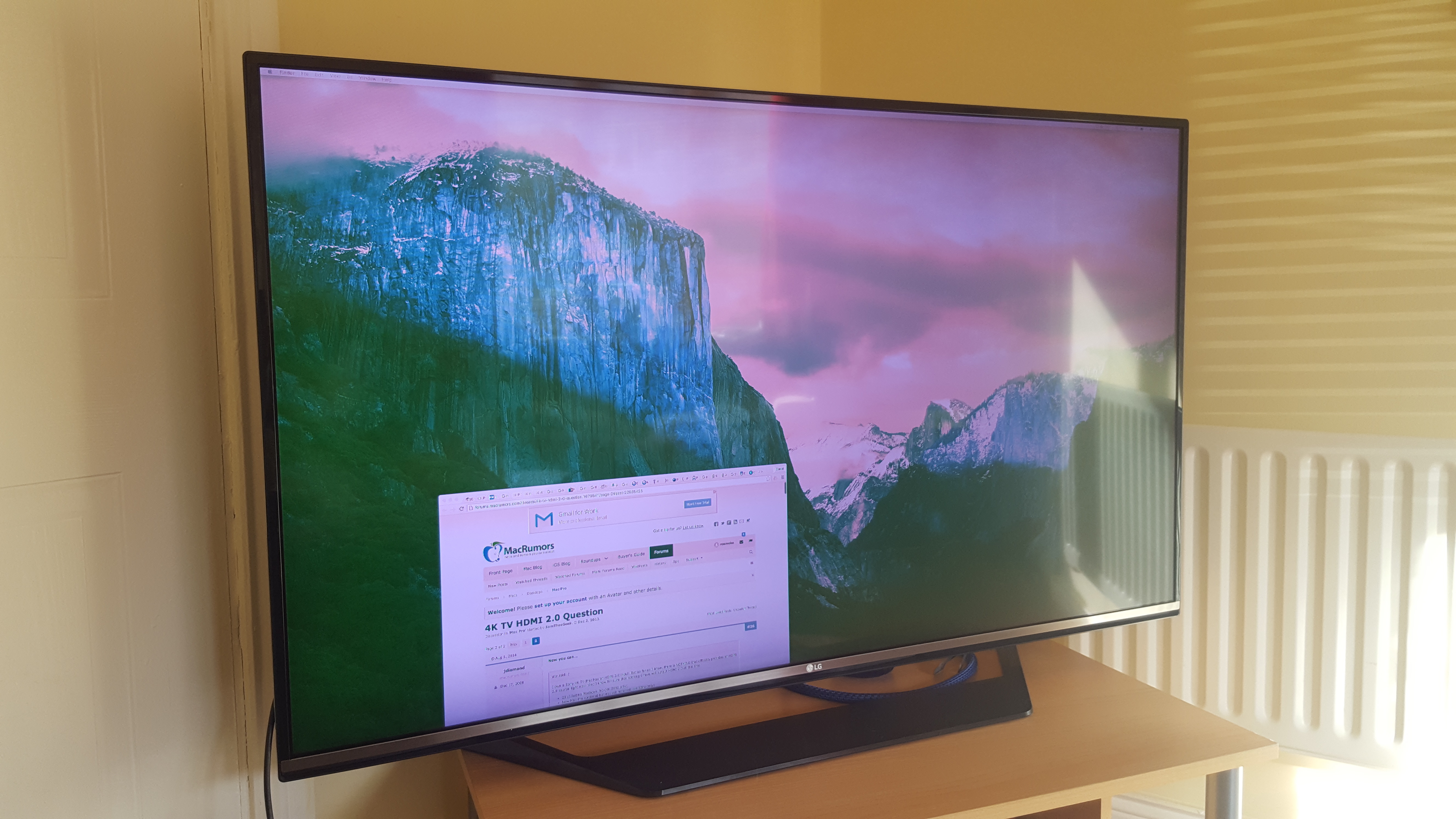

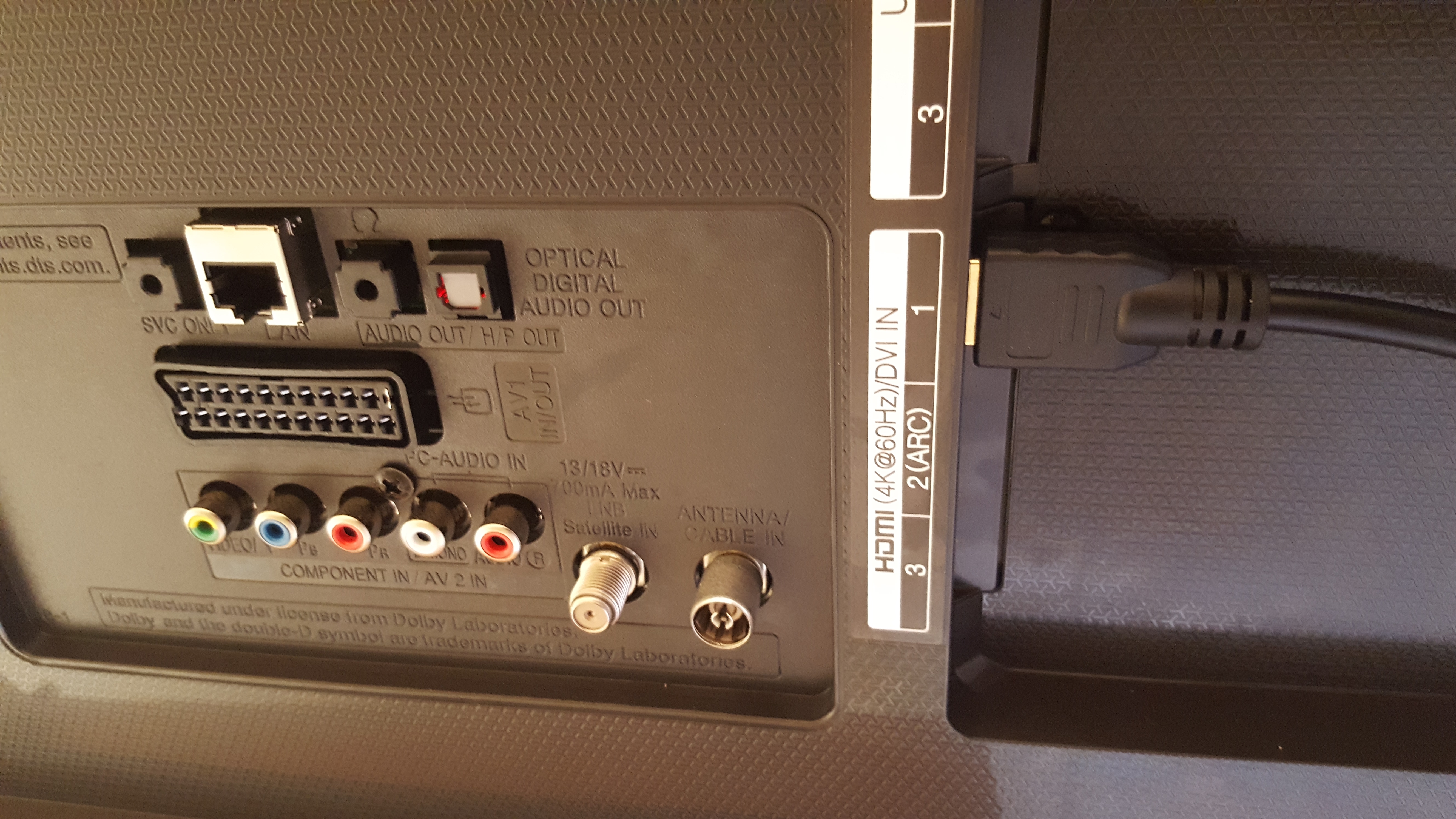

I just bought a Mini DisplayPort 1.2 to HDMI� 2.0 Adapter CAC-1170. My setup consists of: a Late 2013 Macbook Pro 15" capable of outputting 4k@60hz through DP1.2 port & LG 55" UHD TV capable of getting 4k@60hz through hdmi 2.0 (it's written on the actual hdmi port) & HDMI 2.0 cable capable of 4k@60hz. However the maximum I get is 4k@30hz, what can I do ? I'm starting to lose my mind 🙁

Thanks for you very much for your reply.

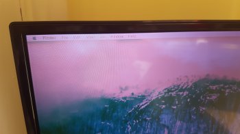

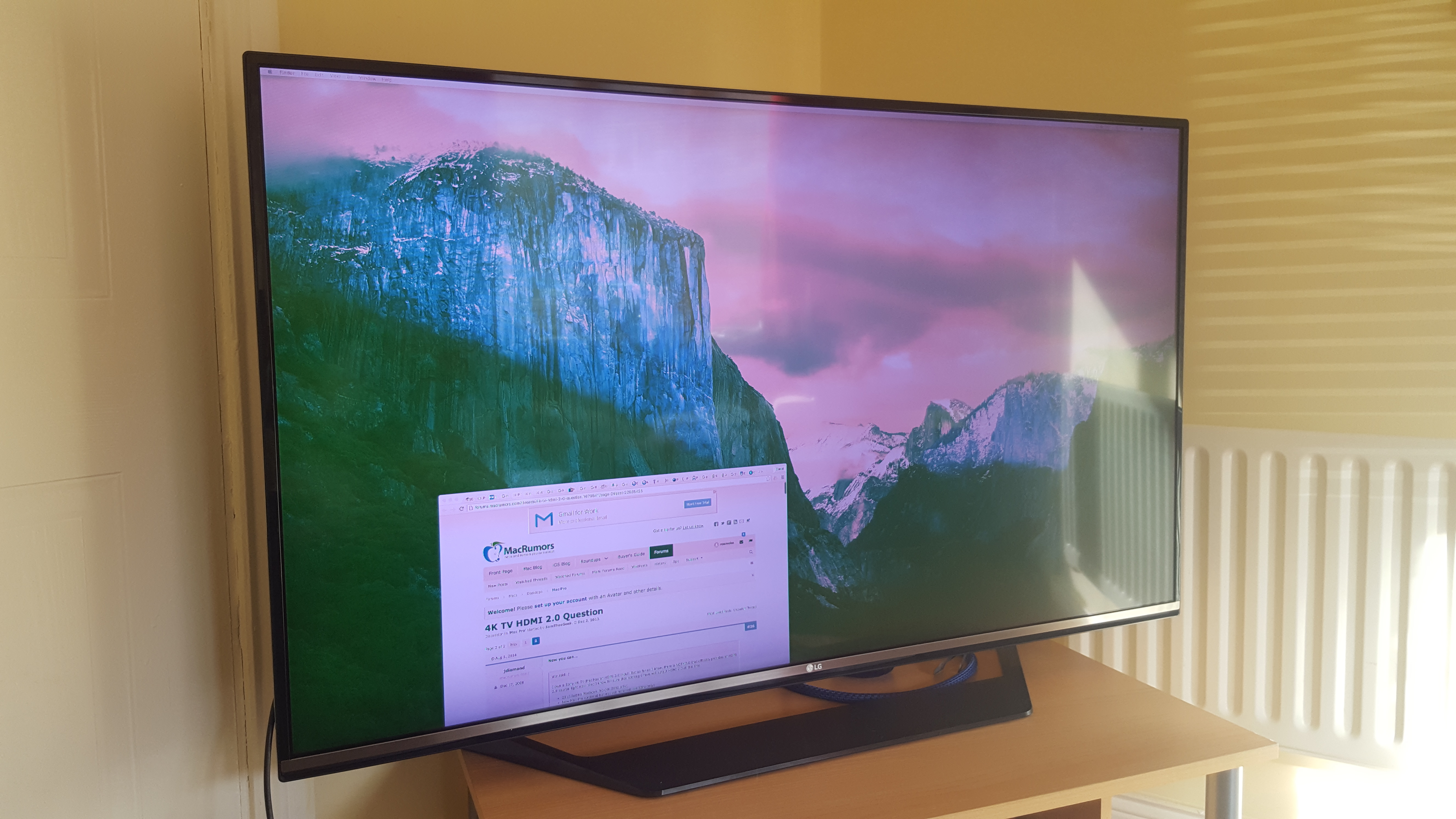

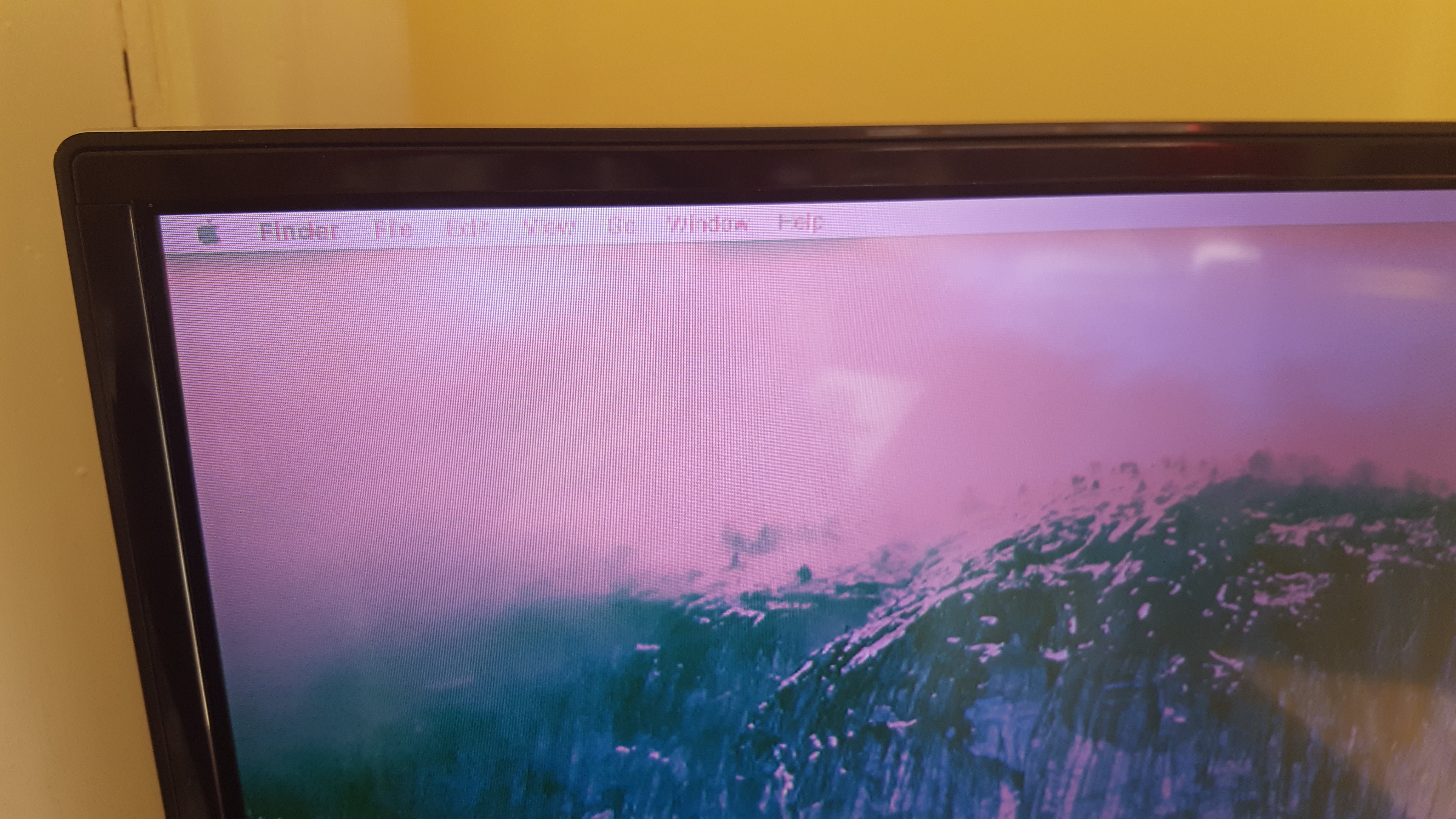

That's exactly what I've done but the TV screen goes pink / green, the colours are messed up 🙁
What computer and what display do you have if you don't mind me asking?
LG uf770V 55"
[doublepost=1462038022][/doublepost]This is how the screen looks like when it runs 4k@60hz.

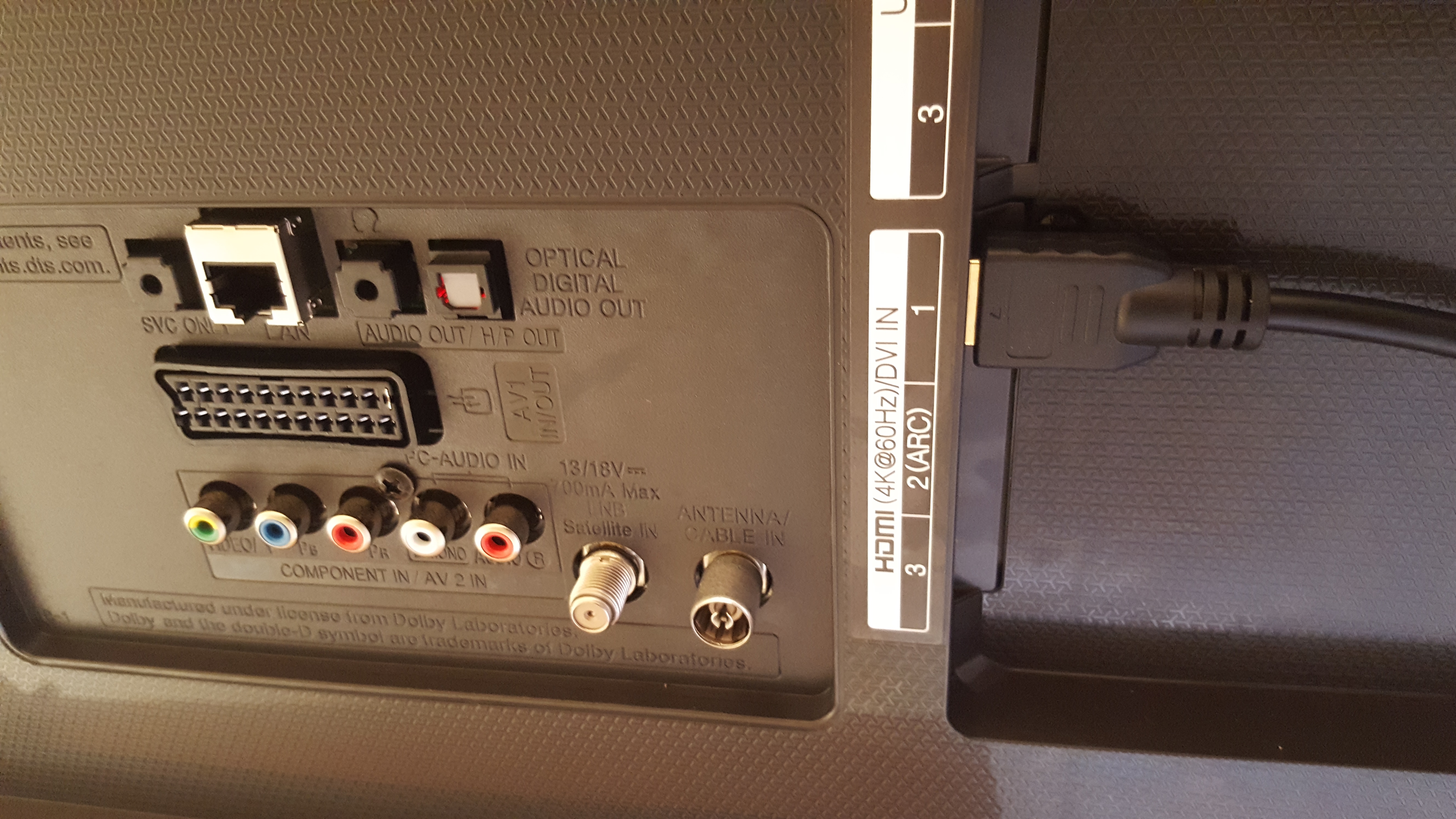

Many TV manufacturers (Sony, Visio, LG, Samsun) are labeling their HDMI ports as 4k at 60Hz which are NOT HDMI 2.0 capable, actually it is HDMI 1.4 🙁 They will display 4k at 60Hz but with color scheme 4:2:0. not 4:4:4 as HDMI 2.0.
Can you try to change the color scheme to 4:2:0 with SwitchResX???
