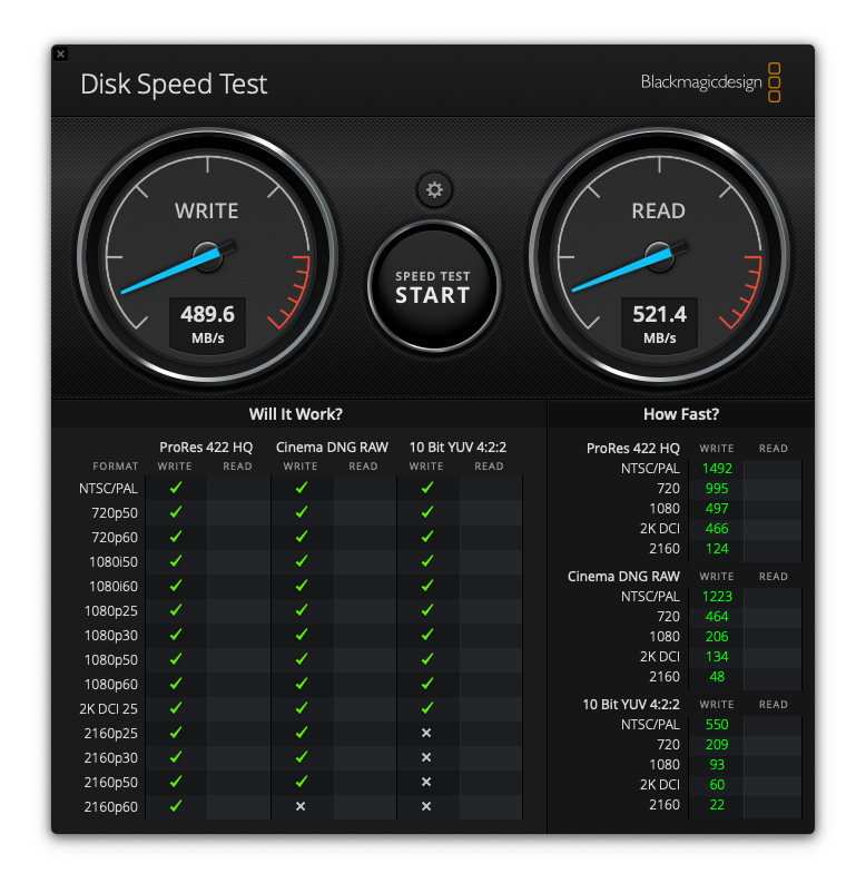

SATA SSDs like the 860 evo go way above 150MB/s write. Here's my 500GB model.
