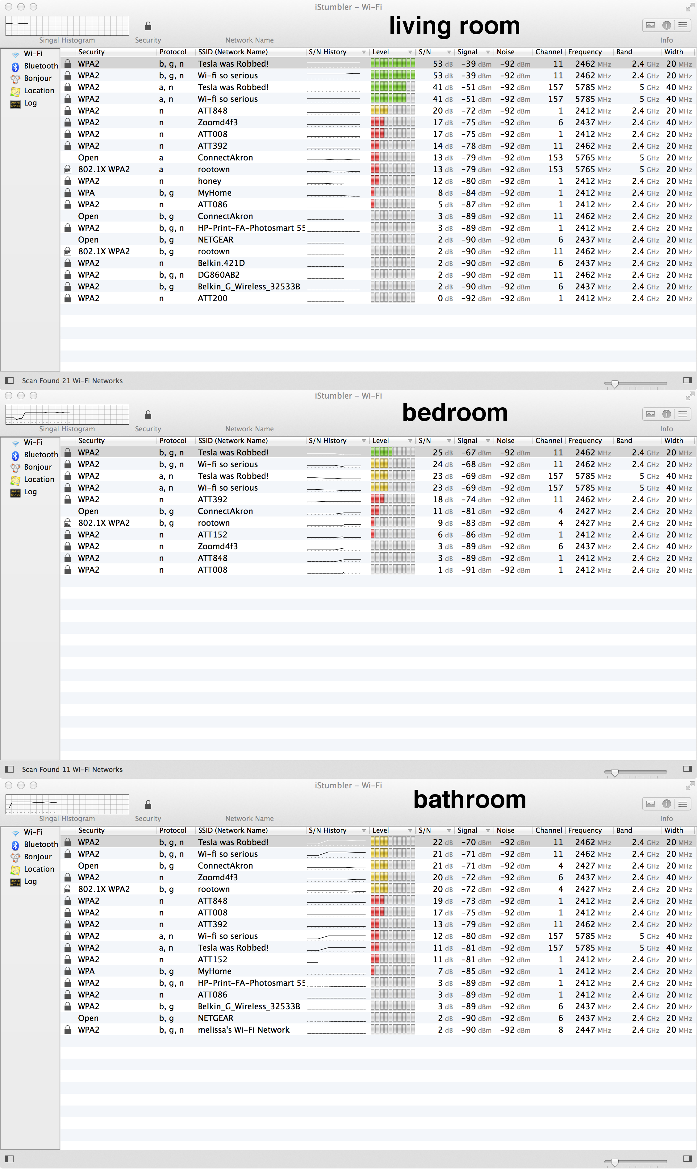

I recently moved into a new apartment in a 90 year old building and my coverage from my router, in the living room, is really terrible. In our previous place, which was less than 10 years old, the router would reach every floor, outside, and into the garage. In the new apartment, we can barely reach the bathroom and bedroom only 30 feet away. Our iPhones performed far worse than my rMBP used to test this.
The router is on a tv stand, but not in the cabinet with the other equipment. it is out in the open.
I know it is best to have a router central to the dwelling, but considering our apartment isn't very large, at least not compared to the house it covered so well before, I am amazed by its poor coverage. Is my airport finally dying?
note, my networks are "Tesla was Robbed!" and "Wi-fi so serious?"

How thick are the walls and what is in them? In an old school that I do AirPort in, I have an AP Express in the ceiling every 50 ft. to cover the rooms.
measuring at the trim between the rooms and subtracting an inch on each side for moulding, it looks like 7 inches.
Looks like you have a fair amount of competing neighbor signals -- how does that compare to your previous place?
We had fewer signals, but much stronger. Here, they are pretty weak overall, leaving plenty of weak space for me. Remember, four of those are mine (telsa was robbed and wifi so serious)

I would try resetting the base station and setting it back up. When doing that, use AirPort Utility 5.6 to enable "Use Wide Channels". Also you may want to leave the SSIDs for the 5 GHz and 2.4 GHz unified. If not you may want a newer router. Just because it is 7 inches thick doesn't mean some engineer didn't not think to make the entire frame out of metal. Also, double check you have 7.6.4 if appropriate for a 4th gen. as it fixes some issues.
4th gen airport extreme poor range
I'm on mavericks. 5.6 isn't an option for me. Everything is up to date and I expect there is wire mesh behind the plaster on these walls.
