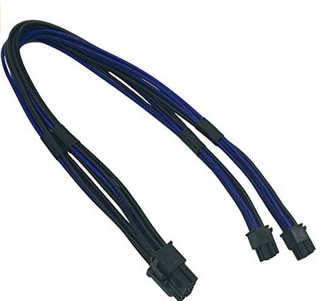

Just to be clear on your RX 580 power cable setup.
The correct cable for the RX 580 ..
TWO x Mini 6 pin from the Mac Pro motherboard to ONE by 8 pin to the RX 580's 8 pin socket
( Amazon.com https://www.amazon.com/COMeap-Express-Video-Adapter-15-inch/dp/B07J336WY4
Does your cable look like this . . .. ?
