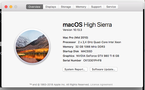

I've installed eVGA GTX 980 Ti into my mid2010 5,1 mac pro. Both power sockets are connected. 32G RAM, 2x quad-core xeons. With 2x 4k displays working in 2k mode (2560x1440) desktop rendering speed (chrome, slack, basic apps, whatnot) is very sluggish. Games work well, just that the desktop lag is horrific. Even when scrolling in a single long page in chrome I can see pieces of the page render with my bare eye.
My MBP mid-2015 with stock video card performs better.
Latest web driver is installed, so is CUDA.
What am I missing?

System Version: macOS 10.13.3 (17D47)
Kernel Version: Darwin 17.4.0
Boot Volume: MACSSD
Boot Mode: Normal
Secure Virtual Memory: Enabled
System Integrity Protection: Disabled
Time since boot: 17:59
387.10.10.10.25.156 for 17D47 already installed
CUDA: 387.128

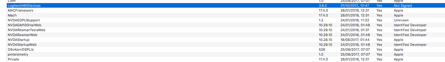

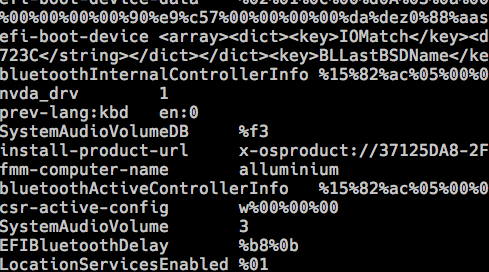

It looks like hardware graphics acceleration is not working. In my experience the behavior you are seeing is that typically the Nvidia driver is either not installed, not running, or not selected. The only reason why you are seeing a screen at all is that MVC flashed Maxwell cards work with the fallback software rendering mode, which is very laggy just like you are experiencing.
1. Check to see if the driver is installed and running. System Information, Software, Extensions.
2. Check your NVRAM settings to ensure that the Nvidia web driver is actually selected. (There have been 2-3 people here who found out that the driver is not selected even though it shows as selected in the Nvidia Preference Pane). In Terminal:
nvram -xp

This looks like it's loaded.
This also looks legit..
