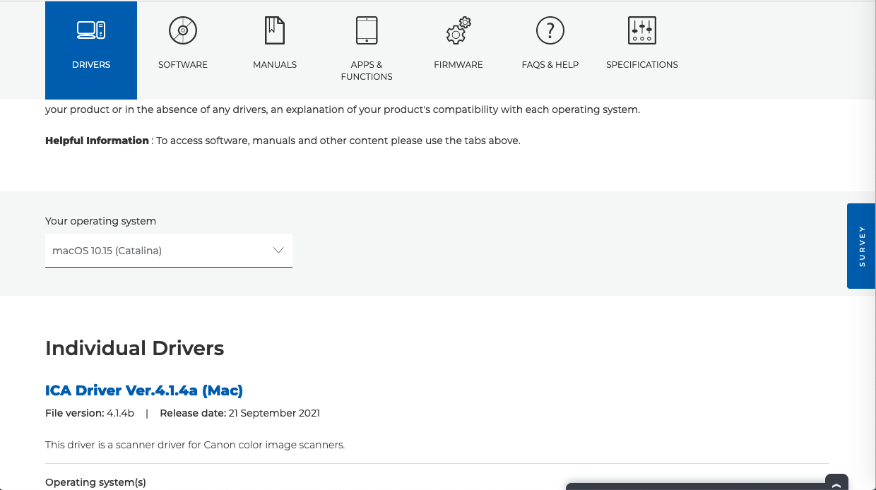

I'm inclined to think that is just an issue of drivers not available for the macOS release you are testing now, since scanners depend on drivers/kexts. Some are only supported up to a determined macOS release, looking with Cannon support, Lide 110 works up to Catalina:

The Canon Lide 110 is pure USB powered. No other cables are involved. Sad to hear that it became obsolete with OS Catalina. Just out of curiosity, what USB webcam works with Big Sur or Monterey on a 5,1?
Easy to solve, have a disk with Mojave, or something else that still supports it, and a powered hub. Boot it when you need to scan something.

Thanks for the tips on Canon scanner and Logitech camera. As for the latter, I found a C615 for a few bucks on ebay and it works fine with USB 2.0 powered hub. My next project is downgrading from Big Sur to High Sierra that will recognize the scanner. If not, I'll explore VueScan.
