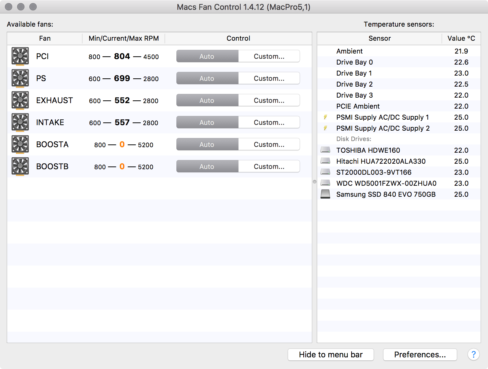

I recently bought and installed X5690s for a dual CPU Mac Pro 5,1. I haven't had any issues previously with it and was running two x5670s. However, the fans are running at full speed and utilities like Macs Fan Control are reporting 0 RPM, and missing senor data. The computer boots and I can hear and feel the air on the CPUs.

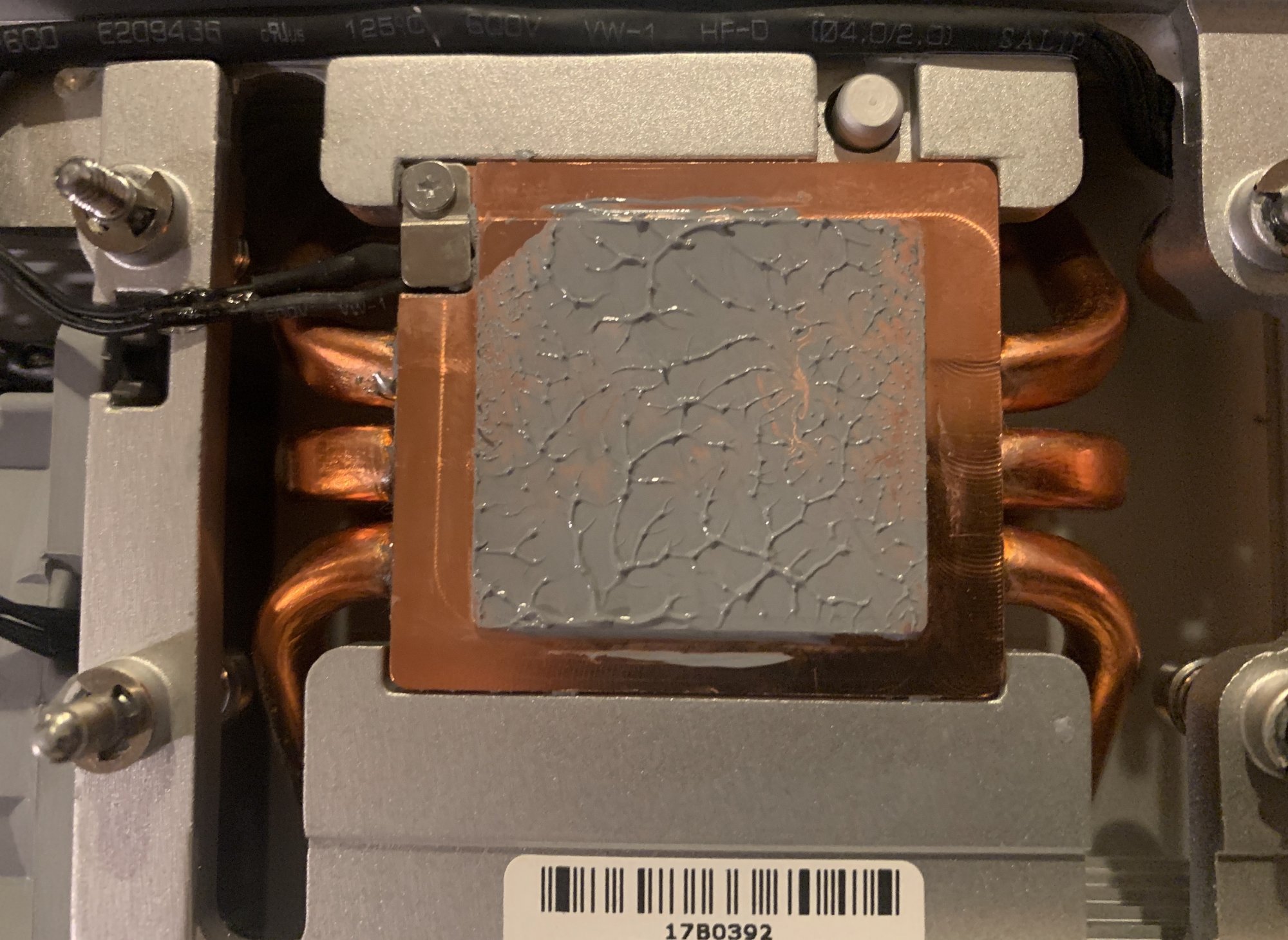

Looks like I edited this as you replied with the link to the same thread. Both look like the above photo. Looks right to me.

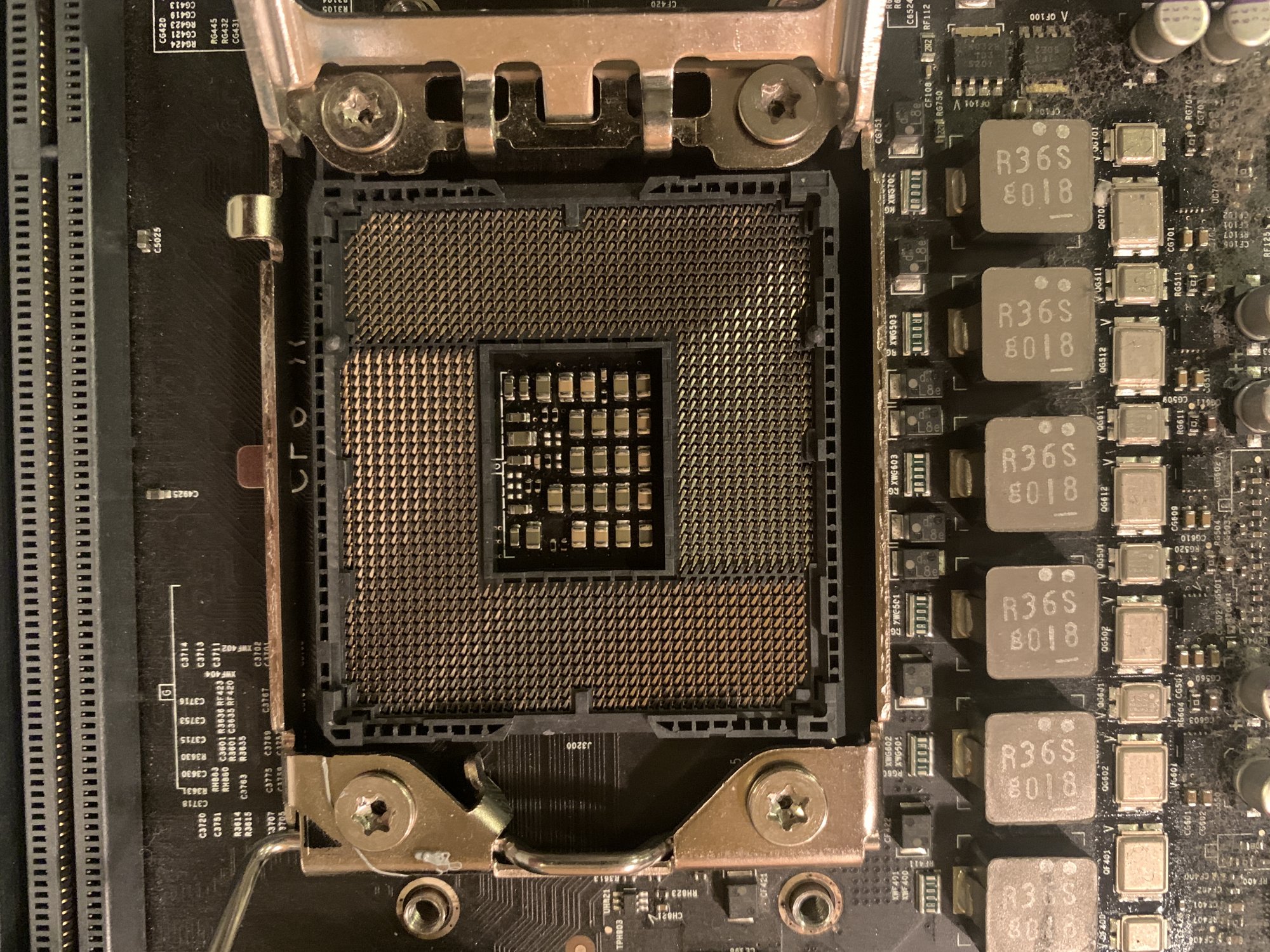

Here's one of the two CPU sockets, and I don't see any bent pins I took last night when I was checking for bent pins.
