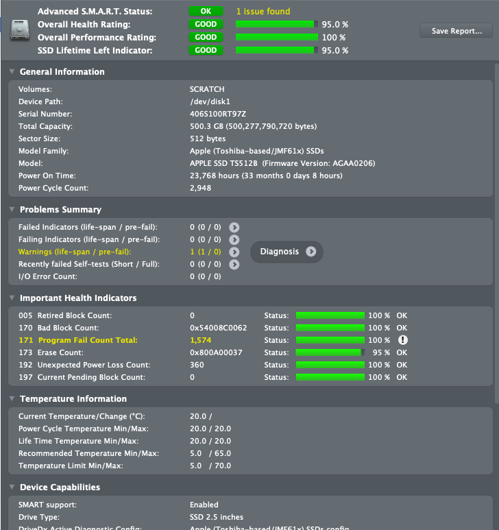

First step is to download Download BinaryFruit DriveDX and check if your SSD is not failing.
If it's ok, maybe test with other slot/bay.
Thanks for the reply tsialex - I've loaded up DriveDx, and the only error it's showing is the Program Fail Count sitting at 1,574. Not sure if that's a sign of total failure or not.
And interestingly, I had the QVO in the dvd SATA ports when it failed, and the current drive is in Slot 1...
Program Fail Count errors show that you can't write to the NAND cells correctly. Try another disk, not the QVO, and check if you get normal speeds.

Did you run the DIAGNOSIS option by clicking that under PROBLEM SUMMARY?
Certainly looks like an SSD I would replace based on that error.
hi bsbeamer, diagnosis just offered that a lot of failures had happened, but no more details. I'll be offloading from this SSD shortly..
