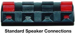

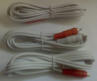

The device you listed: http://www.amazon.com/Digital-Analog-Audio-Decoder-Converter/dp/B0057UNPVO/
is in effect a mini-receiver without an amplifier. The difference between it and a proper receiver is that it comes with mini-plug connectors for PC (surround) speakers like your Creative's which have their own amplifier built in.
An actual receiver would require you to have some proper hi-fi connectors (terminals) instead of mini-plugs and would provide an already amplified output. The speakers wouldn't have their own amplifier. You wouldn't be able to connect hi-fi speakers (real speakers) to the mini-receiver above). However Creative's amplifier integrated speakers will work with the 'mini-receiver'.
THis is what a real receiver will use to connect to speakers:
The mini-receiver comes with three of these (what your Creatives need):
So it would work.
The device has connectors like these:
So it accepts a pre-encoded surround signal via optical/coax and outputs 3 analog mini-plug outputs.
