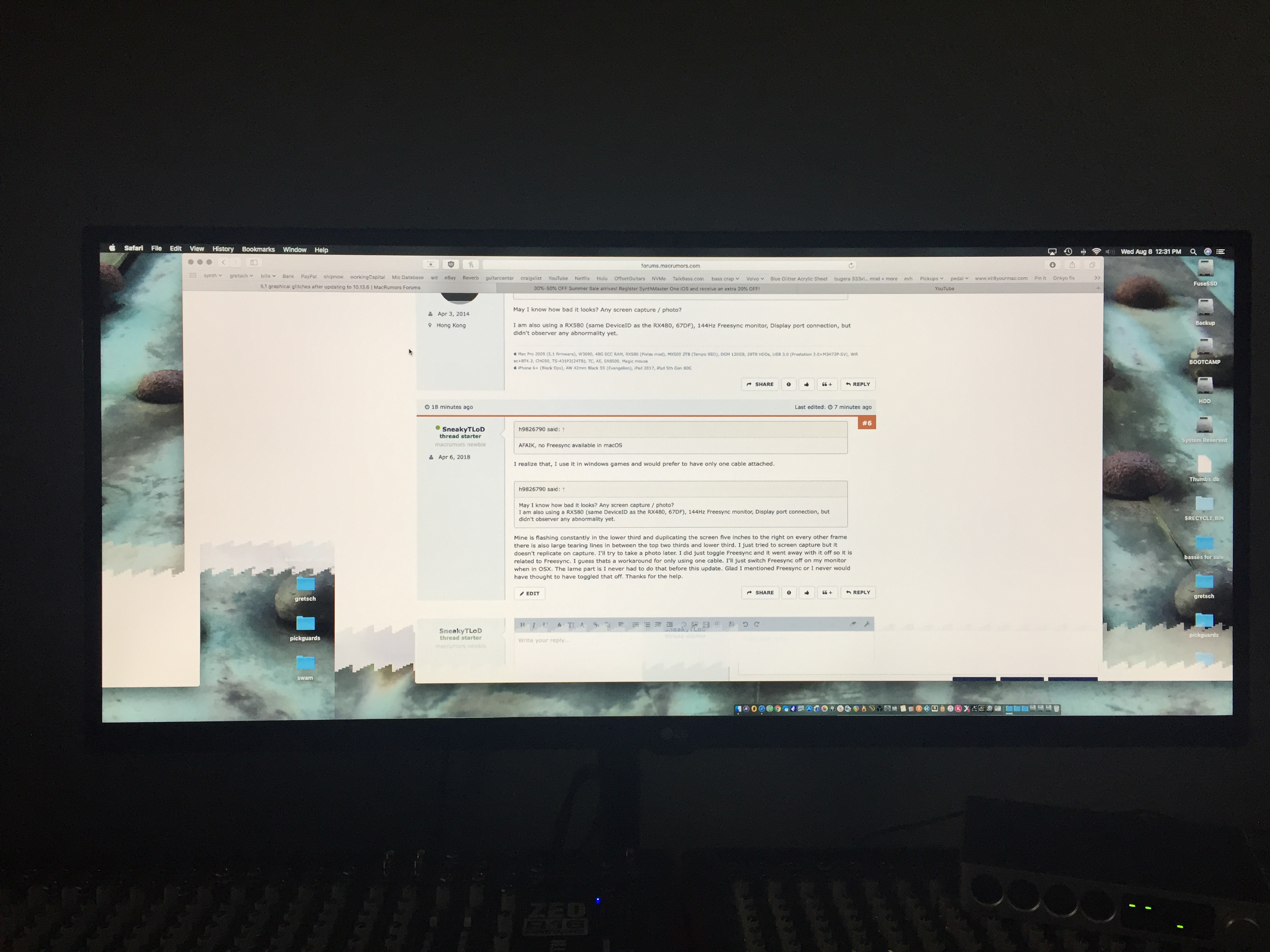

Ok so after updating my 5,1 with RX480 to 10.13.6 I started getting bad graphical glitches on the bottom third of the screen with display port. It was working fine before the update and is still working fine with the HDMI. I guess I'm ok with sticking with the HDMI but will need to get a newer cable to be able to enable Freesync. Has anyone else run into this? Any ideas on where to start?

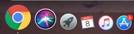

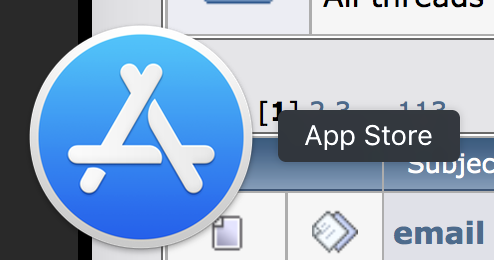

I also have a RX480 Nitro and updated last week to 10.13.6, and I alsno noticed that notification icons in the dock and the chrome logo looks terrible, before 10.13.6 this was not happening.
My display is also connected via displayport, and my monitor has 144hz and freesync support. However changhing the Hz to 144 does not make a difference in the icons.
May I know how bad it looks? Any screen capture / photo?

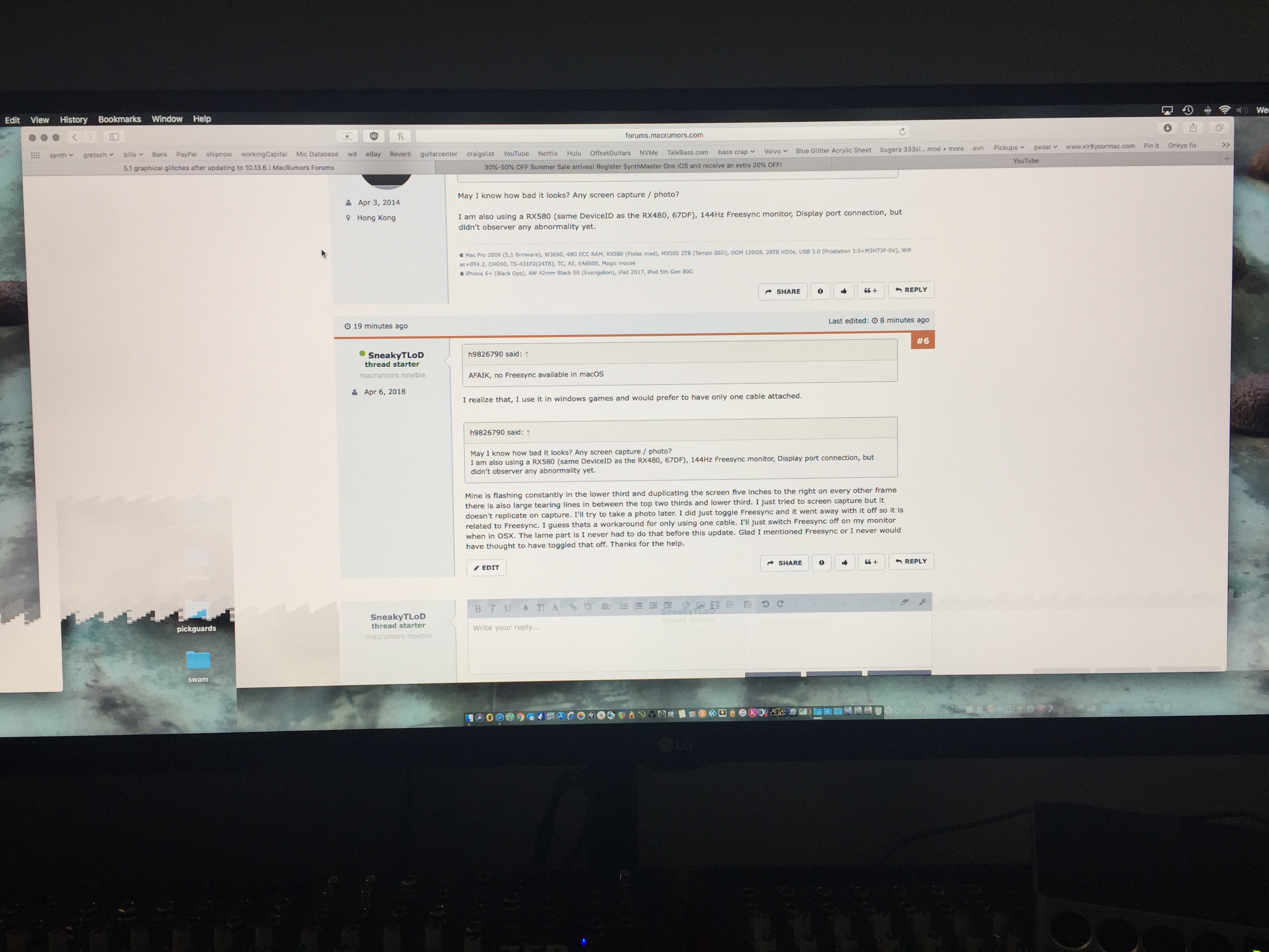

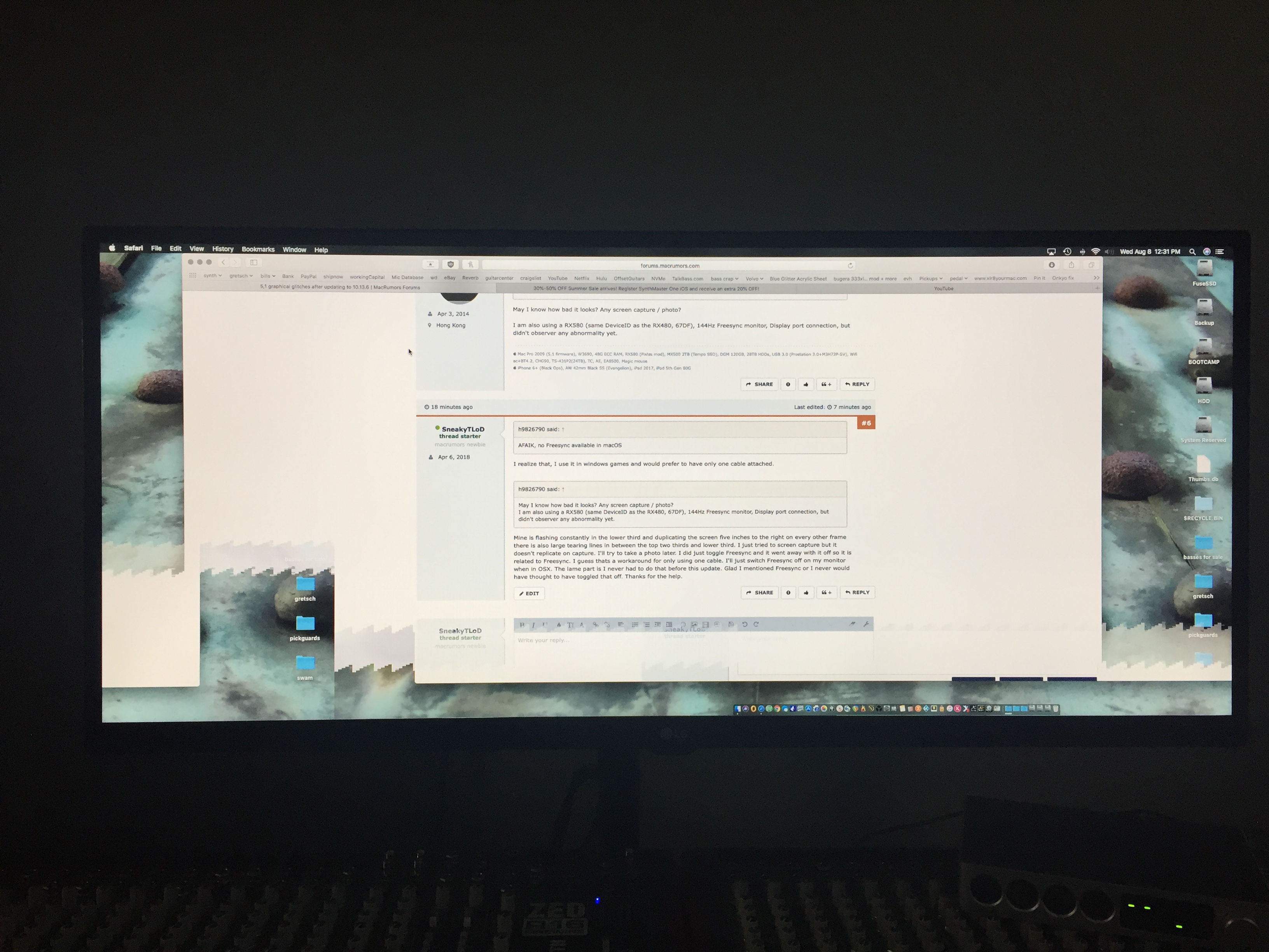

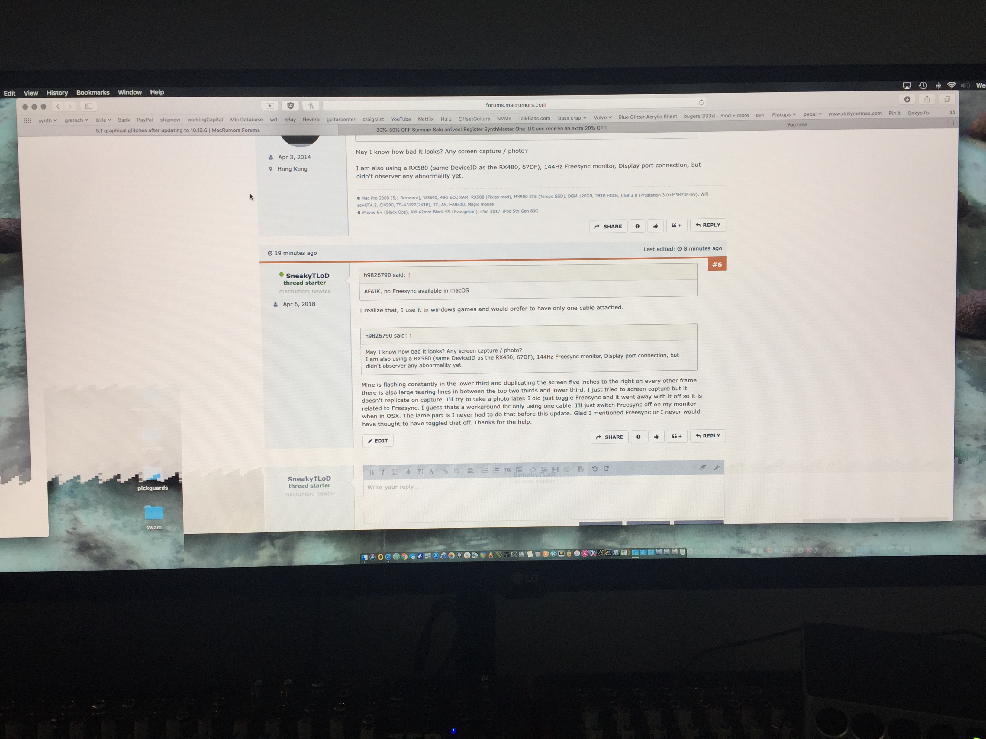

Mine is flashing constantly in the lower third and duplicating the screen five inches to the right on every other frame there is also large tearing lines in between the top two thirds and lower third. I just tried to screen capture but it doesn't replicate on capture. I'll try to take a photo later. I did just toggle Freesync and it went away with it off so it is related to Freesync. I guess thats a workaround for only using one cable. I'll just switch Freesync off on my monitor when in OSX. The lame part is I never had to do that before this update. Glad I mentioned Freesync or I never would have thought to have toggled that off. Thanks for the help.
According to another forum with a similar report, this MIGHT be related to attempts at enabling Freesync compatibility on officially supported cards in latest macOS releases. Guessing RX 5XX series does not have these issues?
Here are some pics.

Edges seems rough

Here are some pics.View attachment 775049View attachment 775050

This looks really bad. But if the bug only exist in 10.13.6, then obviously it's the driver. Not much can do except wait the next update, or recovery from backup.
This is the nice part when I was still use the 1080Ti, if the current driver is bad, I can roll bad to some older good driver. But for AMD GPU (in macOS), no choice.
Anyway, I tried all FreeSync setting on my monitor (CHG90), both Standard Engine and Ultimate Engine has no problem.
Edges seems rough
Sorry, can't see what's wrong on my monitor. Looks pretty normal to me.
This is the capture from my Mac, do you think the edge is rough?
If yes, then I think it's either your expectation is too high, or the monitor you are using causing the issue, but not really the driver or GPU problem.
No, seems fine. It is the notification icon that looks terrible.

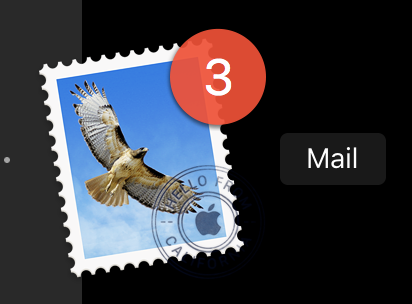

I've been noticing this too, mostly on text, there seems to be a lot of aliasing going on around edges. If I step over to HMDI it's picture perfect. I've ordered some new cables, mine have seen a few miles, to see if better/newer connections might remedy the situation. Will also try pushed the cables 'from the bottom up' as @yuzgen suggests.

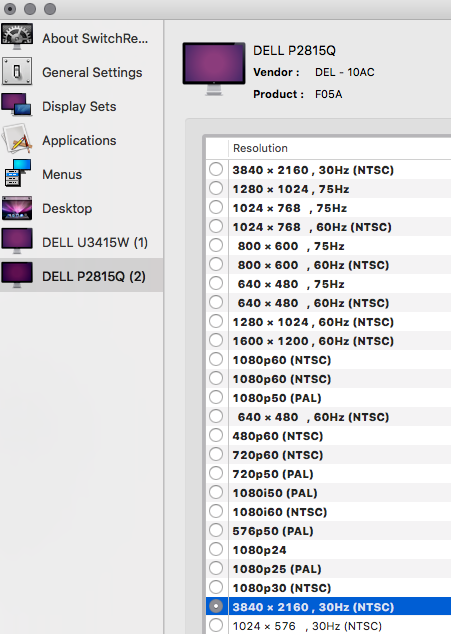

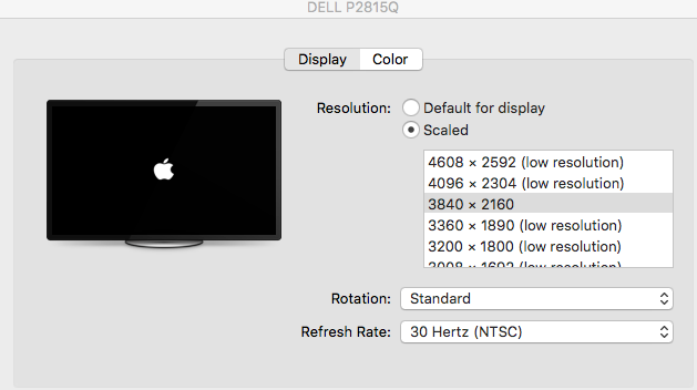

Hmm using the DP I can't get the 4k monitor to start up with a picture. In SwitchRes, I show two 30hz 4K options. It defaults to the top one. If I select the top one, I get no picture on the monitor. If I select the bottom I get a picture, but it won't use that by default. Any pointers anyone?
[doublepost=1534203185][/doublepost]Ok, I found out what the difference between those two is, OSX is treating the second that works as a "scaled" resolution. If I pick "default for monitor" I lose my picture. If I pick that resolution under scaled, it works fine, even though it's the same resolution?
[doublepost=1534203621][/doublepost]OK, seems to be a Dell problem actually. I went into the OSD menu and disabled DisplayPort 1.2 under Display Settings and now it works. Wonder if this Del P2815Q has some DP1.2 issues....

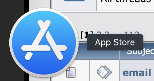

New cables arrived, however they didn't resolve my aliasing problem. They are however clearly better cables than prior as I can now set my monitor to DisplayPort 1.2 without the image cutting out and glitching...so at least there's that.
Pretty sure it's the drivers in macOS as in Windows the image is as clear as a bell.
