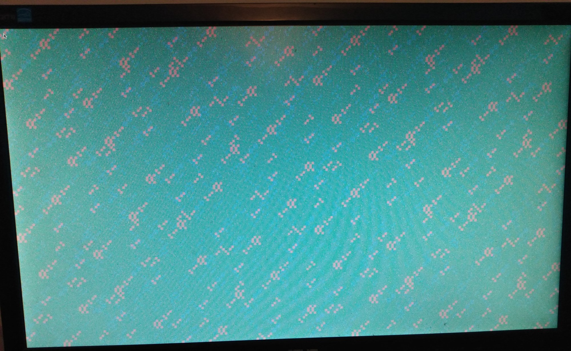

After a crash, I haven't been able to boot my computer. When turning it on, first I get black, and after a long time, it goes to a screen with patterns. See photo below. Any help would be appreciated. OSX Mojave. Thank you!
This is a perfect example of defective VRAM, replace the GPU.
As always, you were right. I took the gpu to a shop and it's the culprit. They revealed that the gpu had been modified to be a Mac gpu, since this is a PC gpu originally. The question now is, would a replacement that has not been modified work out of the box anyway? Thanks for all your help!

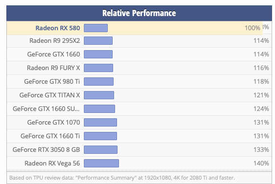

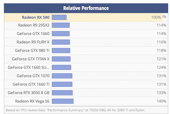

Do you think that's better than the RX 580?
https://www.techpowerup.com/gpu-specs/radeon-rx-580.c2938 vs https://www.techpowerup.com/gpu-specs/radeon-rx-vega-56.c2993
~40% faster 3D/render/raster wise, while double or more the performance for video compression/decompressions/colour grading and with very similar power draw as a RX 580 factory overclocked.
It's a solid card for Mojave, but if you do not use apps that require a GPU, you will not notice all the performance gains over a RX 580.
The VEGA 56 models with the blower type of fan, the AMD reference model, are very sought after even to this day.
